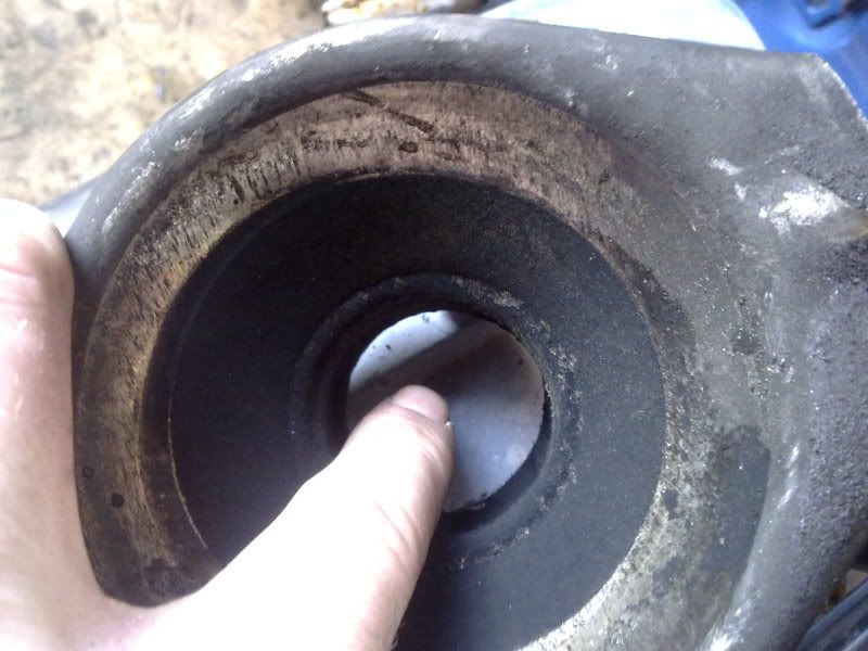

just taking the back box off won't make much of difference (apart from noise), it's not just the decat and silencers that restrict the flow of the exhaust, the standard diameter of the pipe is just as restrictive. i fitted a straight through side exit on to my scirocco td that was just made out of the standard system and it did very little performance wise, i've made another side exit for my jetta thats 3" from the turbo all the way out the side (running the same kind of 1.6 td) and it's made a massive difference. with the old system i couldn't get more than about 18 psi, with the new one i can max out a 30psi gauge
this is the standard exhaust diamiter for my car
and this is the new one
and to the comment made about more air meaning more power isn't true, if you just wound the boost up to 30psi you wouldn't get any difference other than less smoke and lower EGT's. it's more fuel that improves the performance, more boost allows you to burn more fuel but more boost on it's own will do nothing.

but agreed about just back box removal, the cat is a far more restrictive point in the system than the box/silencer, probably followed by pipe diameter, then box.

you wouldn't see an increase in standard boost levels with a bigger pipe because your actuator would still be keeping the boost to standard levels, but if you wanted to wind the boost right up a larger exhaust is essential, trying to get more boost through a standard system is like trying to blow as hard as you can through a strew
