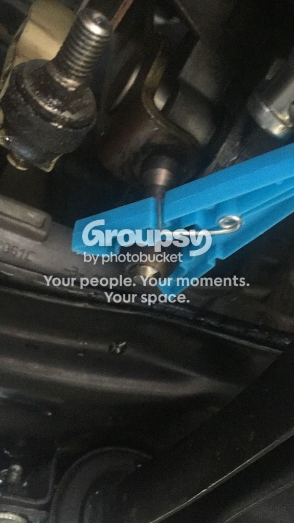

Bad news. Today going back to home, in a climb I had to reduce to 4th (I was going at about 90Kmh) and white smoke entered inside the car :(
It was the clutch.
I reduced the gear as usual, gently with rev matching. It feels really bad.
The car still goes well, only if I need to accelerate faster the revs increase but the speed doesn't same when going at 90-95Kmh.
I asked how much the repair would cost - 350€ at black market workshop (LOL THEY MUST BE CRAZY if the clutch costs 100-120€) and 550€ at a good workshop. I can't afford that !
Now looking for Youtube manuals and necessary tools huh.

Got the gearbox and clutch down in 4 hours (not hard work, just taking my time - what is a mechanic without a beer? a couple of beers per hour*)
As you can see there is a missing part, I will show you what happened to this bad boy.
So seeing the state of this part (I don't know how it's called even in my native language) we can conclude that it was almost-broken long time ago and the bearing was not fitting straight when the clutch is pressed.
The moment when my clutch went I think was because the bearing couldn't go back because of this piece wasn't sitting well in its place. At this point I am not sure if my explanation is accurate.
Seeing this image makes me angry a little bit ha ha !

That is the worst I've seen for the guide sleeve, it is good practice to replace it whenever you replace the clutch as they normally just wear ridges into the sleeve and this can cause a notchy feel to the clutch pedal, here's a link to the part number https://volkswagen.7zap.com/en/rdw/polo+derby+vento-ind/po/1997-158/1/141-141010/#7
