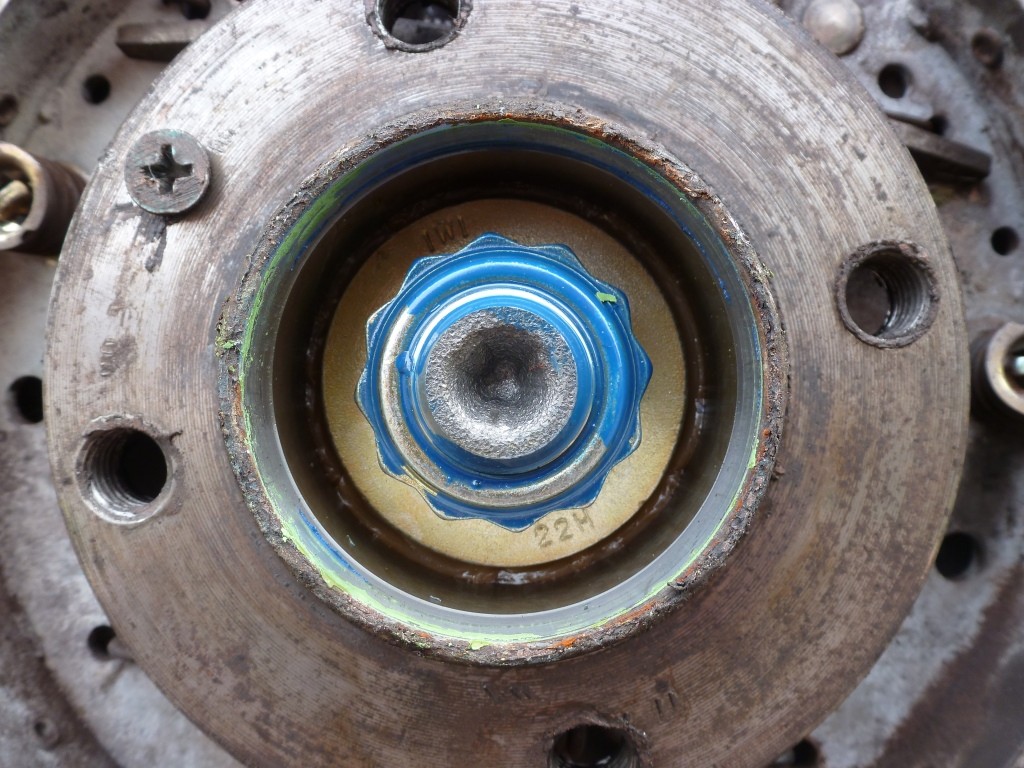

The rear brakes on my V reg Polo recieved an advisory "would benefit from a service"). Made a start on them today, but found that they are different to the ones in the Haynes manual, in that having removed the drum, the flange on the hub is preventing removal of the brake shoes.
  • Does the hub have to be removed to change the shoes?
  • What size socket do I need?  - nut is marked 22H
  • Should I replace the hub nuts?
  • What is the hub nut torque?
Many thanks.
