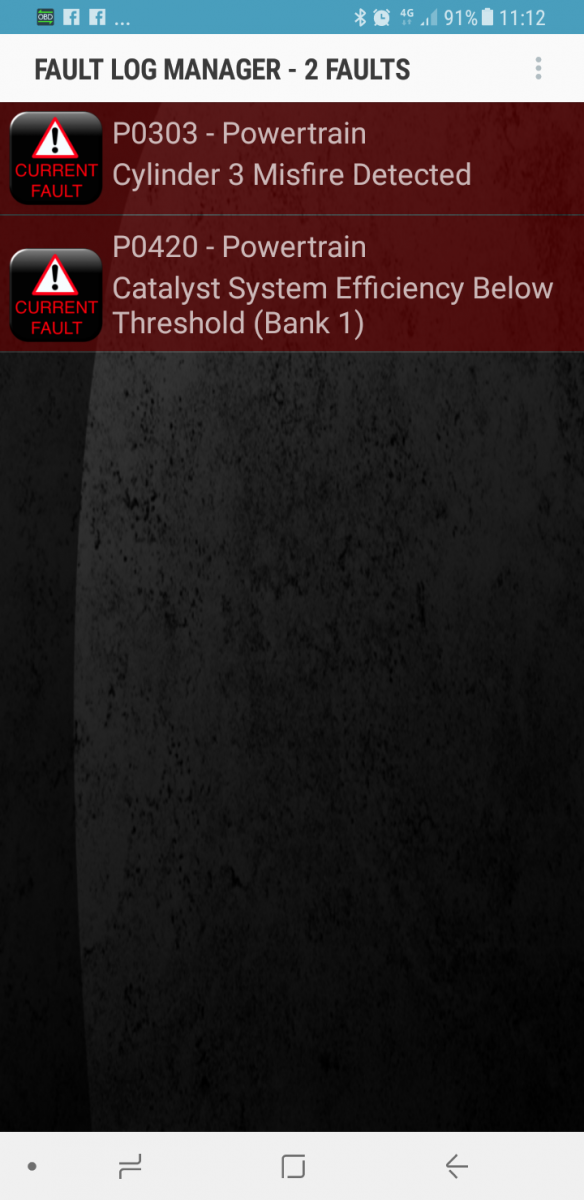

I have attached a copy of the most recent obd2 fault code scan

just_jack2018
okay just checked the mechanic who did the head work and top end rebuild did a compression check and it was fine, it's done 800 miles since the top end rebuild
