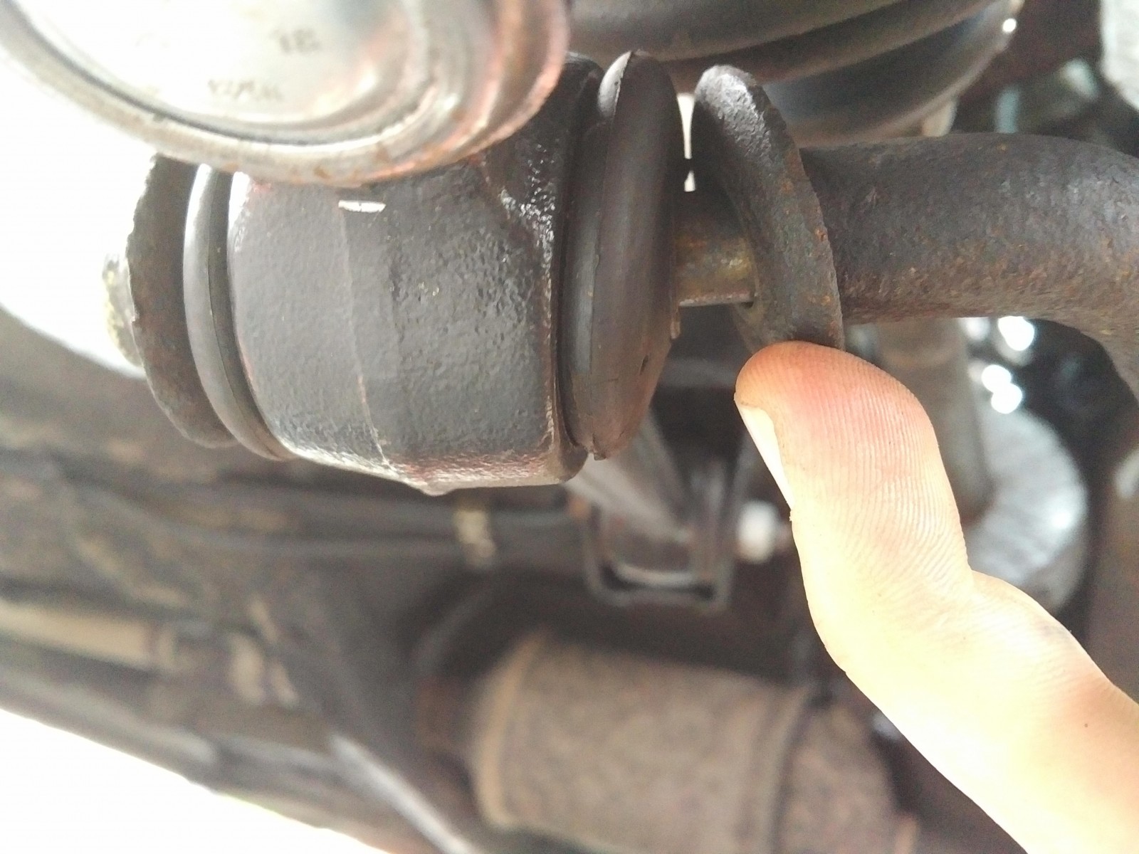

zob
Well if this isn't the cause I don't know what is.... slightly frightening
The 'lock' nut at the end of the ARB had vibrated loose - makes sense that the skating motion would come from a rather variable castor angle...

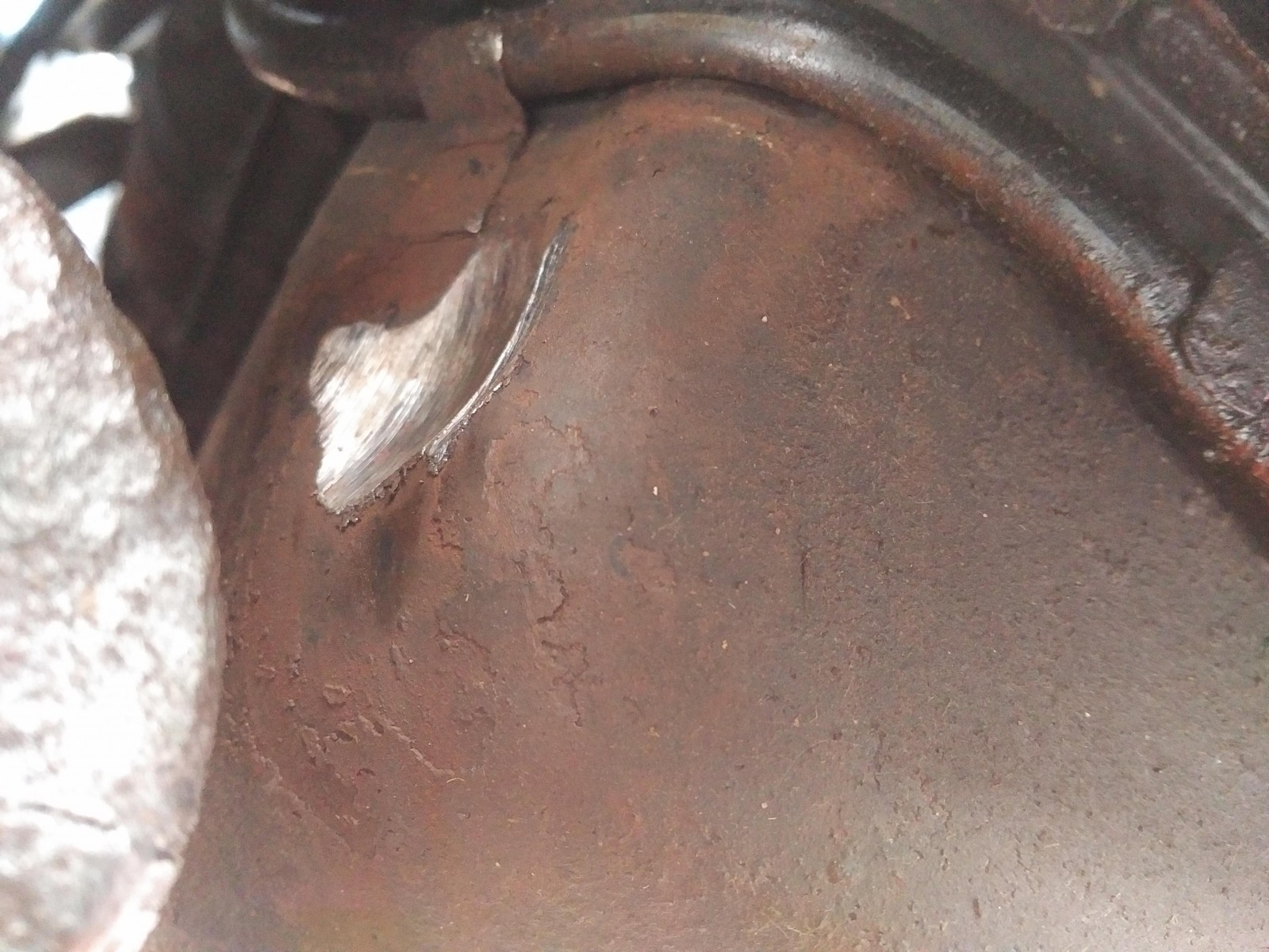

And the clunk was a combination of the ARB wobbling around in the TCA and this.....IMG_20190617_1127058.thumb.jpg.26bf2bfccfe8b5204e33f3422c1aca01.jpg
The counterweight on the OS driveshaft has given my sump a good whack. Is this sump going to need replacing? Hard to tell whether the scuff is a removal of material or a caving of it in...
Going to order some new locknuts for the ARB. It was definitely done up to 75Nm - shouldn't have failed so catastrophically. Thank god I caught it!

dvderlm
Ouch.
Original nuts reused on end of ARB?
Do you trust your torque wrench?
Looks like dent and scrape, but not much material lost.
Sump is not leaking at that point, but probably worth reinforcing with filler and painting over to stop rust from outside.

zob
28 minutes ago, dvderlm said:
Ouch.
Yeah - re-used the nuts. The other side is still at torque, lord knows what happened here. Ordered a couple new OEM locknuts for peace of mind.
Well I thought I trusted it! Its a Draper and had it for yonks. Could probably do with checking that.
Isn't the sump made of Alu? I'll fill it in and give it a paint anyways.

zob
3 minutes ago, dvderlm said:
Sorry to disappoint you. Sheet steel at £25 ish.
Feld Motorsport sell an alu sump for €240 ish.
https://www.feld-motorsport.de/files/CLASSIC-LINE-ANGEBOTSLISTE-PDF.pdf
Ha! Consider me disappointed! I'll have to get on giving that a lick of paint asap. Either that or just swap for a new sump when I next do the oil (which is pretty soon anyways).
