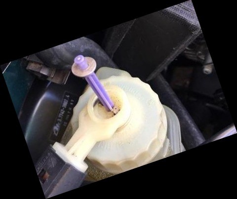

Is there something wrong with this. The blue is a float goes up and down. When washer touches the metal contacts the brake warning light (handbrake light) comes on.
But there is very minute gaps around the plunger, wont air get introduceed? been driving like this for ten years, was fine before doing the rear disc conversion

That reservoir is above the master cylinder so no air will enter unless the fluid level becomes very low or you drive upside down and brake.
Wall of death rider I talked to once said the brakes were the most dangerous things on the Indian Scout motorbike. so they remove them.
