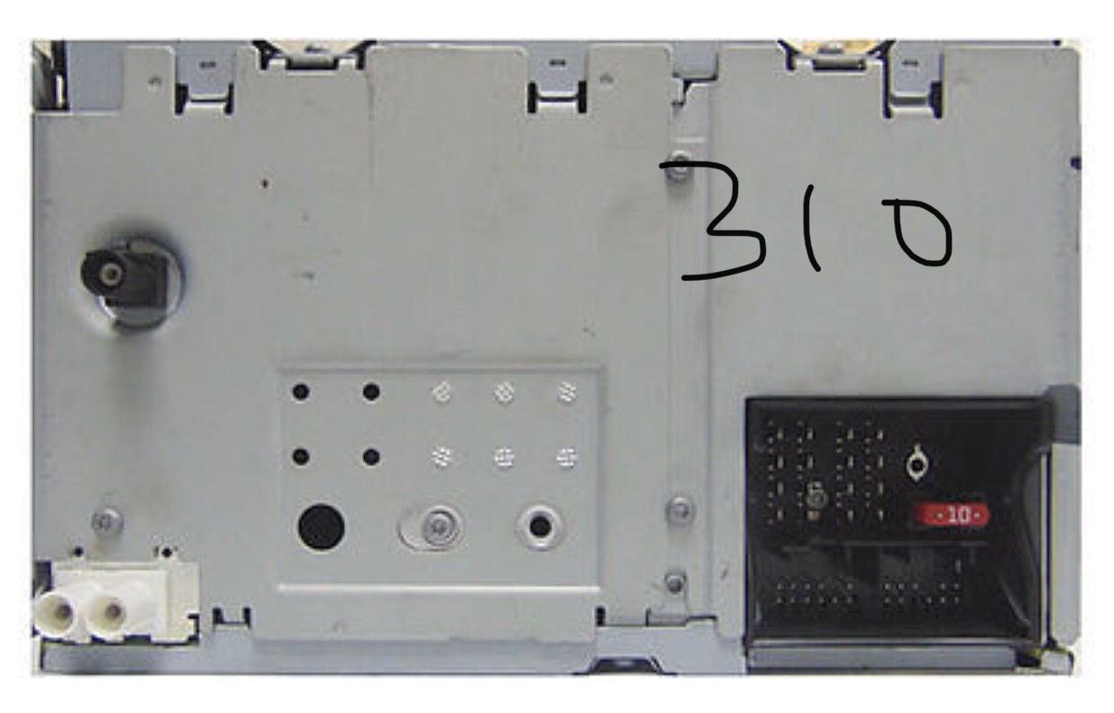

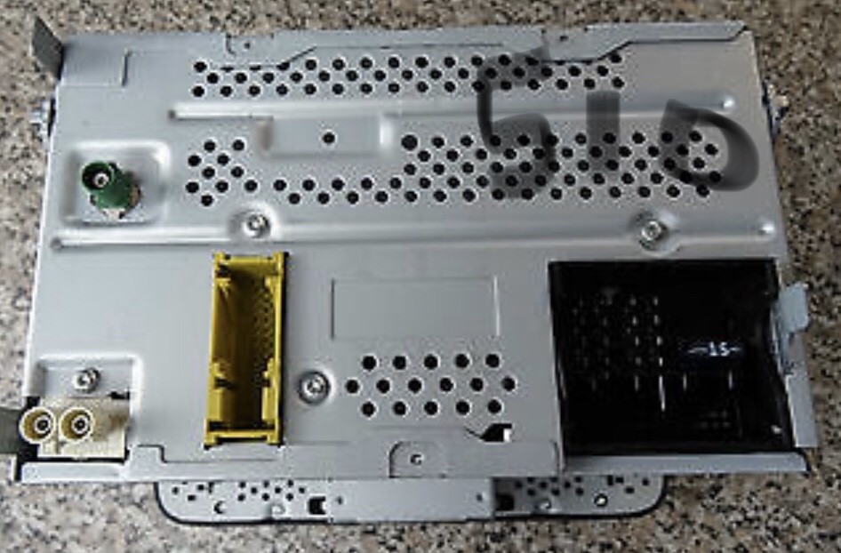

That seems a lot less bother, I’ll see if I can source a 510 DAB to replace it, (does it come in an Apple CarPlay version)? Also, there is a yellow socket in the 510 that the 310 doesn’t have, what is this used for, any idea?

nige8021
In the workshop manual it shows that additional yellow connector and what the pin contacts are for (mainly video) but in the wiring diagrams there is no mention of that connector, so it might be used on another VW model

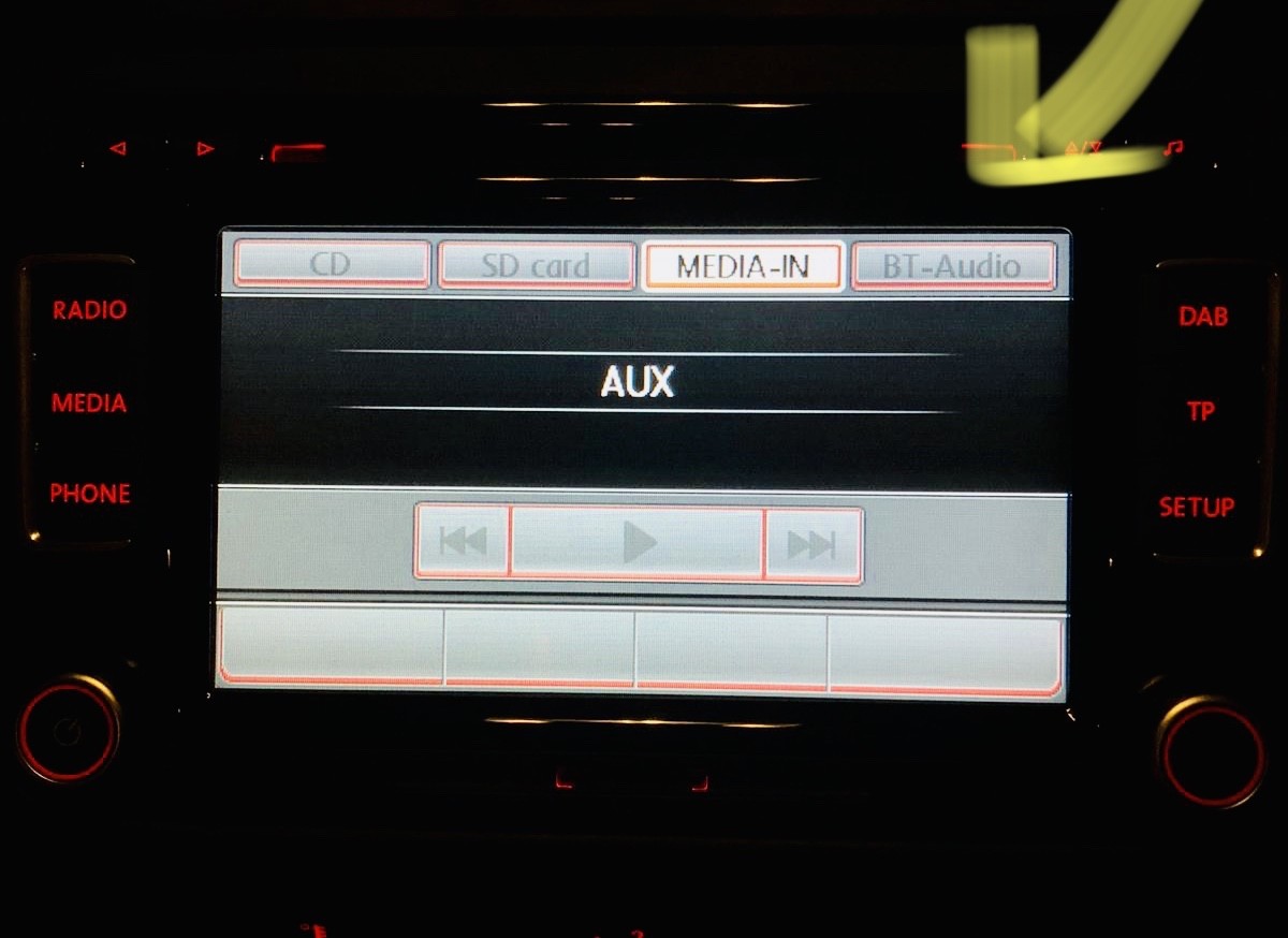

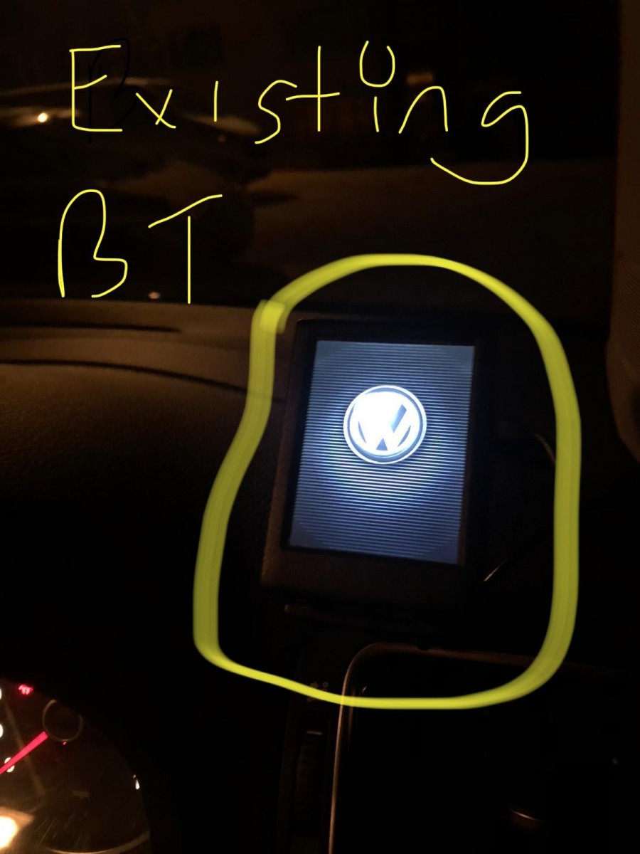

I have fitted the RCD510, works fab, but there is no Bluetooth showing up. My Son has the little Bluetooth display unit in it already, so I’m guessing that has something to do with it, image below.
any advice on how to activate the RCD510 Bluetooth please, images below dhow what I mean.
thanks in advance [again] :0)

nige8021
Is there anything in the setup section bottom button right side ? or it might be something that needs coding in with VCDS ?  I don't have the radio manual to be able to give a definite answer

nige8021
I've had a search and there is a mention of having an additional unit for the Bluetooth ?
Share this post
Link to post
Share on other sites
Bar_Ry
Yes,
It already has a hands-free Bluetooth system installed, I suspect it needs changing to work with the radio rather than the separate system.
I spoke to the seller, and he said he used the Bluetooth with a parrot system, which he is going to send me, but I’ll get someone at VW to take a look before I fit it
