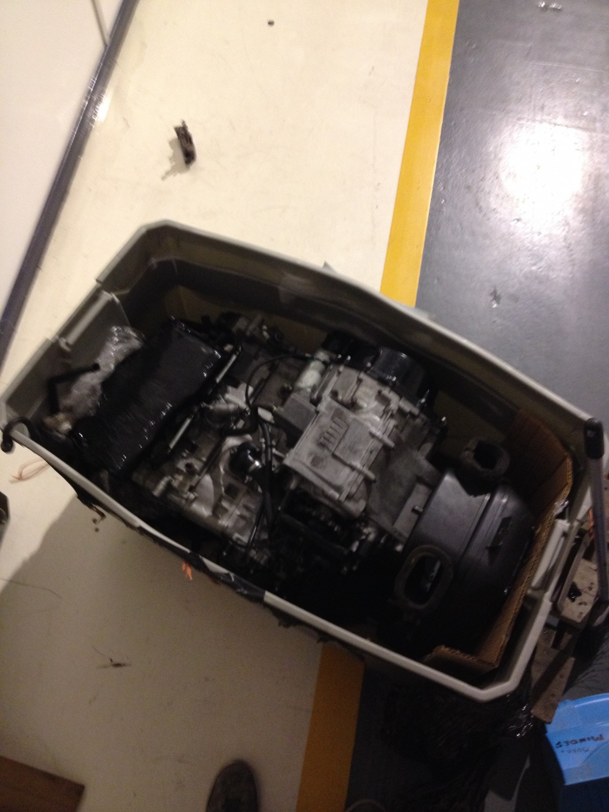

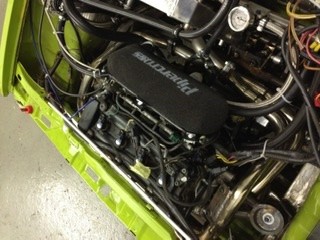

Sunbeamlotus
Hayabusa engine and loom

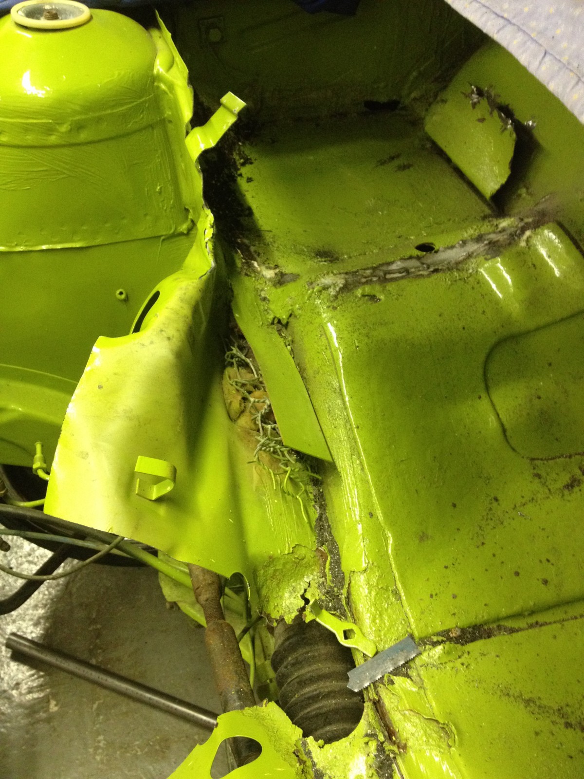

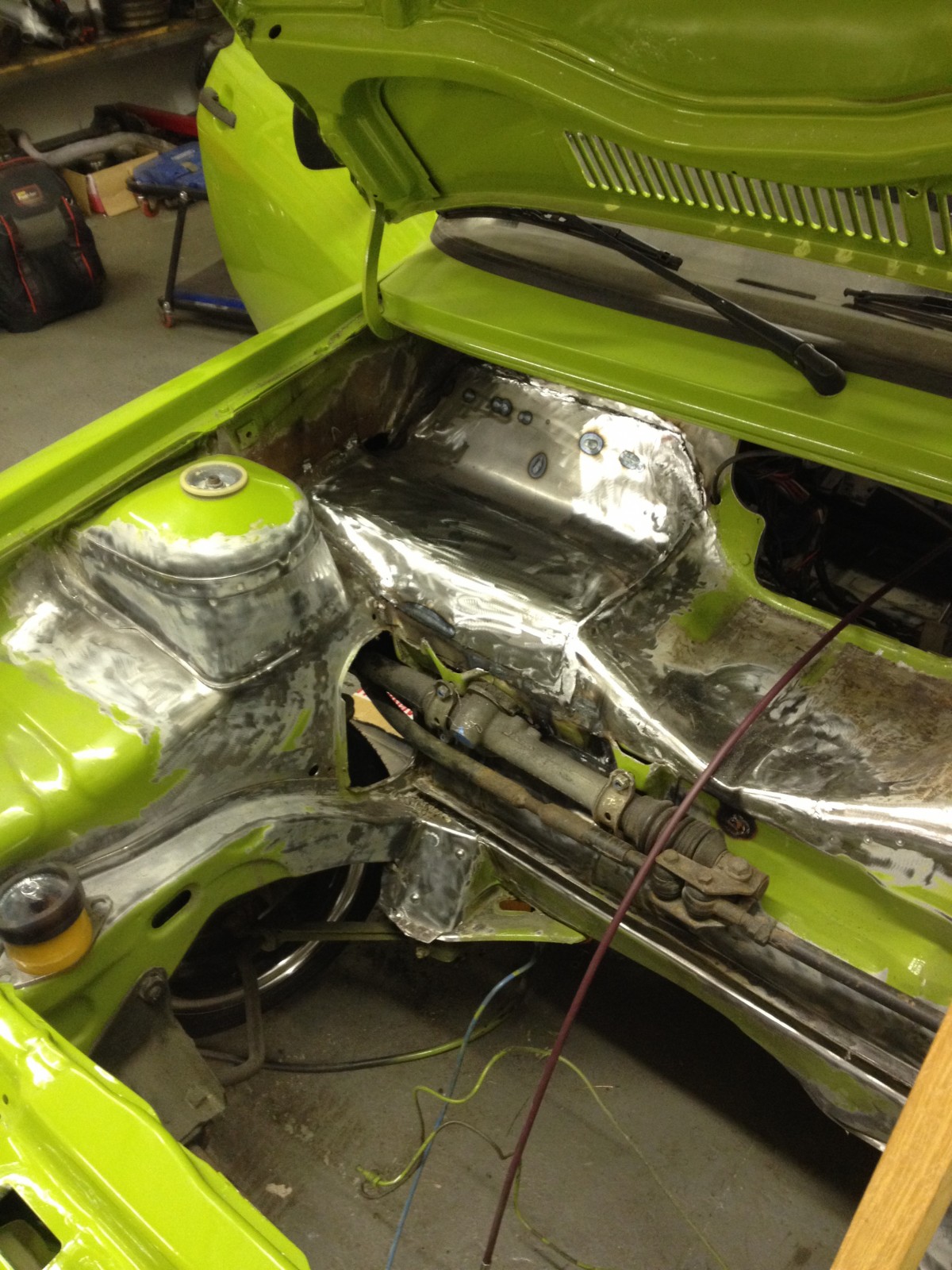

Sunbeamlotus
New bulkhead and stitched front end
  • Like 1
Share this post
Link to post
Share on other sites

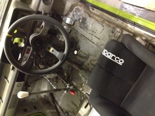

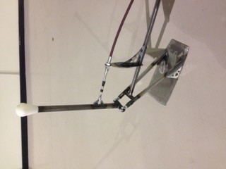

Sunbeamlotus
Shifter
Share this post
Link to post

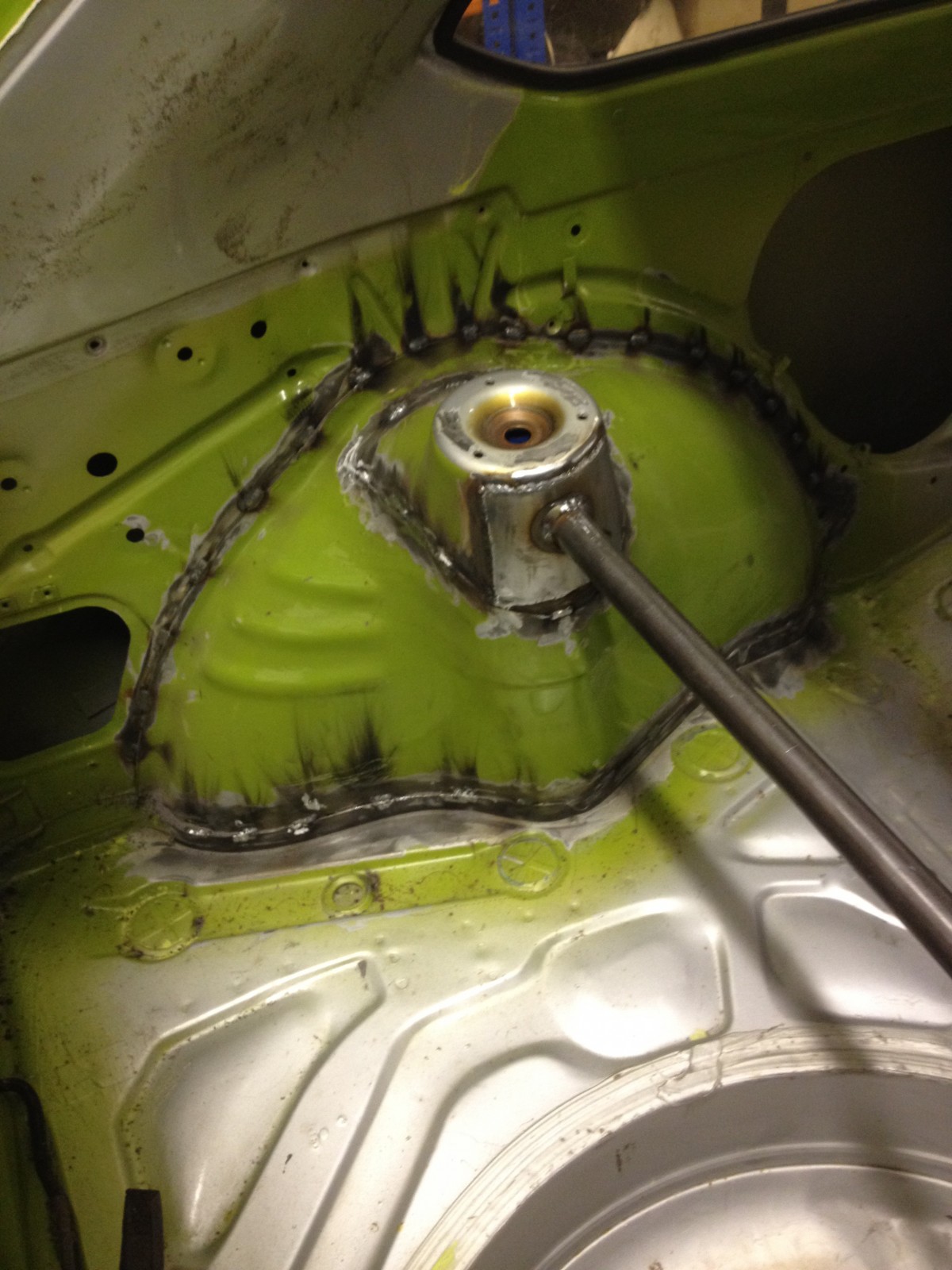

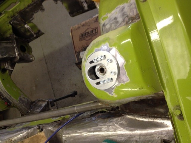

Sunbeamlotus

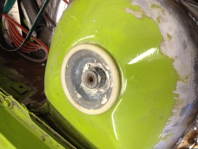

Top mount mod
now  golf
Share this post
Link to post

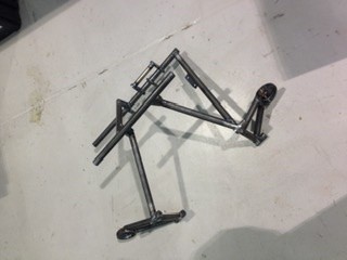

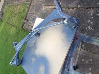

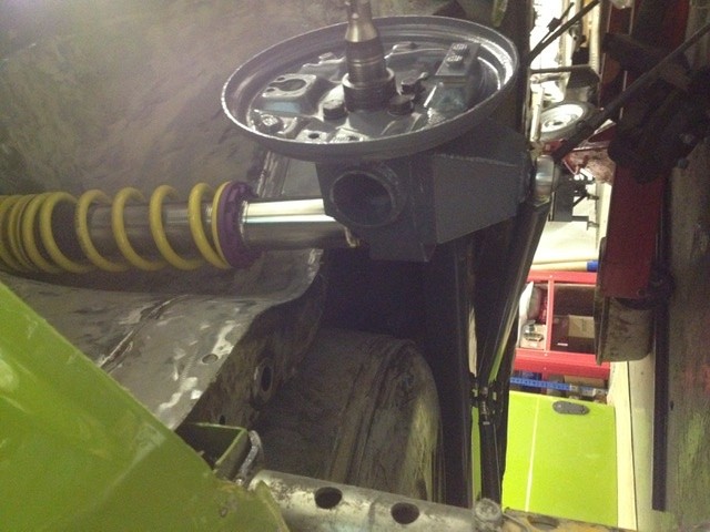

Sunbeamlotus
New coil overs most of the suspension is hand made around mk1 gold components
Share this post
Link to post

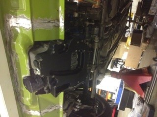

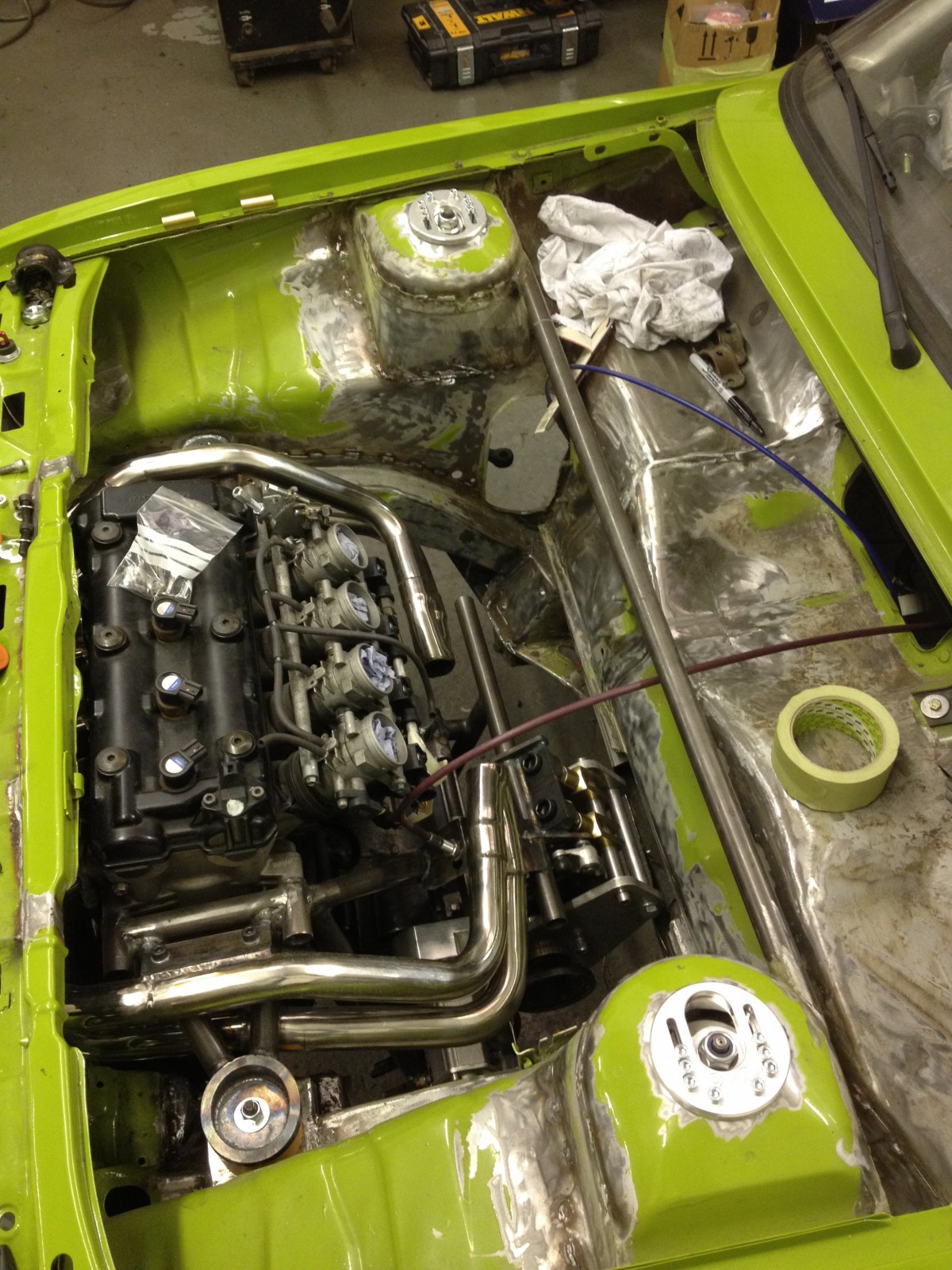

Sunbeamlotus
The hayabusa is a big lump and just about fits
Share this post

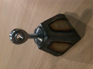

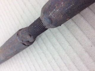

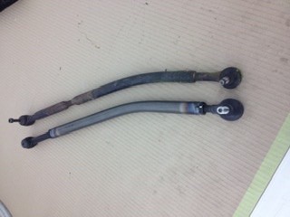

Sunbeamlotus
New steering arms made in t45 thin wall and en24 plugs all tig welded up....... just look at the welding on the old one  !

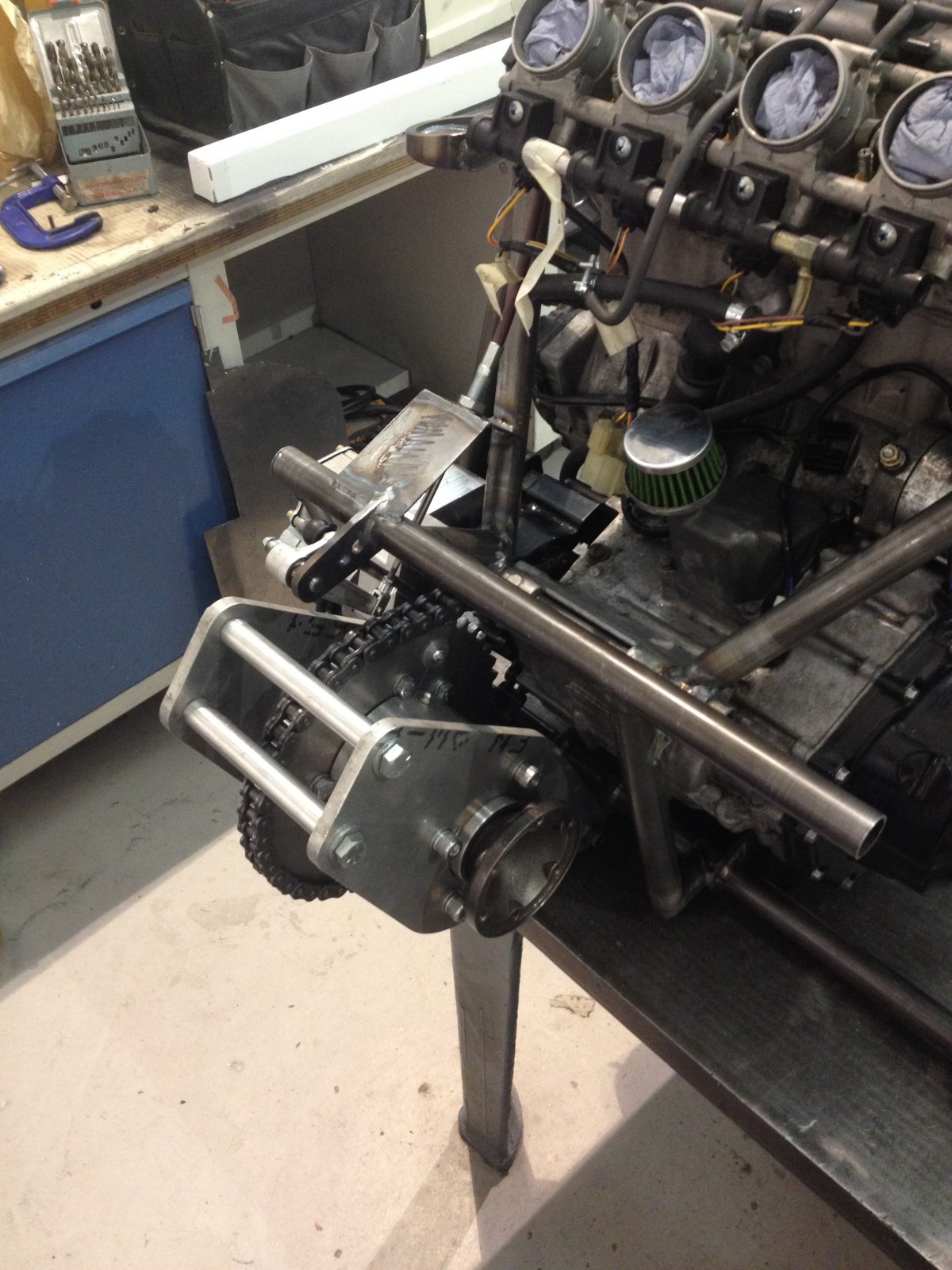

Sunbeamlotus
Engine mounting !
this will mount a hayabusa engine into any mk1 mk2 polo sits on mk2 escort mounts again t45 thin wall and en24 plugs

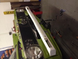

Sunbeamlotus
Grp bumpers

setch
very neat. how are you mounting the rad? it doesn't look like she is giving you much room to play with. Any pics of the diff setup?

Sunbeamlotus
Ford LSD mk2 shafts cut to length all custom made with DID chain from a drag bike.

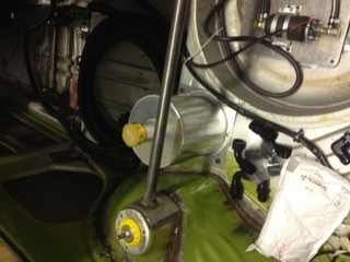

Sunbeamlotus
Dry sump

dvderlm
Getting better and better. I was wondering how the gearbox to driveshafts was going to work.
Dry sumped  - for slalom, hillclimb?

setch
bikes tend to have a very deep sump as they need to be narrow. Prob wouldn't fit height wise as standard. Old SAE favorite fiesta RS diff then? looking good

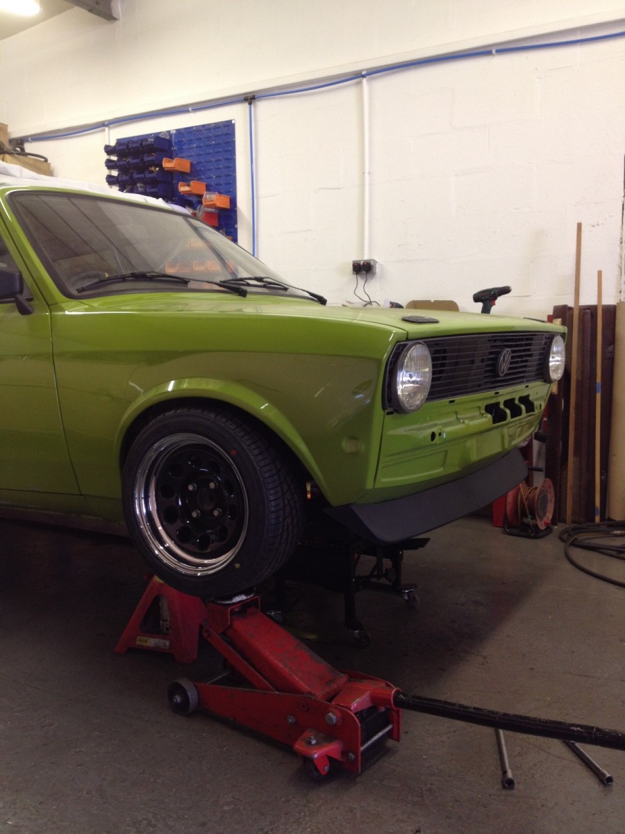

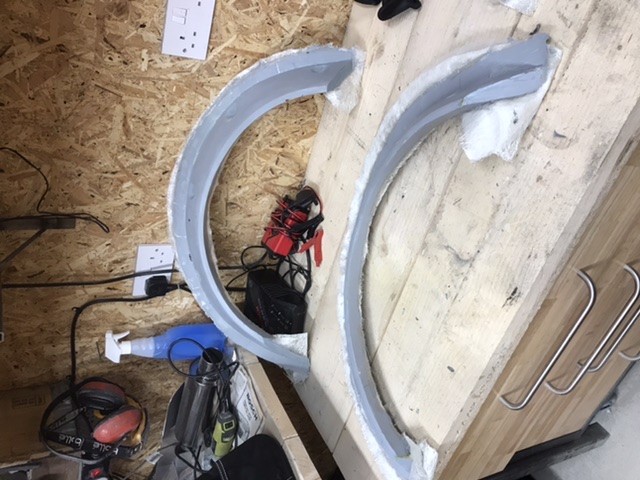

Sunbeamlotus
Home made grp arch kit made from my own pattern parts
Share this post
Link to post

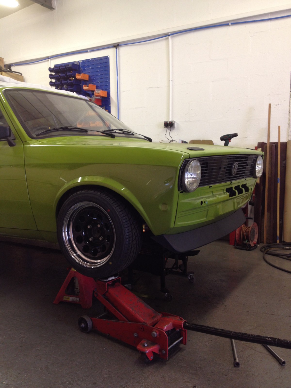

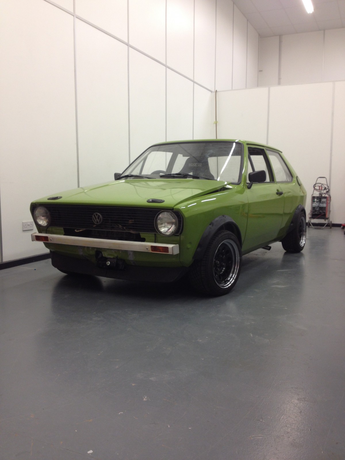

Sunbeamlotus
Car up and running
Share this post
Link to post

Sunbeamlotus
Yep ...... I changed the colour so I could find it in a carpark
its been out out a few times .... even shopping in Lidl
