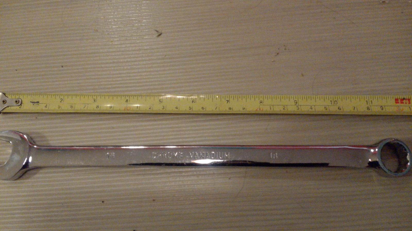

24 hours of WD40 soak. Borrowed a combi spanner (ring and open 18mm) about 8  inches long.
No joy.
Pushed up strut with a jack to force cone tightly in and perhaps release pressure on the nut.
No joy.
Tried a 10inch long  adjustable spanner set to 18mm.
No joy.
Put a piece of pipe over the spanner for more leverage, and still no movement, except spanner slipping off.
Tried to get some rotation hitting the nut with a tyre lever and piece of wood, this broke off one of the sticky-up battlements.

Micrometer looks like 18mm, but I didn't jack up the car so measurement was taken by feeling for the nut... and I might have squeezed it removing from under car.
Borrowed a foot long 18mm ring/open combi spanner.  Haynes spec says the nut is torqued 98Nm and can be tightened a further 60Nm to let the clip slide into its hole.

@steveo3002 I already used a 2ft long pipe on the borrowed 8inch spanner, but it wasn't ever sat very securely on the nut twisting in the pipe.
Wondering if a chisel with its  tip in the clip hole and a lump hammer would get me anywhere, but the clip hole is towards back of car, so not on the best side to swing a hammer.
