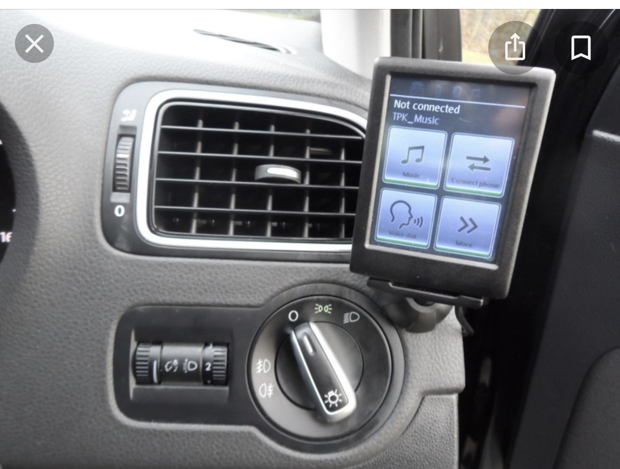

I was thinking maybe I could remove the hands free kit and just use the BT module under the seat?
The previous owner sent me a parrot kit that he’d been using with it, but it’s a mass of wires & plugs, and some wires are broken, so no idea where to start there!
