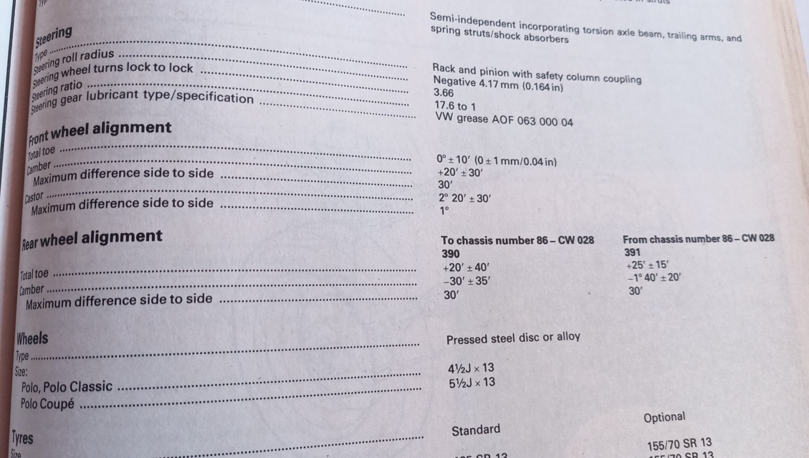

I just started noticing on my '84  breadvan that it has some negative camber at the rears. It's more obvious now I have gone back to original width tyres.
Was this factory standard? Wear? Anything else?

According to the Haynes book (so it's probably wrong) :paranoid:, they're supposed to have no camber, but they all seem to have a bit, and it seems to look even. Like you say, you see it a lot more with skinny tyres on.

dvderlm
Which Haynes? My Book of Lies says
-30' +- 35' up to chassis number 86C W028390
and
-1°40 +-20' for 86C W028391 onwardsIMG_20200624_201529_8.thumb.jpg.7e93c8695dcddc0bb10ef8edd5e13215.jpg

though I think Haynes went for long pub lunch while writing Chapter 12
http://www.mez.co.uk/haynes.html
