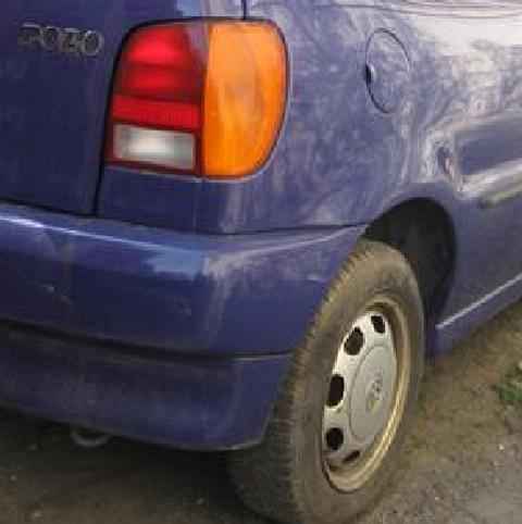

Love the bumpers, always wanted to seen 6n2 ones on a 6n :)
6n2 bumper on a 6n... do they fit or do they need modding at all ???
I wanted to do this few weeks ago...but after you'll see the pics, u will understand why is not possible to fit 6n2 rear bumbper on a 6n1...the only thing that fits is the tailgate, wich i allready bought from spares.After the mounting i'll show you some pics, but first of all i had to paint it...
My question is what did you use to fill the rear wiper hole ???...i want to get rid of this wiper but i don't know what to use to fill the gap...
Thanks man, and nice car indeed!Cheers!

Thanks, but it's not MY car, it belongs to a good friend of mine, who isn't that well-equiped with English ;)
That wiper, is a acryllic glass plate, shaped for the mk4 rear window, in exactly the same colour, that's glue over the wiperhole to cover it up. We from VW Polo Club Holland sell them.

I wonder how hard was to transform that 6N2 bumper for 6N1..some pics will help us alot...was a very brilliant idea to do that.I still want to change my real bumper with a 6N2 one...

Not that hard, just requires some plastic-welding skills. Don't think I have any more pictures of the process though, sorry :(
Just take the top part of a mk4 bumper, bottom of a mk5 bumper, cut both horizontally and weld them together, that's the entire thing in a nutshell ;)

I think the top part from an 6n1 was very thin piece to fit the arch, and very difficult to cut, alot of measurements i guess...what tool they used to cut the bumper?
