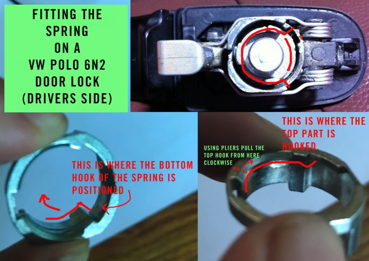

I recently did this job and this is where I hooked the dreaded spring.
The lock springs back to vertical position when you lock or unlock the doors.
So as it functions correctly I believe this is correct.
Make sure you have the long paddle kit (58mm long) for a 6N2 polo and not the short paddle.
Hope my image I have created helps !! Please share if it does!
