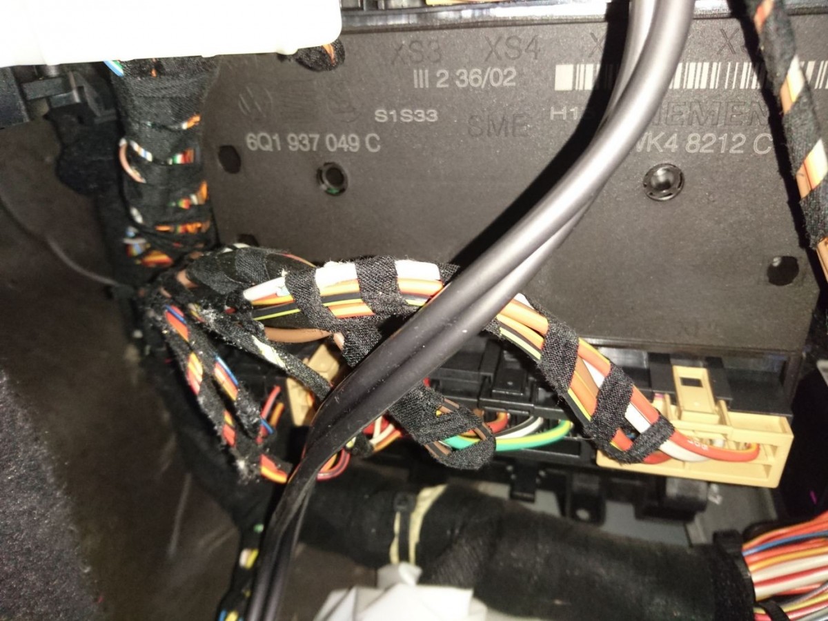

Redwan1996
Hi, I am new to this forum and this is my first post. I have a VW Polo 9N3 1.2 S 64 which comes with central locking. However I do not have remote central locking so I decided to purchase a comfort control module, model number 6Q0 959 433 E,which I believe can receive remote signals. However when I looked under my dash I noticed that I have a completely different module and have no idea on how to remove it. The current CCM module Model I have in my car is 6Q1 937 049 D. I have not seen any video tutorials or guides with my specific CCM model, but I have read numerous amounts of forums which say replacing the 9N3 CCM's are really easy to replace and that thhe model I purchased will fit right in. I do mot think this is the case for my car :(
How would I go about getting remote central locking? Thanks!

fairfield07@hotmail.co.uk
The part you are looking at in your car is not the part you need to swap. I had this exact same problem.
I just remember reading this thread and thought I would direct you to an answer someone gave me.
http://www.clubpolo.co.uk/forum/index.php?showtopic=343359&hl=
The pipe he is talking about is to the left of the steering wheel, and it has 1 screw which requires a 6 point bit to get out (not phillips).
Up behind it is a box, much smaller than the one you were looking at and has 1 plug going into it at the top.

Grazuncle
Hi..
I removed the heater ducting as described but still can't see where the CCU goes...
any pointers appreciated :)

Spanners77
Hi mate
brand new to this forum
that module you speak of goes in that black plastic cage right in your pic it slides backwards on a key way and comes out plugs enter from the top
it’s not the easiest job in the world it’ll make your back ache ?

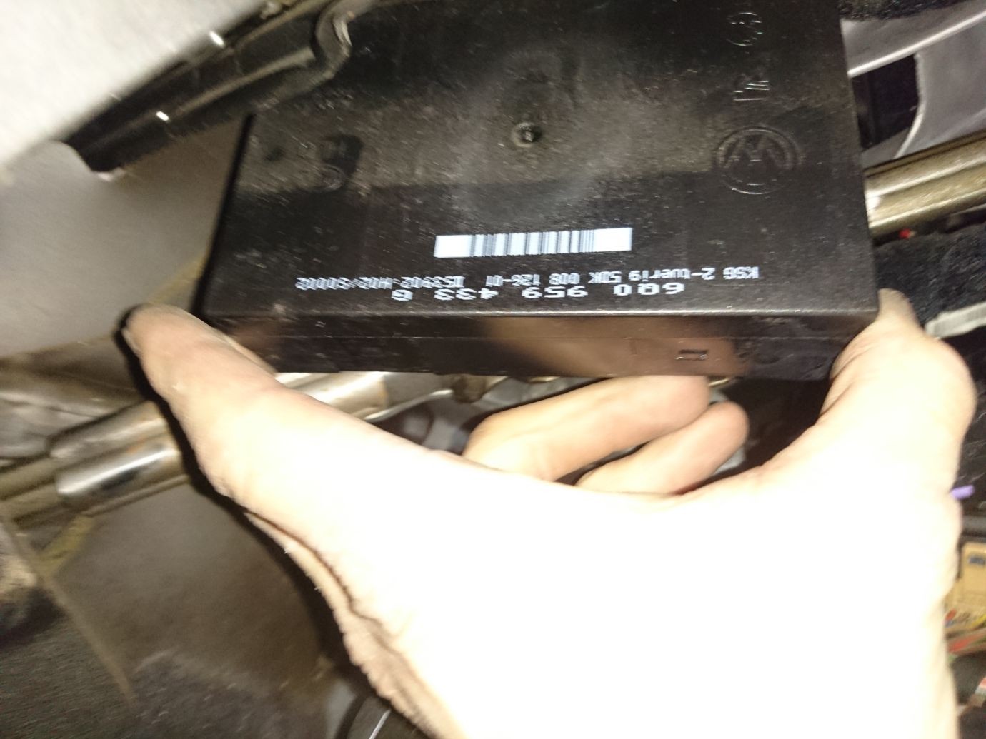

dennishunt100
hay im new here iv got a vw polo 1.4 tdi 3 door and i want to have a key fob to open the doors but dont know what ccm i sould get to fit my polo can some one help here some pictures of the one iv got codes are 6q0959433g
