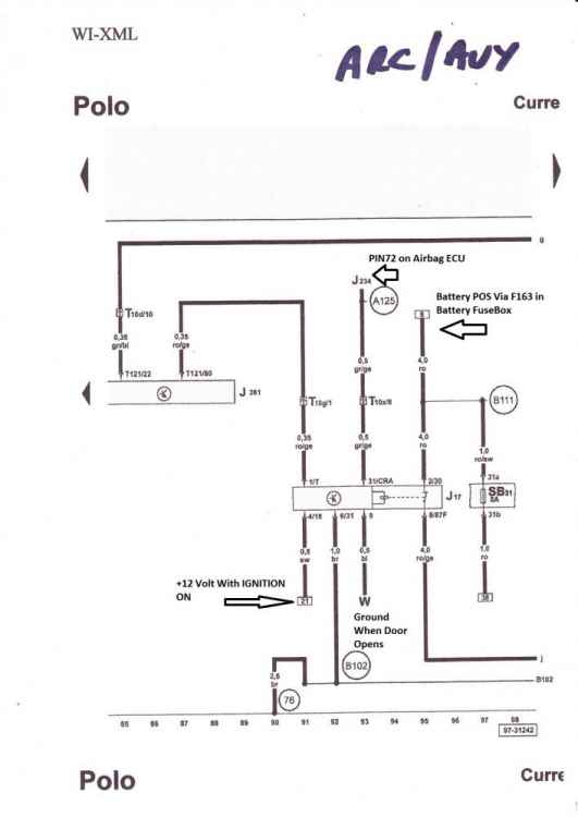

splod67
thanks for the diagrams. A problem is that photobucket has reduced the resolution to the point where I can barely read them. and the VW diagrams, from what I can tell don't really say whether an input like "Crash Input" or "Door" should be normally high or low, so it's hard to know the exact combination of inputs to the 410 that would let me test it. After a 150km round trip to a wrecker, I know that the 6N(1), Jetta, Golf and a few other VW models don't have a 410, or at least the ones I saw didn't. Next, same length trip after a phone call to see if a 6N2 I found after more web searching has it's 410.

nige8021
Here's an enlarged version of the pump control diagram
post-36925-0-09863800-1438525486_thumb.j
The only input to the relay I can't find a definite answer to is the signal from the airbag on pin 3 of the relay, I would make an assumption that it's a Positive 12v pulse?? as in the event of a crash it also signals all the doors to unlock and that requires a Positive pulse to the locking pump unit
The "Door open" signal is there to momentary energise the fuel pump to prime the fuel lines, so it makes starting quicker as there will be a good pressure in the injector fuel rail
