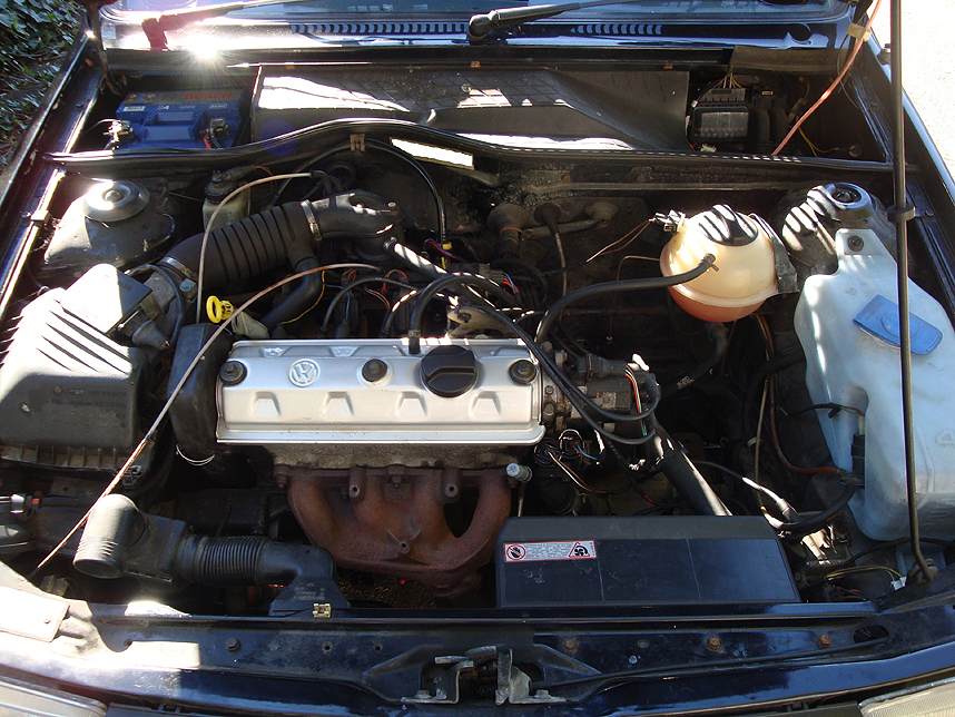

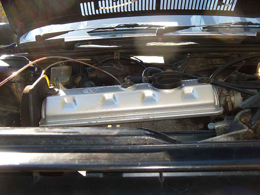

The car in question:
post-919454-0-12636800-1449620951_thumb.
Engine:
post-919454-0-54023700-1449621058_thumb.

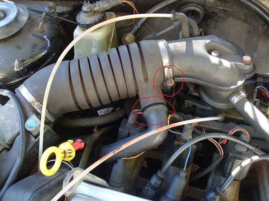

Undo the jubilee clip at the throttle body elbow and pull the side breather hose away:
post-919454-0-96710900-1449621220_thumb.

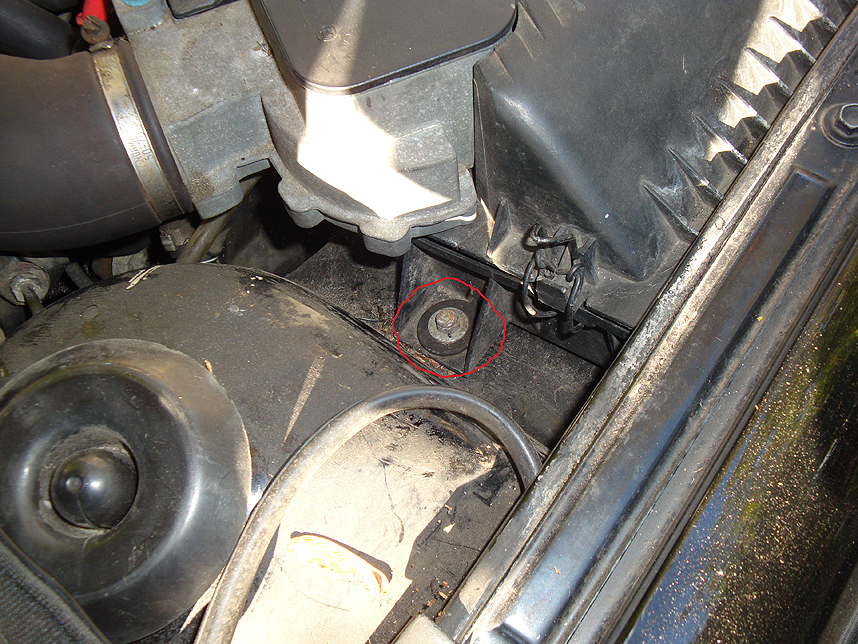

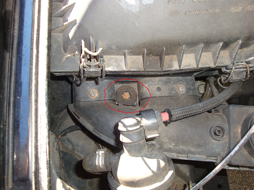

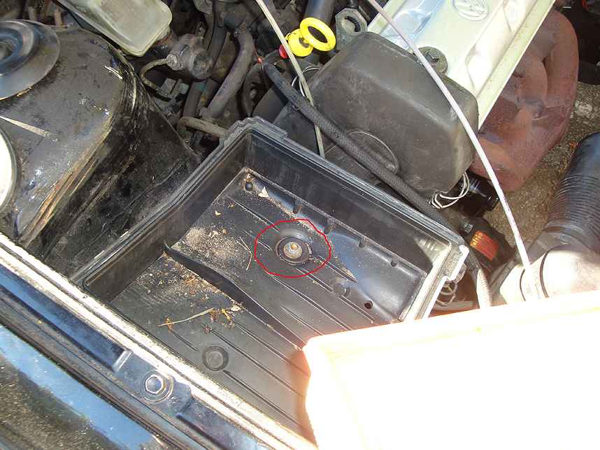

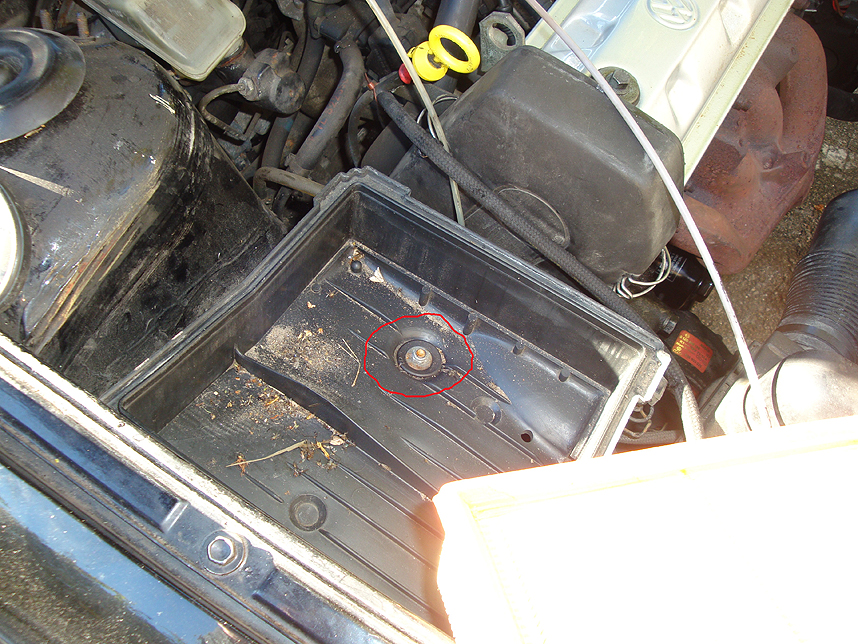

Remove the airbox upper half and filter element, and undo the three bolts securing the lower airbox:
post-919454-0-85599400-1449621320_thumb.
post-919454-0-86736500-1449621353_thumb.
post-919454-0-63039100-1449621384_thumb.

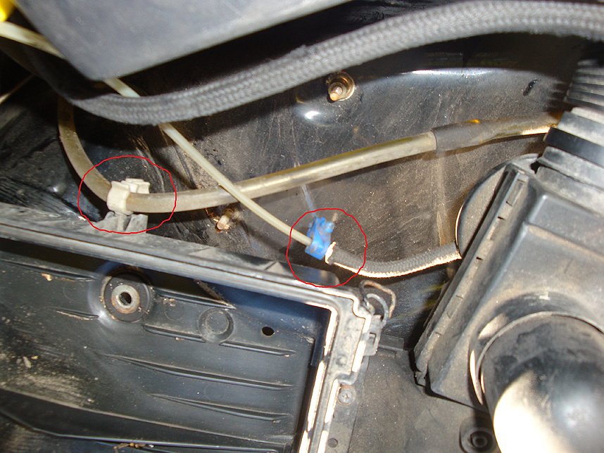

Pull the vacuum hose out and unclip the tubes:
post-919454-0-55740700-1449621442_thumb.
Remove the lower half of the airbox and cold air feed.

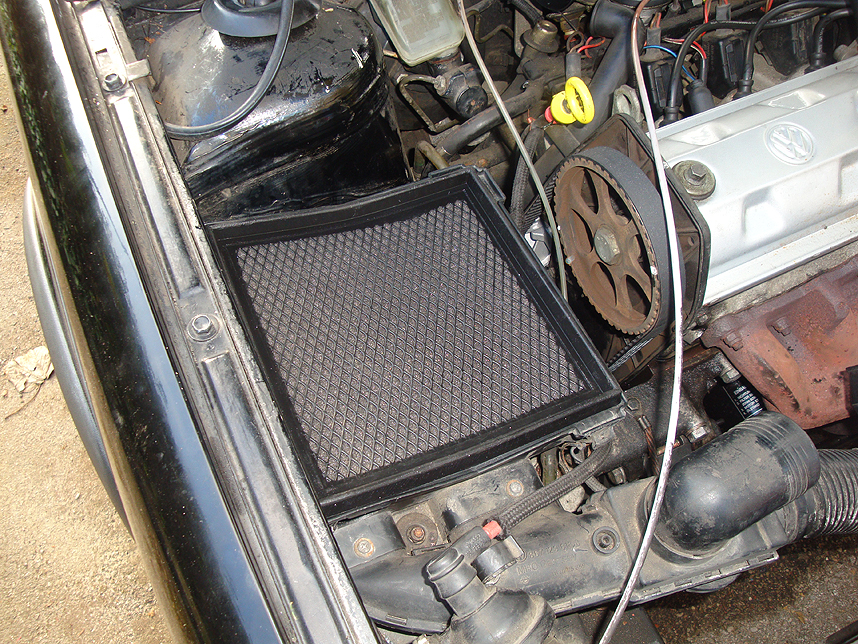

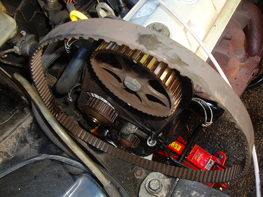

Unclip the four clips clamping the outer cambelt cover, exposing the belt:
post-919454-0-68567800-1449622244_thumb.
This is an early GT; 108-tooth cambelt with larger, rectangular-shaped teeth.

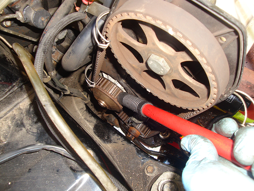

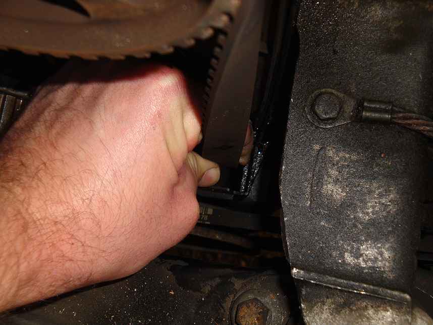

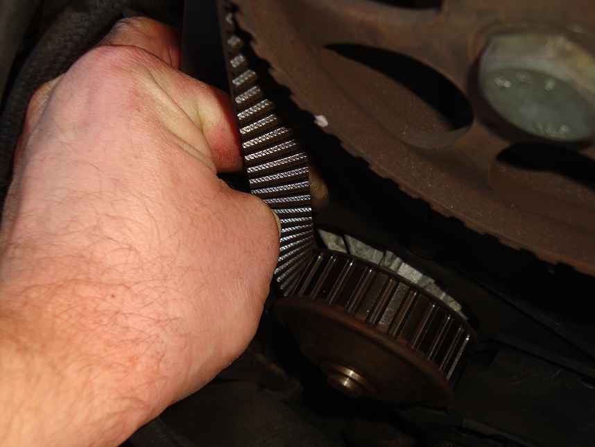

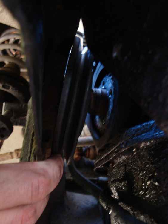

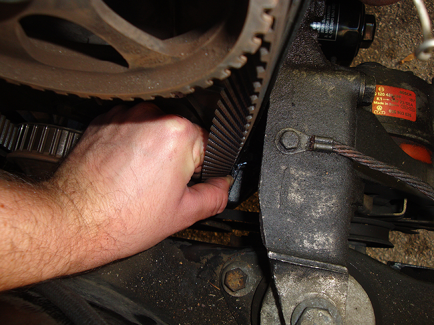

Might be good at this stage to get a feel for the tension of the belt; mine was a few years past the age limit and just over maximum mileage.
The long length could be twisted this far:
post-919454-0-91816600-1449622328_thumb.
post-919454-0-22934700-1449622353_thumb.
The short length this far:
post-919454-0-79140400-1449622394_thumb.
This is probably slightly too tight for a new belt, though this old one didn't whine nor was the pump noisy.

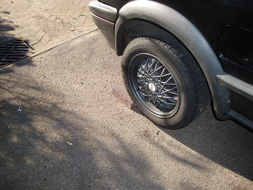

Handbrake on tight, chock the rear wheels:

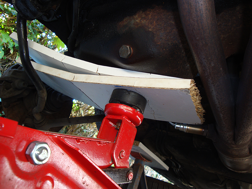

Loosen the offside front wheelbolts. Using a rubber jacking 'puck', centre the jack under the TCA mount and jack up slowly, taking care not to snag the TCA on the jack as it drops if possible:
post-919454-0-64101000-1449622616_thumb.

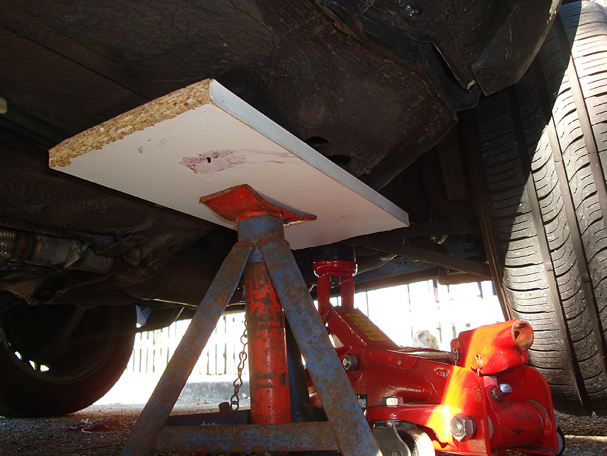

Place a stand under the reinforced section just in from the sill jacking point, using wood to spread the load. Make sure the wood can't slip if it's a block thicker than this:
post-919454-0-59360100-1449622721_thumb.
Let the car down slowly onto the stand and let it settle, allowing the stand to bite properly into the tarmac/concrete. Remove the wheel and place under the sill beside the stand for extra safety.

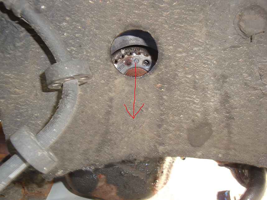

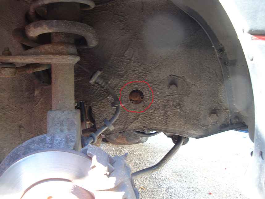

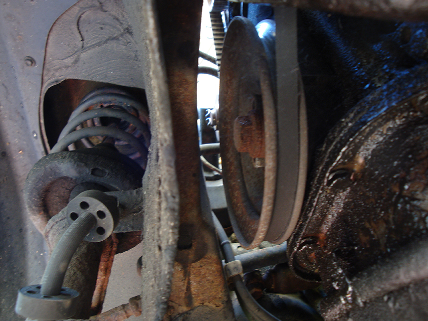

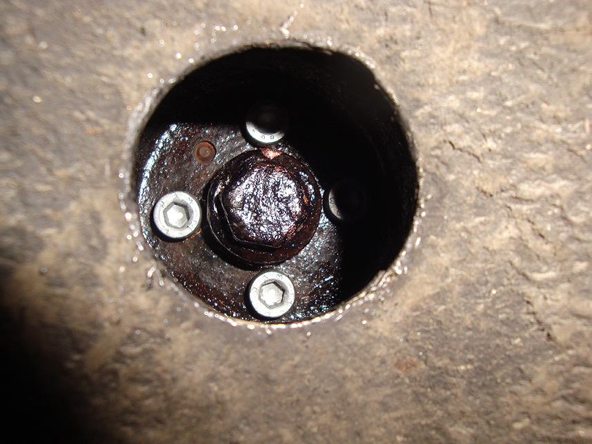

The access hole in the wing for the aux belt pulley bolts:
post-919454-0-12102300-1449622794_thumb.

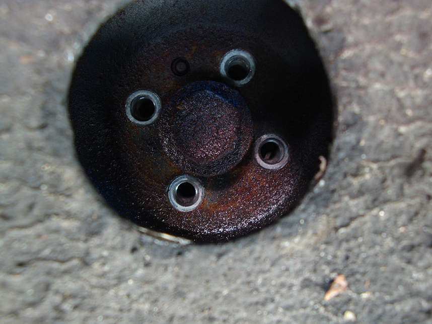

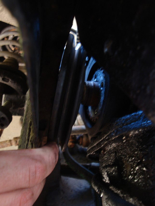

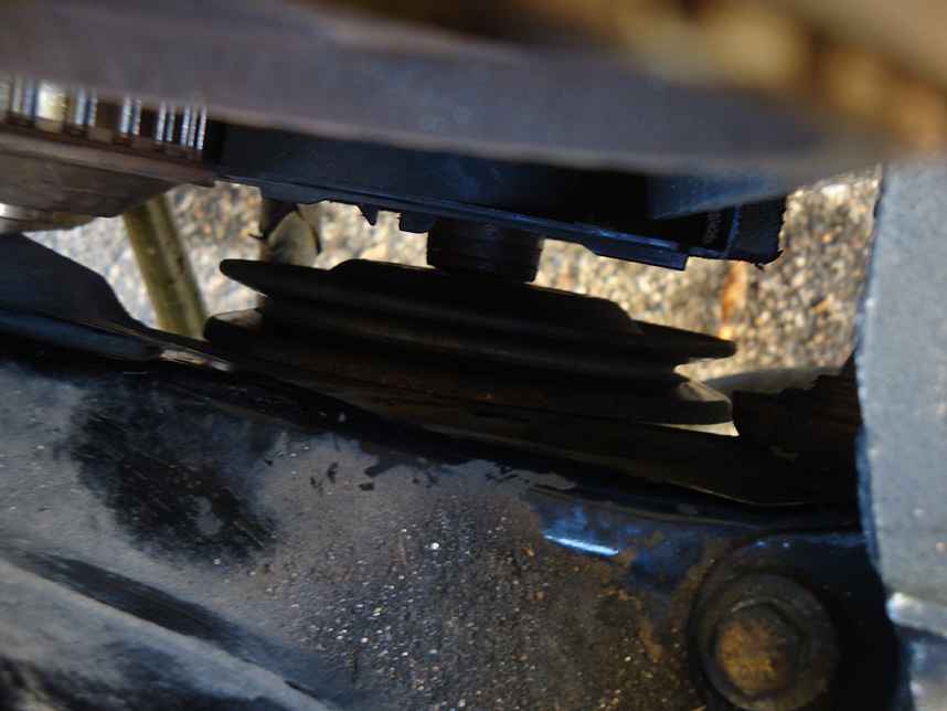

The pulley on the other side of the wing, from below:
post-919454-0-47967800-1449622837_thumb.
This pulley must be removed if you want to retain the lower plastic cambelt cover. The pulley is removed; then the lower cover; then the cambelt is free to slide off the crank sprocket.

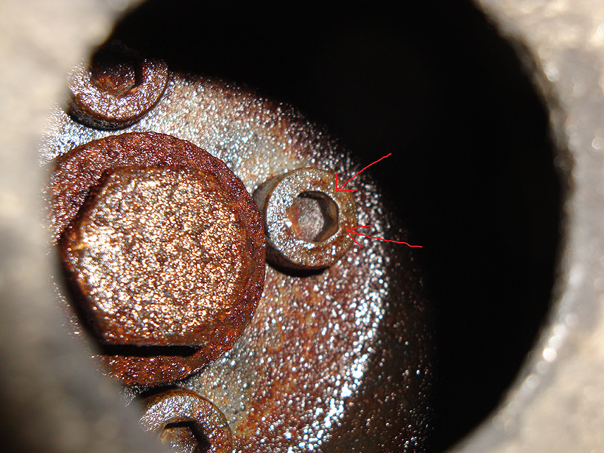

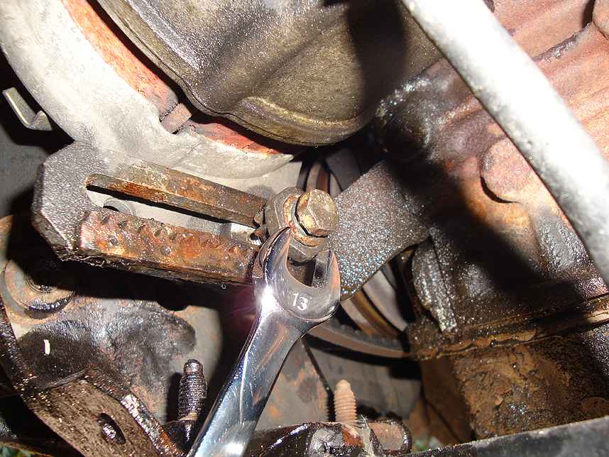

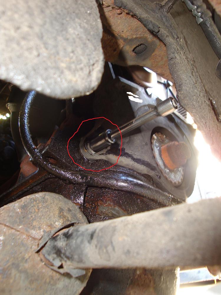

oldtech
Ideally, get a set of four replacement pulley bolts rather than re-using the old ones, as the shoulders will likely be rusty, fragile, and deformed or rounded; especially after having removed them with this tool:
post-919454-0-08692300-1449623101_thumb.

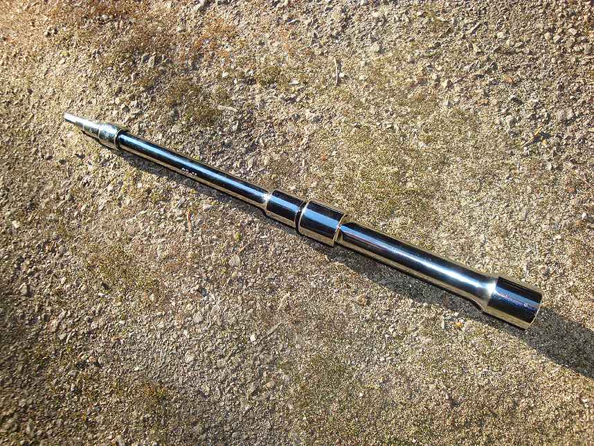

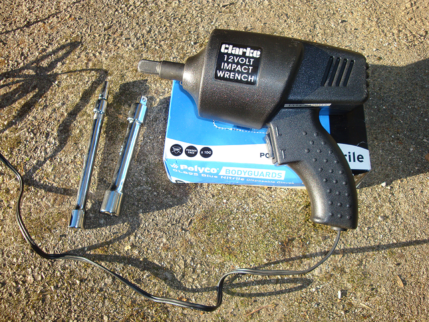

Using this extension:
post-919454-0-18505900-1449623164_thumb.

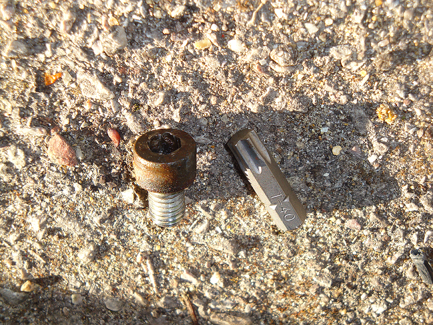

This impact wrench connects straight to the battery and smashes the bolt round, one hit at a time.
The normal hex bit didn't overcome the first seized bolt and so just slipped and rounded the head:
post-919454-0-27445300-1449623247_thumb.
This is potentially not a good position to be in; I've had another pulley (off the car) where the bolts would not break free even with a splined bit. A 'cross' had to be cut into the bolt heads using a craft saw, then squeezed together with a mole wrench to release the shoulders for that one (this wouldn't be easy whilst on the car due to lack of access).
Thankfully, I was able to swap the hex bit with a splined item in this instance and all four bolts undid without fuss using the impact wrench and penetrating fluid. Just make sure to lean into the wrench as it impacts to avoid slipping.
post-919454-0-04326100-1449623541_thumb.
post-919454-0-33947400-1449623566_thumb.

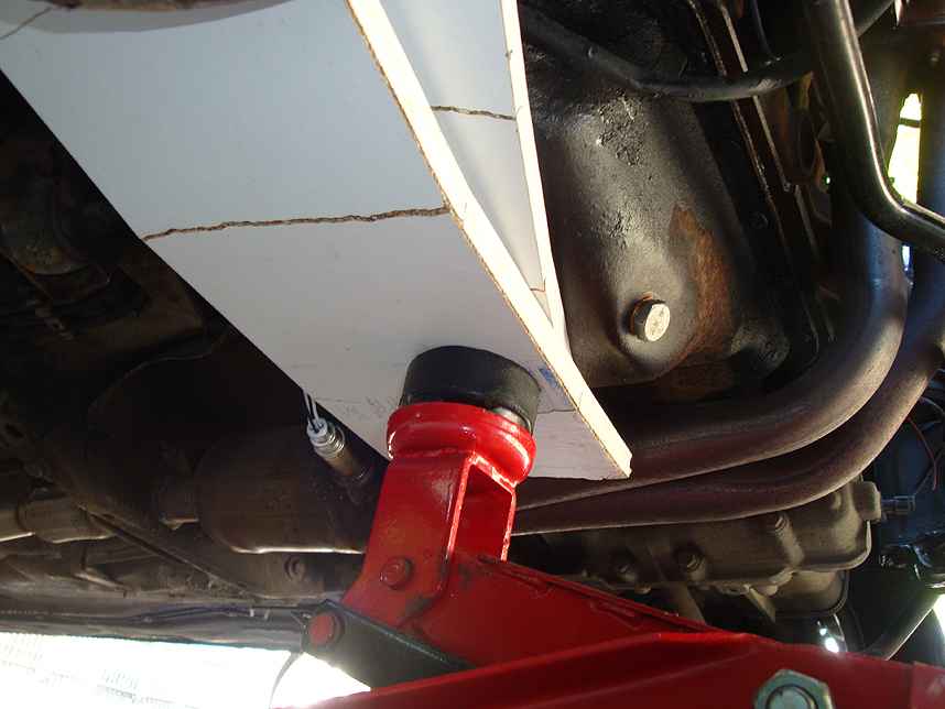

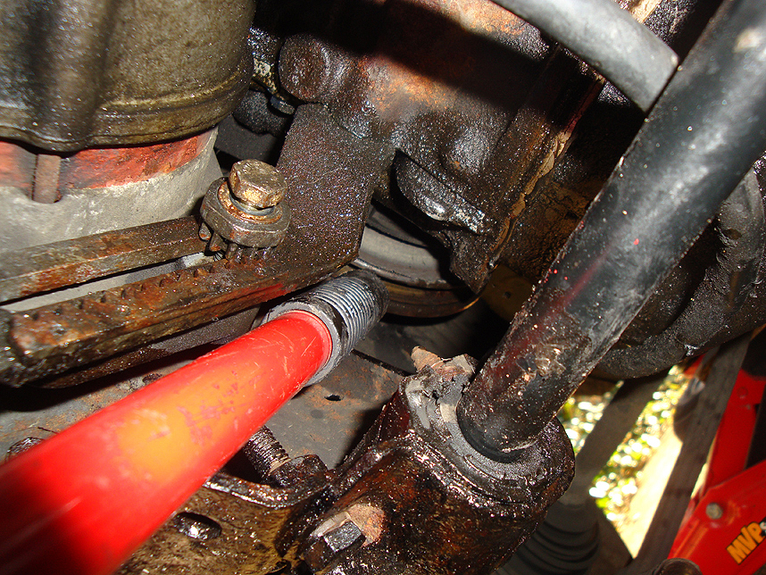

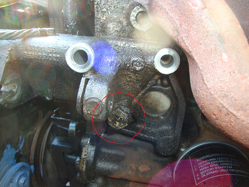

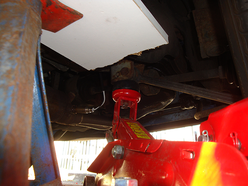

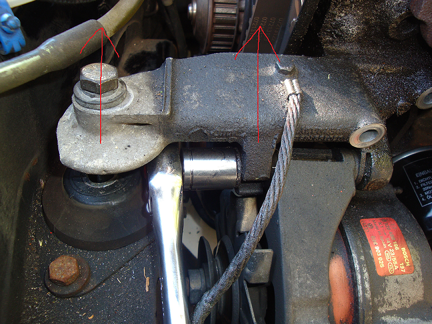

To lower the engine, the forward engine mounting bracket must be removed. To remove the bracket, the alternator must be removed as it obstructs one of the three engine mounting bracket bolts.
Position a jack centrally under the sump, making sure the weight of the engine begins to be supported as the jack is raised. Avoid crushing the sump by spreading the load with wood, and take care not to snag the lambda sensor or any suspension components:
post-919454-0-34161500-1449623995_thumb.
post-919454-0-30581700-1449624018_thumb.

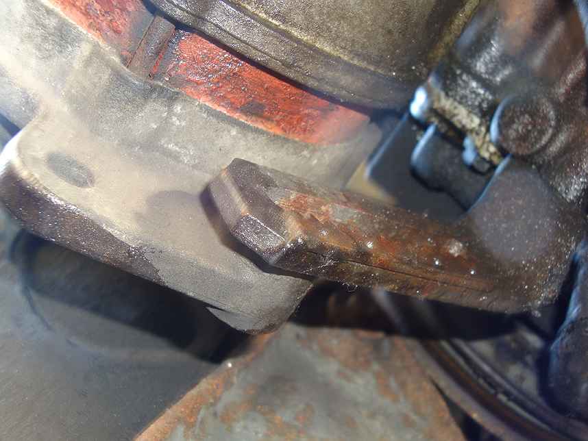

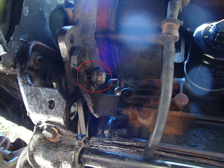

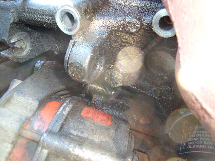

To remove the alternator, I had to raise the engine to get a socket onto its upper pivot bolt, as it is obstructed by the chassis leg. Undo the vertical chassis leg engine mounting bolt and jack the engine up slowly:
post-919454-0-38743200-1449624084_thumb.
At the lower alternator mounting, hold the inner splined nut with an adjustable spanner whilst undoing the outer bolt:
post-919454-0-86645000-1449624142_thumb.
post-919454-0-39869400-1449624174_thumb.

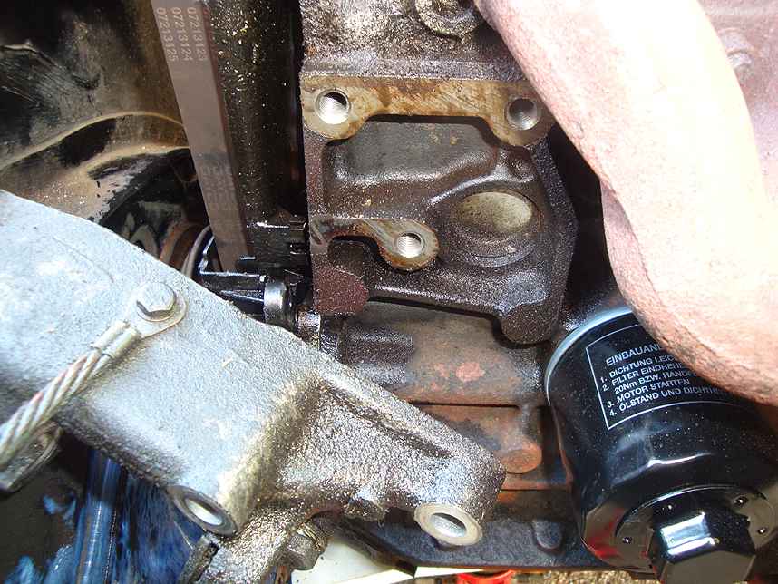

..exposing the final engine mounting bracket bolt:
post-919454-0-29716300-1449624427_thumb.
post-919454-0-25434100-1449624473_thumb.

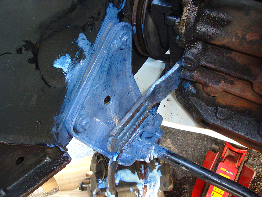

Free the engine mounting bracket:
post-919454-0-68083600-1449624511_thumb.
I took the opportunity to convert the rust/corrosion on the anti-roll bar mount:
post-919454-0-30690700-1449624556_thumb.

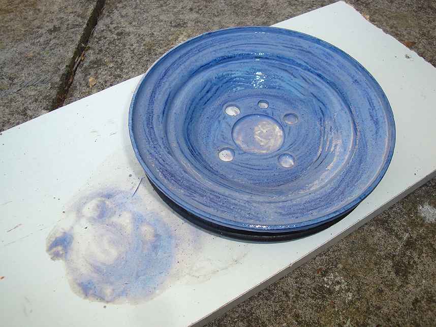

Rust-converting the pulley:
post-919454-0-50888000-1449624764_thumb.

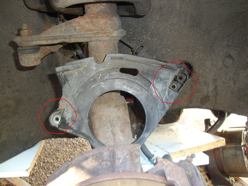

If the engine is left supported by the jack for now, it can be raised or lowered to adjust clearance for tools in the following steps.

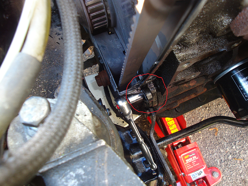

Undo the two bolts securing the lower cambelt cover:
post-919454-0-32599500-1449624834_thumb.
post-919454-0-53461400-1449624867_thumb.
The lower belt cover removed:
post-919454-0-41288000-1449624913_thumb.

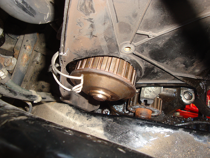

oldtech

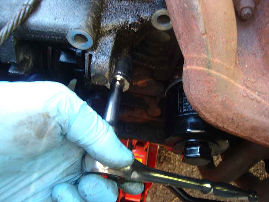

Remove the spark plugs. Using a short extension through the wing hole for better feel, put a socket over the crank bolt and bar the engine over clockwise until the TDC dots line up on the cam sprocket (a plastic arrow on the inner cover) and crank sprocket, if present:
post-919454-0-03265000-1449625111_thumb.
post-919454-0-19338900-1449625157_thumb.

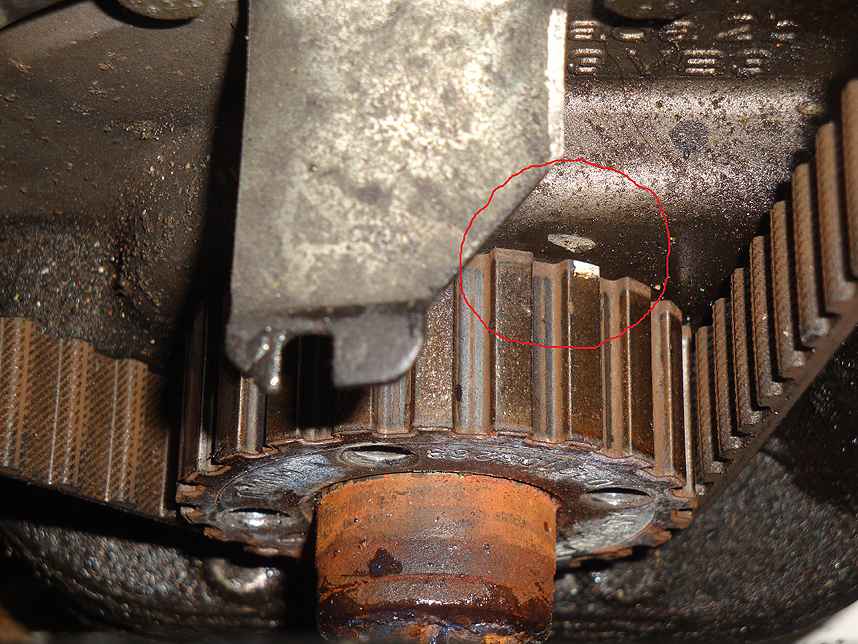

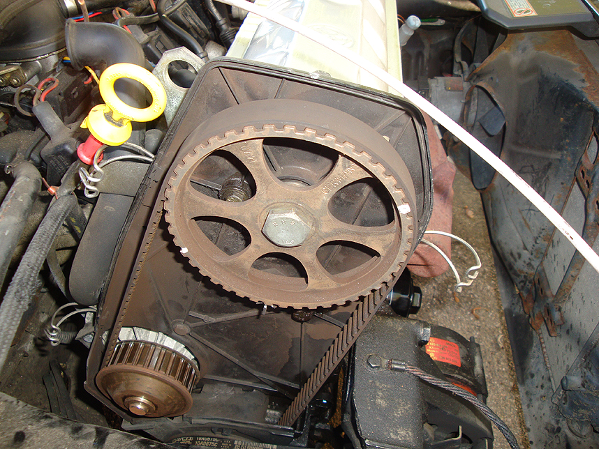

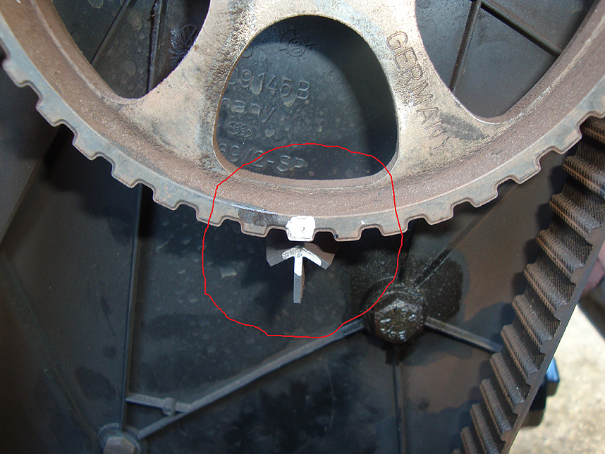

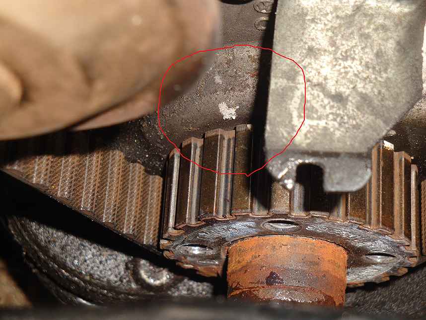

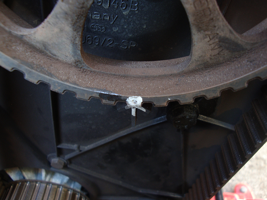

My block didn't appear to have TDC marks by the crank, but there was white paint that had been left from a previous change; I used these as a reference:
post-919454-0-44951800-1449625193_thumb.
post-919454-0-60731500-1449625219_thumb.
The engine might need to be raised again on the jack to line up with the wing hole again for this.

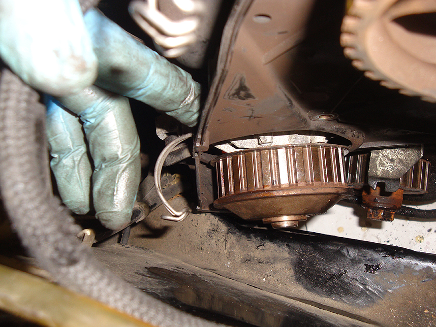

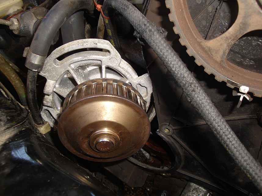

Undo the three bolts that secure the water pump; two above, one below:
post-919454-0-57414300-1449625605_thumb.
post-919454-0-44838300-1449625628_thumb.
Give the pump a tap and it'll come free:
post-919454-0-04513100-1449625694_thumb.

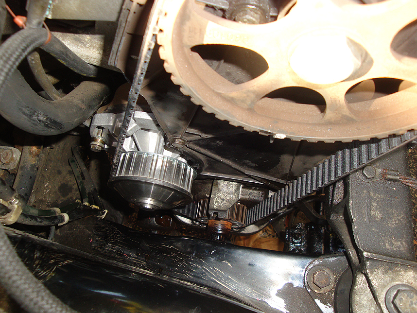

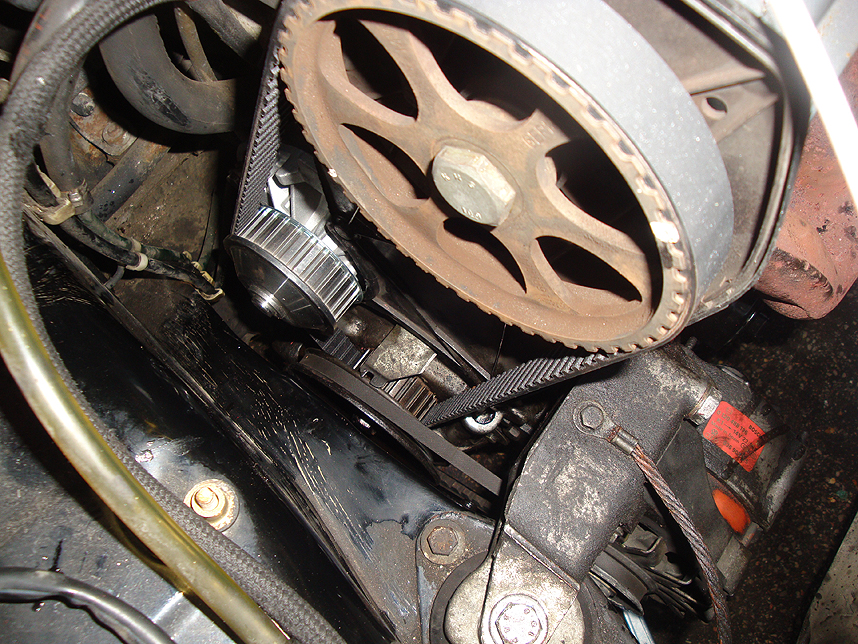

Remove the old cambelt:
post-919454-0-29529900-1449625722_thumb.

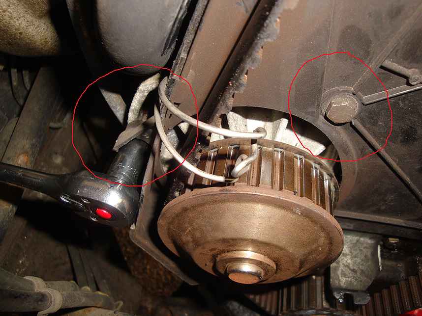

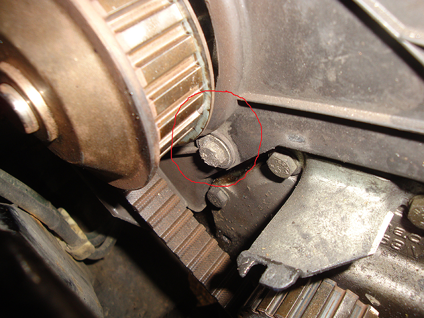

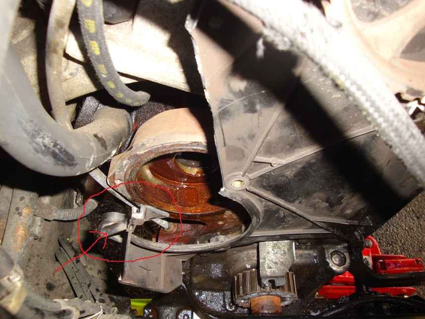

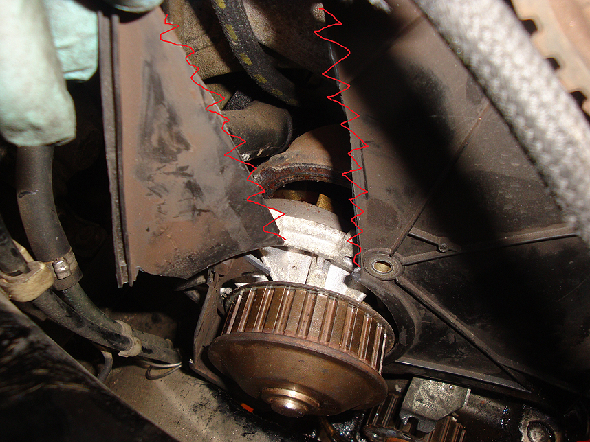

The water pump is obstructed by the inner plastic cover surrounding it; the suggested way to remove the water pump would be to first remove the cam sprocket so that the cover can come away; however I read that it could instead be flexed out of the way just enough for the pump to slip out...
post-919454-0-09983000-1449625819_thumb.
post-919454-0-60157800-1449625846_thumb.
Share this post
Link to post
Share on other sites
oldtech
But my plastic snapped here anyway. It might be possible but care must be taken as it snaps with no warning! It flexes only so far then just gives way suddenly:
post-919454-0-37154700-1449626345_thumb.
post-919454-0-61340600-1449626431_thumb.
This is the point where I decided to omit the covers for the future as they make the whole job much more involved!

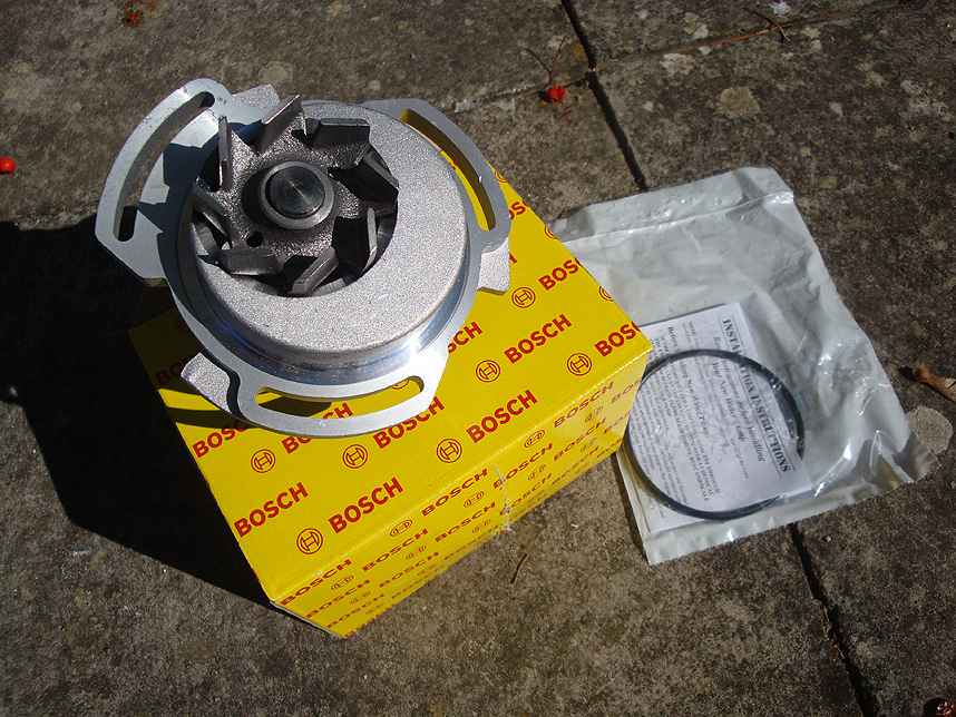

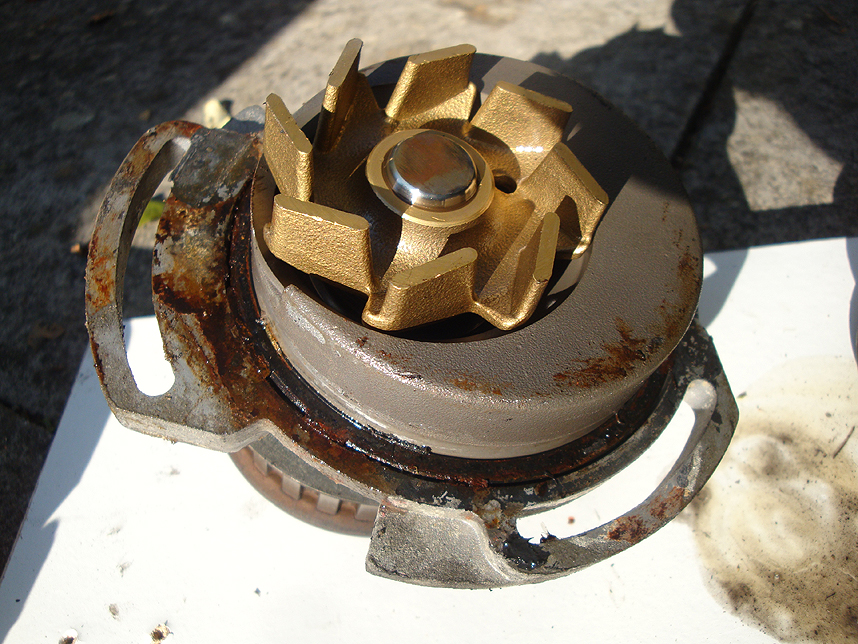

The old pump:
post-919454-0-53517500-1449626453_thumb.
I snapped this small part away too, then removed the embedded washer to re-use with the new pump:
post-919454-0-01555600-1449626486_thumb.

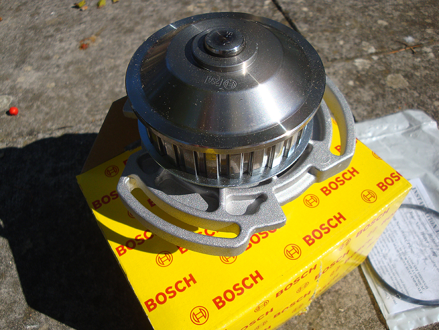

New pump:
post-919454-0-57112400-1449626523_thumb.
post-919454-0-04567900-1449626554_thumb.

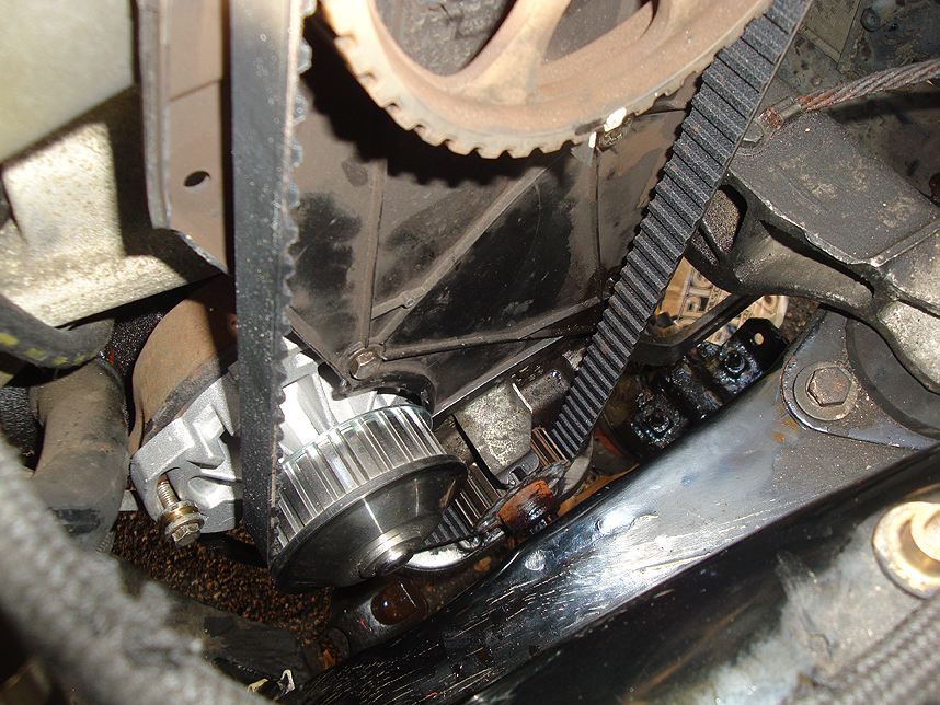

New pump and belt on:
post-919454-0-20458300-1449626742_thumb.
post-919454-0-71788700-1449626788_thumb.

I'd also add that the timing marks are on the Aux pulley not the crank pulley. So ideally you need to get the engine at TDC before removing the aux pulley.
Fantastically detailed write up though. Well done!

personaly i wouldnt use a large impact gun on the 6mm hex keys either , too much for the small heads
i always seem to get away with hammer in a good quality socket , hammer it so that it seats fully if theres any grime or rust in there , then a sharp jerk on the ratchet cracks em loose , if that ever fails then hammer in a spline or torx bit

steveo3002
see the bracket in the middle with the square notch? that the tdc mark you need to refit the pully
