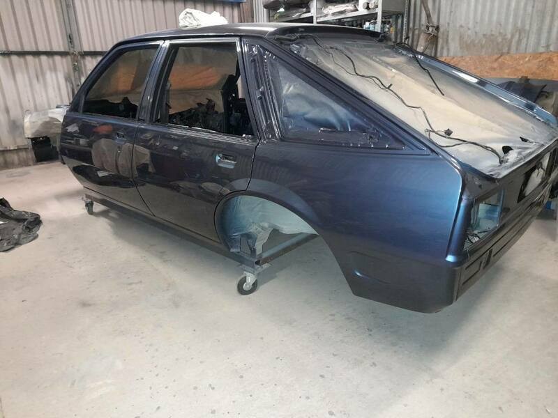

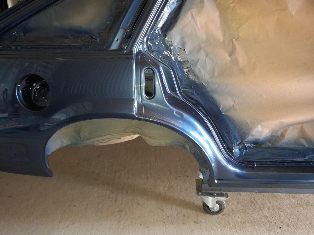

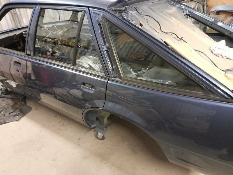

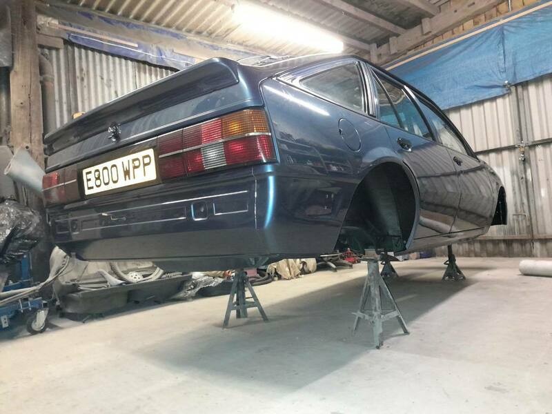

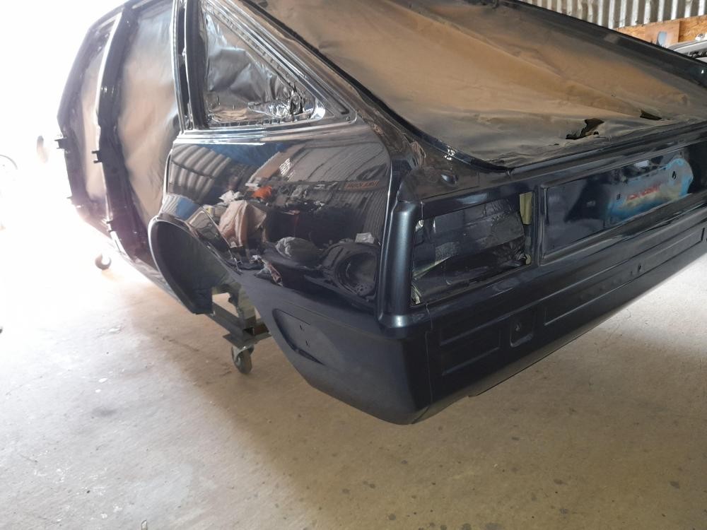

sleag40
Three days later it was done.

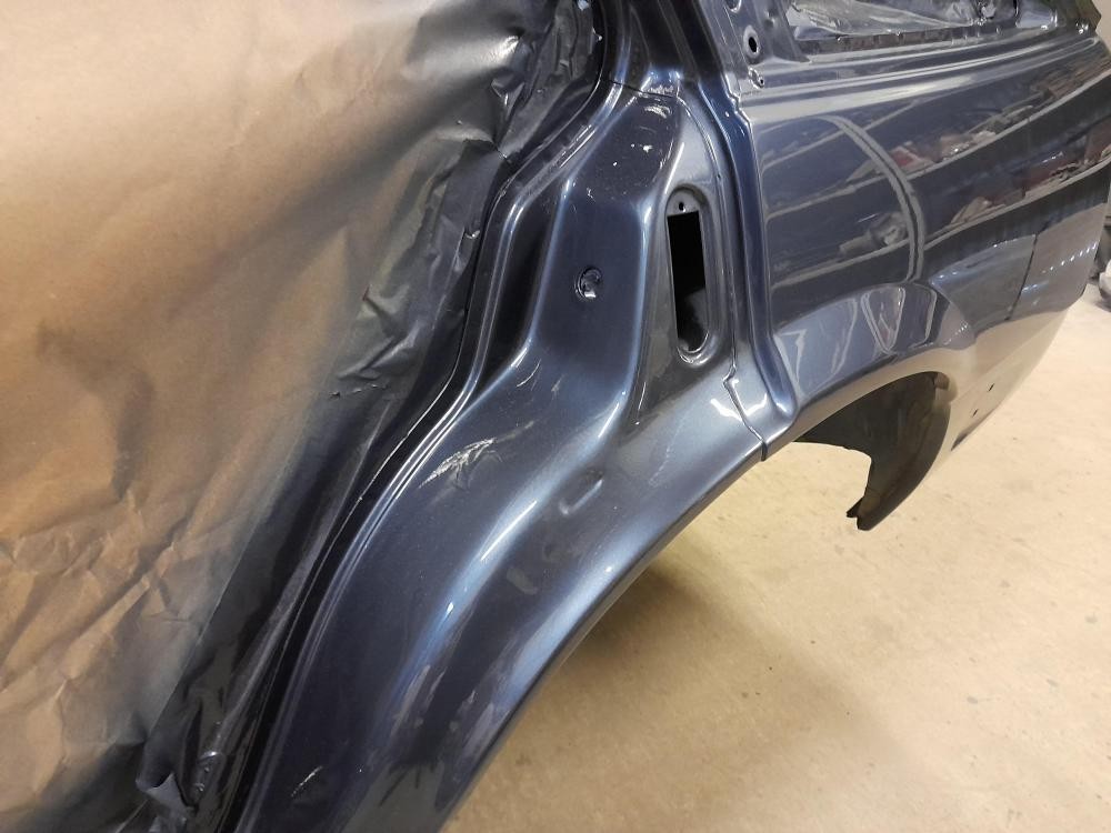

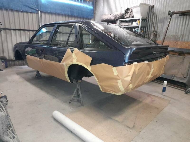

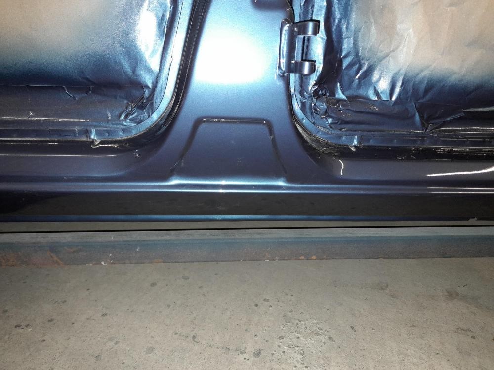

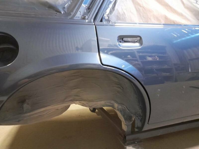

I was a little worried that my bodywork skills may be a little sub par, but the paint bloke had very little to do other than paint it.

sleag40

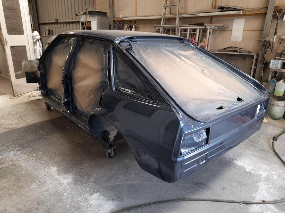

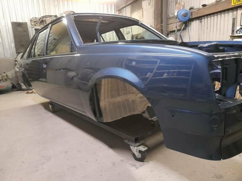

HA! the amount of time and effort you have put into that the paint bloke must have been very happy!

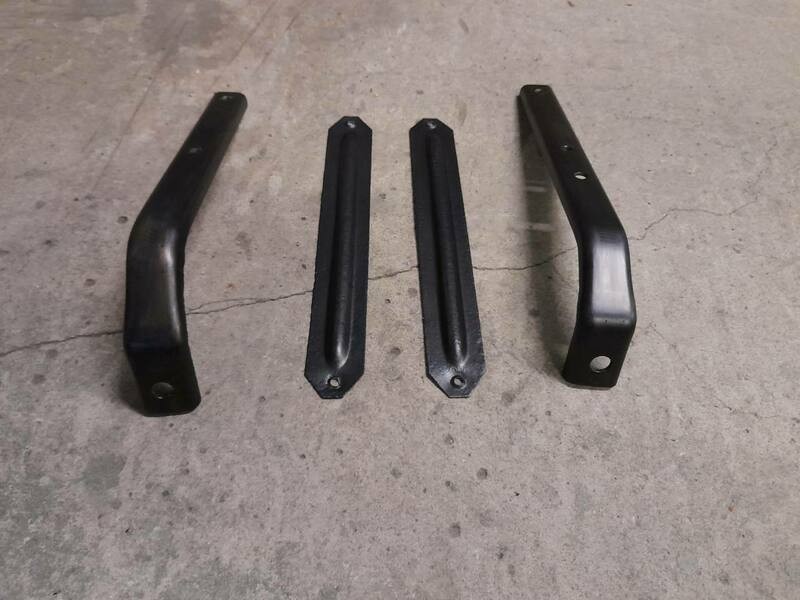

sleag40

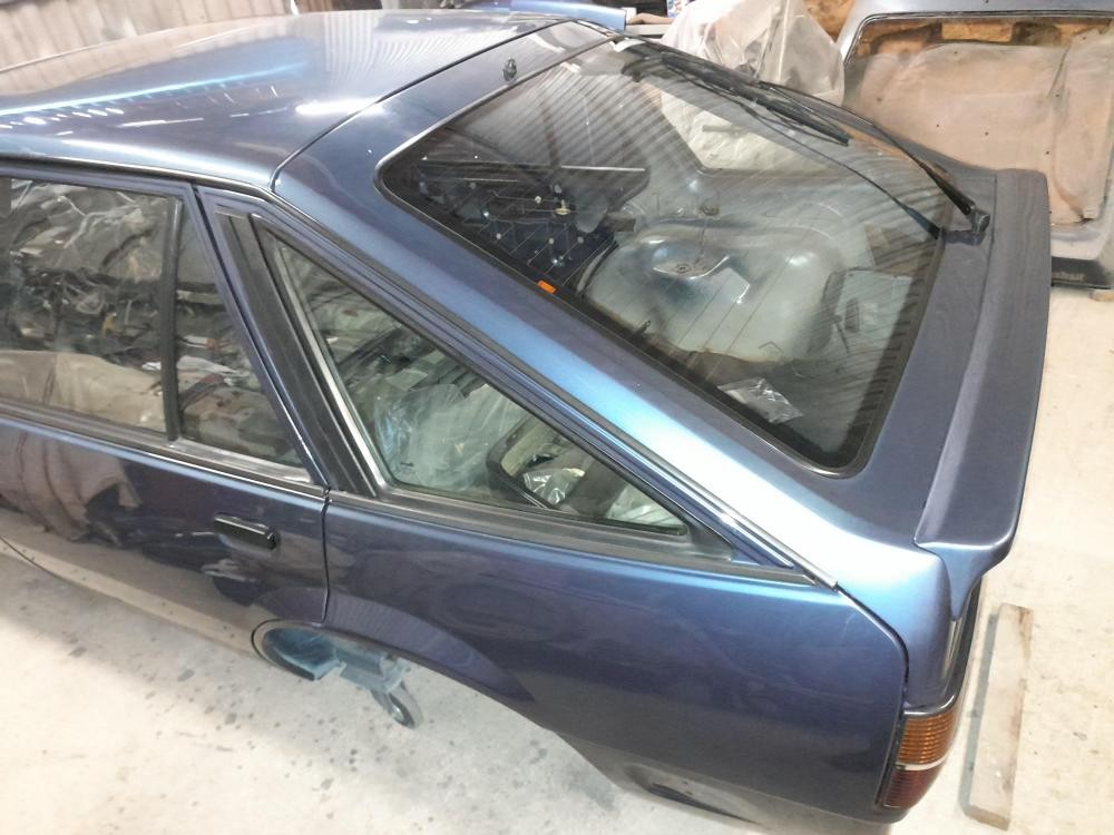

Bit of catching up to do!

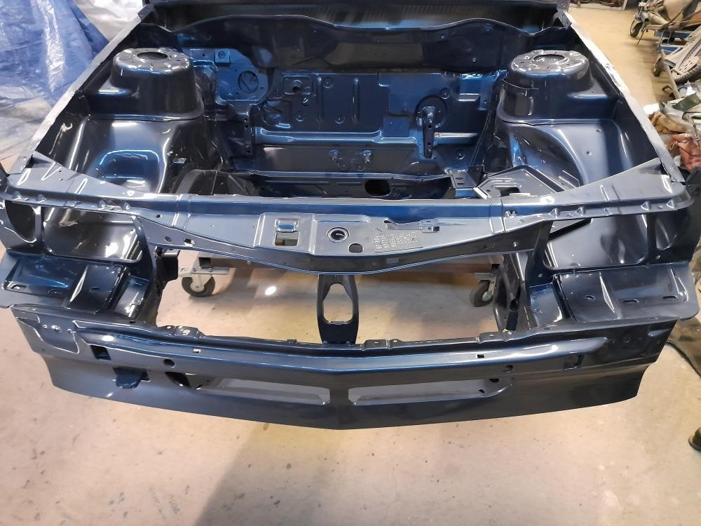

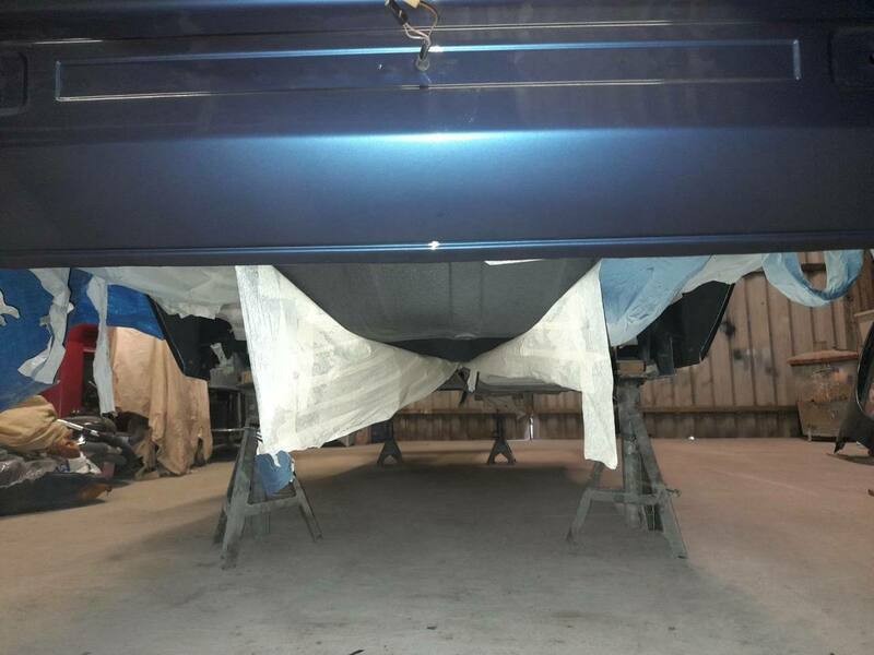

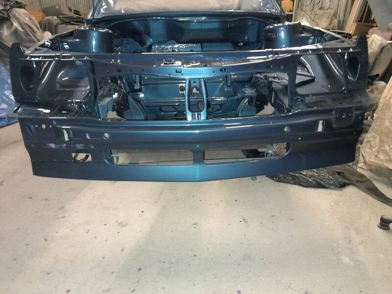

Today (August 7th) was mostly spent elsewhere, but I managed to get down the farm for a couple of hours.
I bare metalled the bumper brackets in preparation for a bit of paint, then cleaned up the plastic front end parts that will be going over to the paint bloke on Monday.
20210807_181330.thumb.jpg.23bf4eb8777812518cb0bca714a48536.jpg.283c604c3f3b278f09e6d7badc26fdb0.jpg

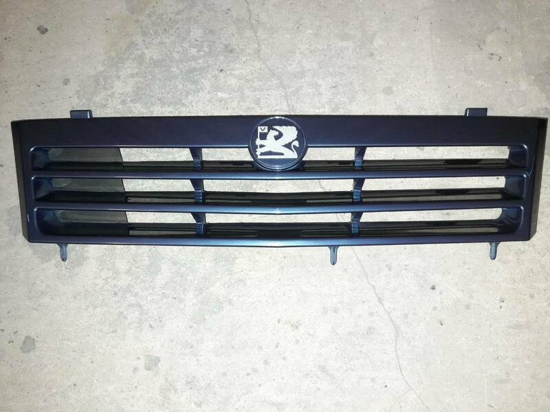

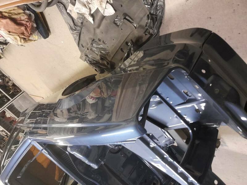

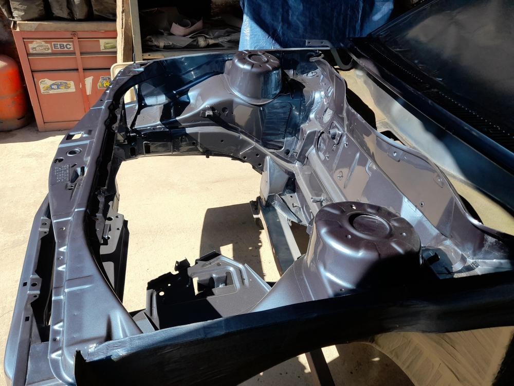

Just looking over the front end of the shell before I left,  it seemed a shame that none of this will be seen once the car is back together.
20210807_173408.thumb.jpg.2da73859f3d533b4067168e910df85c8.jpg.4e72e8b2f7fc60f72620f10b40c34497.jpg

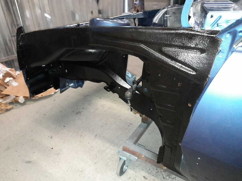

I also remembered the state of the thing once the bodge repairs were removed nearly 3 years ago.

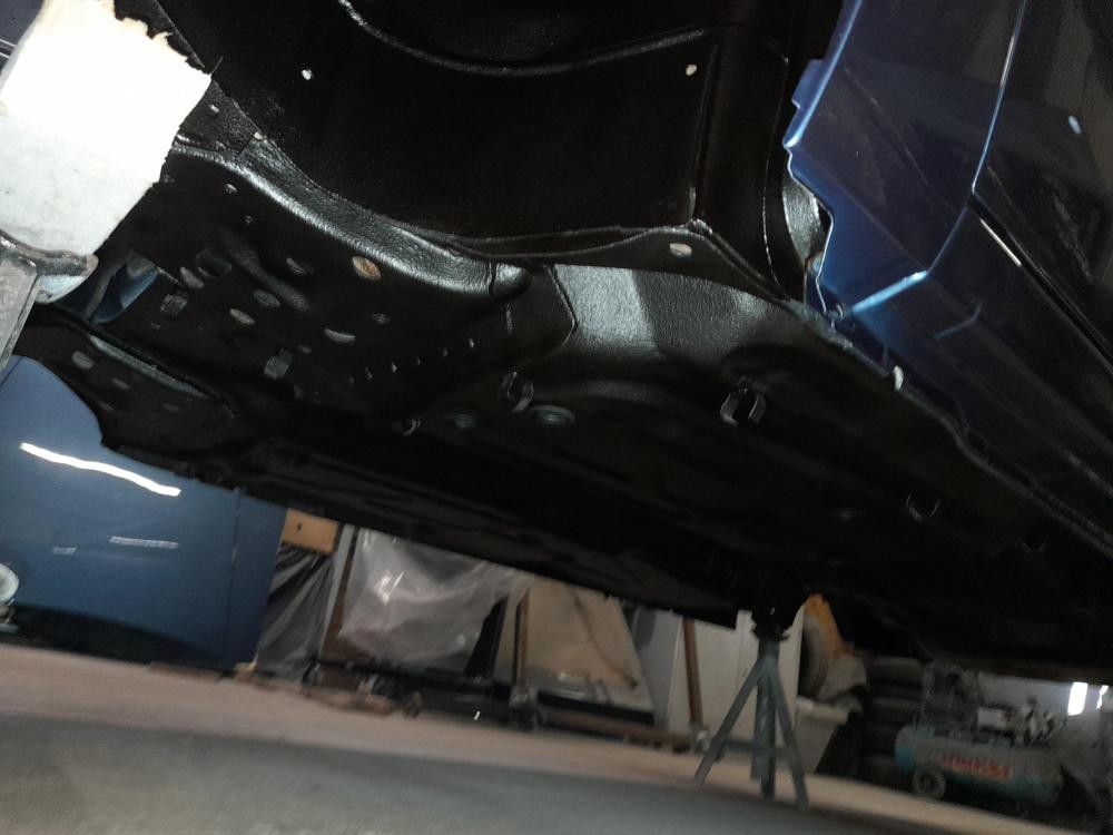

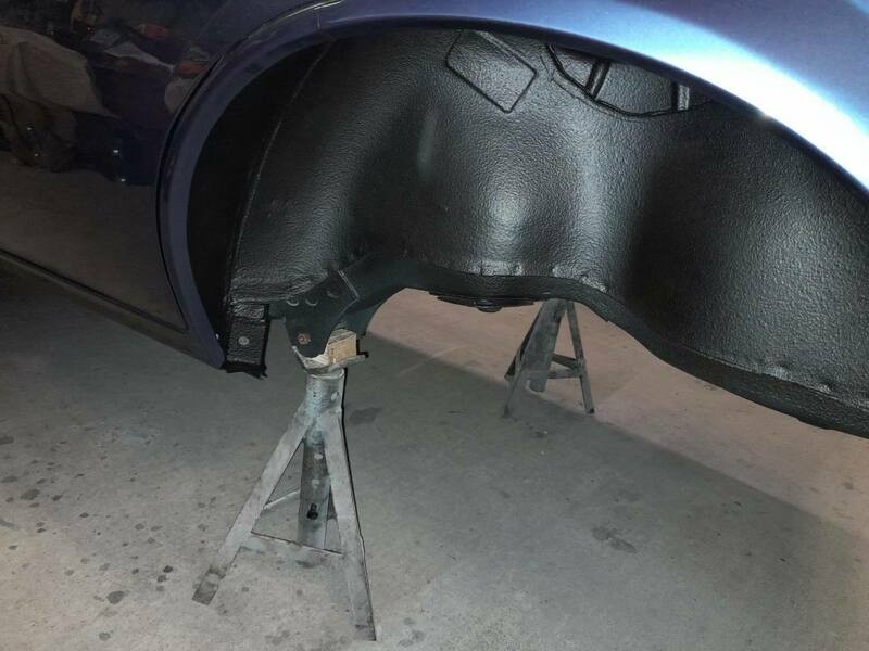

sleag40

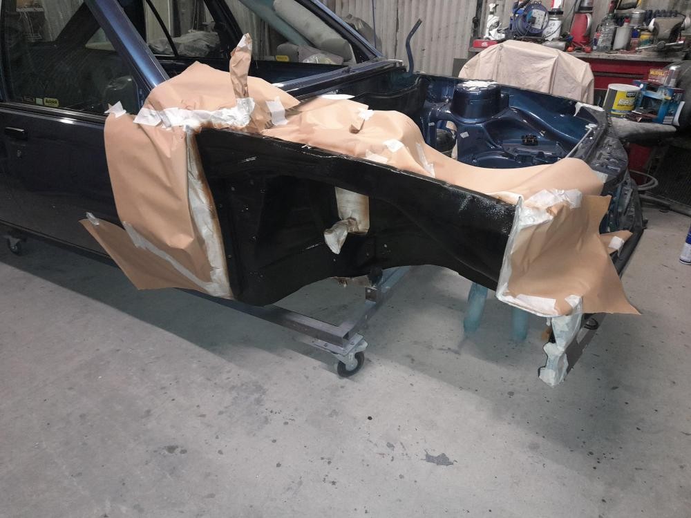

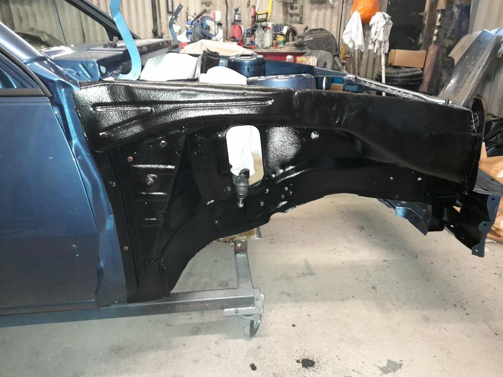

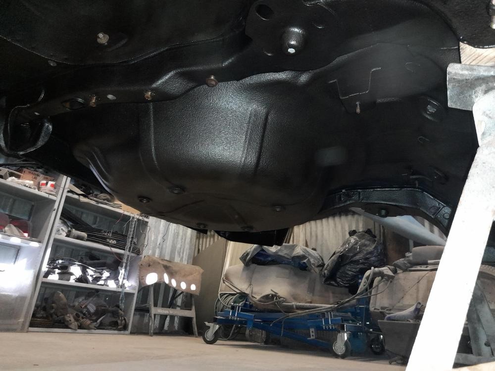

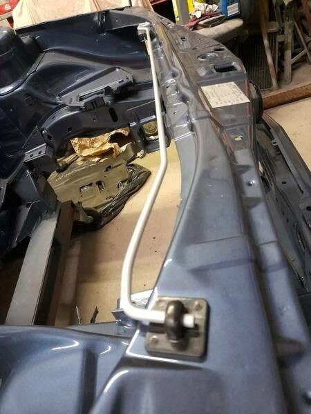

Pottering about in the shed today (August 8th) weighing up how much cavity and underbody wax I need to buy. Several other items required for the rebuild have been put on a list to facilitate procurement.
The parts bare metalled yesterday got treated with Hydrate 80, and were subsequently primed ready for some satin black paint.
20210808_165259.thumb.jpg.163f0f131fdfce21e079aa5fa6a7435b.jpg.55257d325d5614bc5c3fb6b13b84eb19.jpg

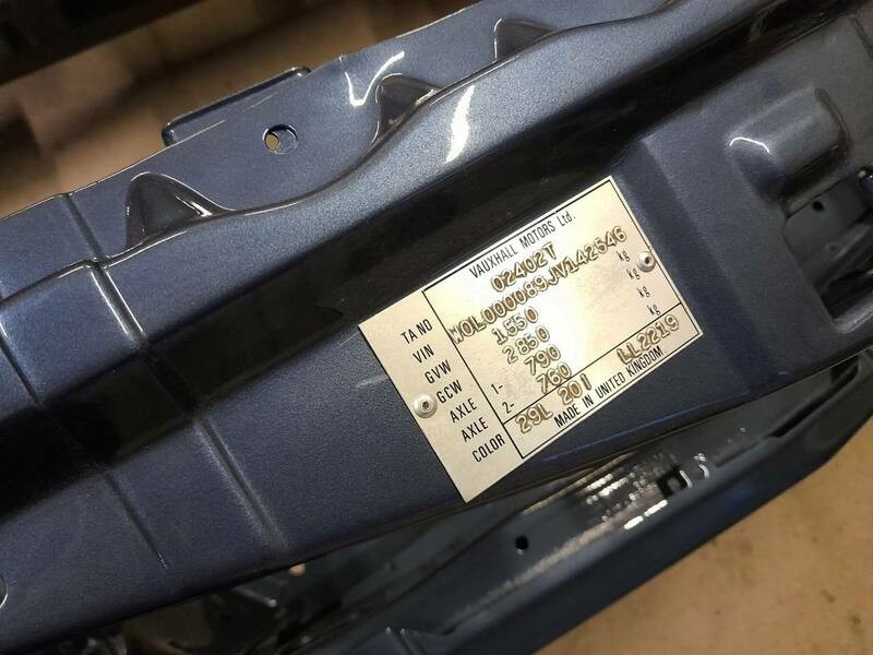

Whilst having a rummage through the boxes of parts, I came across the VIN plate, this was duly riveted back on.
20210808_180111.thumb.jpg.3ab3cc757681f0919b2db4d9516d7784.jpg.40de14c028c6ac26f16615849a9a64ca.jpg

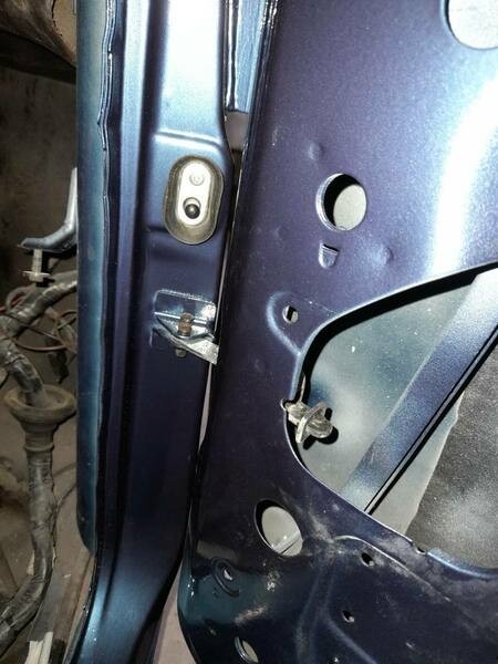

sleag40
Got a decent amount of time on this today. (August 14th)First up, I finished off tidying up a few bits and pieces - bonnet furniture.
20210814_115233.thumb.jpg.92545c8dedbdcbebc470ba258b49f75c.jpg.244b1ffc44b4a134627edda003db952c.jpg
And bonnet prop.
20210814_174732.thumb.jpg.d52eb086b0e12d9feeed005148ea1602.jpg.5d468debbf1e7db40c8e5b45fe9b8fc8.jpg

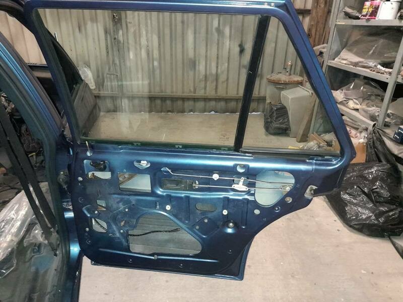

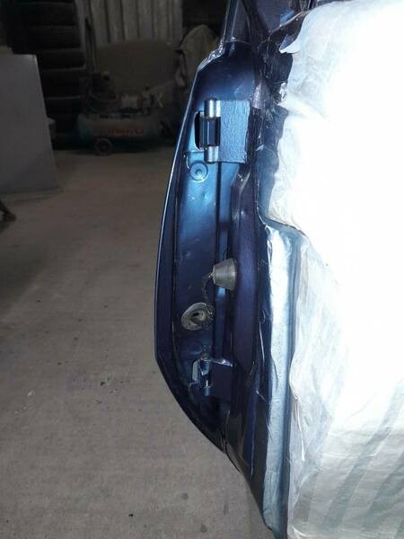

The rest of the hinge pins were knocked in, then the check straps were fitted, then the door switches were screwed in after the wiring was fed through the a and b pillars.
20210814_125917.thumb.jpg.6a29004249e80dccc62686557e1ee4b3.jpg.605331e11ab0f25abd2501bb0930cfd9.jpg

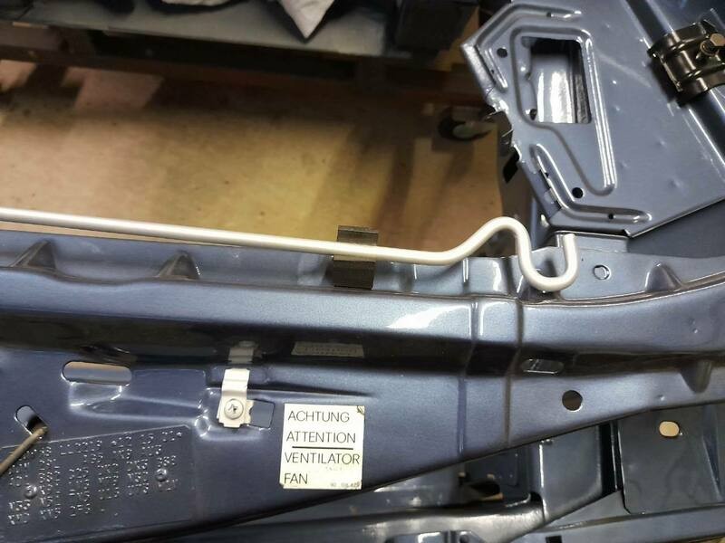

Next up, the wiring for the central locking and electric mirrors was pulled through the pillars and fed into the doors.
20210814_201526.thumb.jpg.4fa65e7adf41583281c10adf58f39ff8.jpg.7e4f4b043aceb10d4498e9958b4f4934.jpg

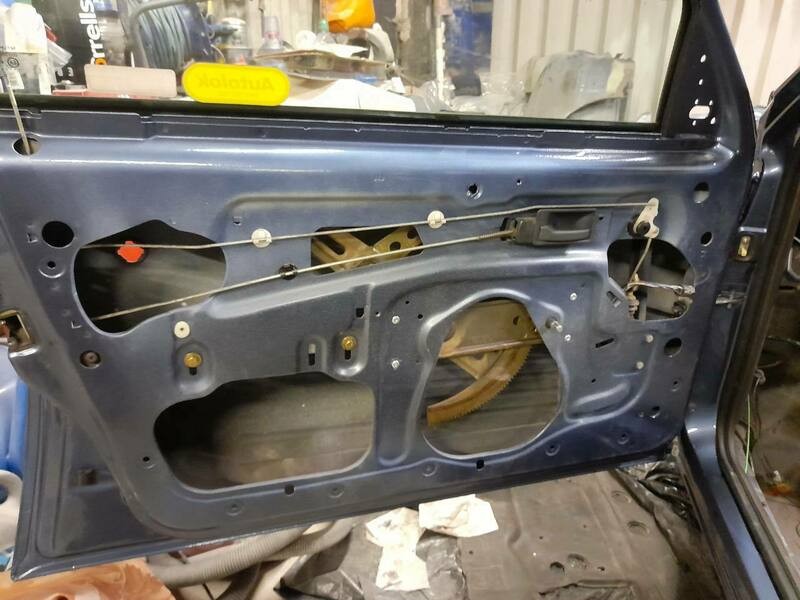

Managed a couple of hours in the shed this evening. (August 16th) First up, the fixed glass aft of the c-pillar went in, closely followed by the rear door glass.
20210816_201100.thumb.jpg.79283f49df87833fde6eca9886f19463.jpg.ecbe9fa131b49e5401208819f5dd0a12.jpg
Next up, all the lock related rods, window regulators + central locking solenoids went in. I can't fit the exterior handles yet, as I need to paint them first.
20210816_201439.thumb.jpg.5c02ea28f319682a34a14135902db6cb.jpg.8eef89412edc727c1a7f62e4855663aa.jpg

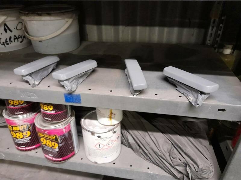

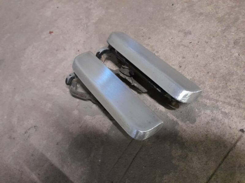

sleag40

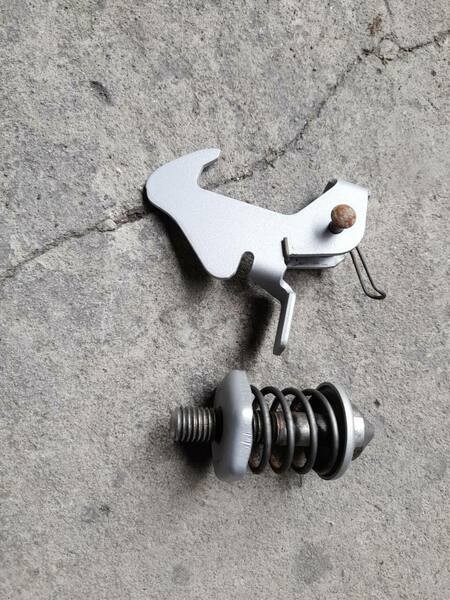

The door handles were attacked with some 80 grit sandpaper this evening. The flaky original paint and oxidised aluminium was cleaned back to bright shiny alloy.
20210818_174010.thumb.jpg.d4deff5a73c2b59fa25547062e575c07.jpg.dbcdc9a2fc263c2c29356a49849631ca.jpg
Once sanded and thoroughly cleaned, they were given a coat of etch primer.
20210818_183327.thumb.jpg.b441e557d1d0488e8dc091e989fdc6d7.jpg.e2e1d0b2708459090b9604126cf8315d.jpg

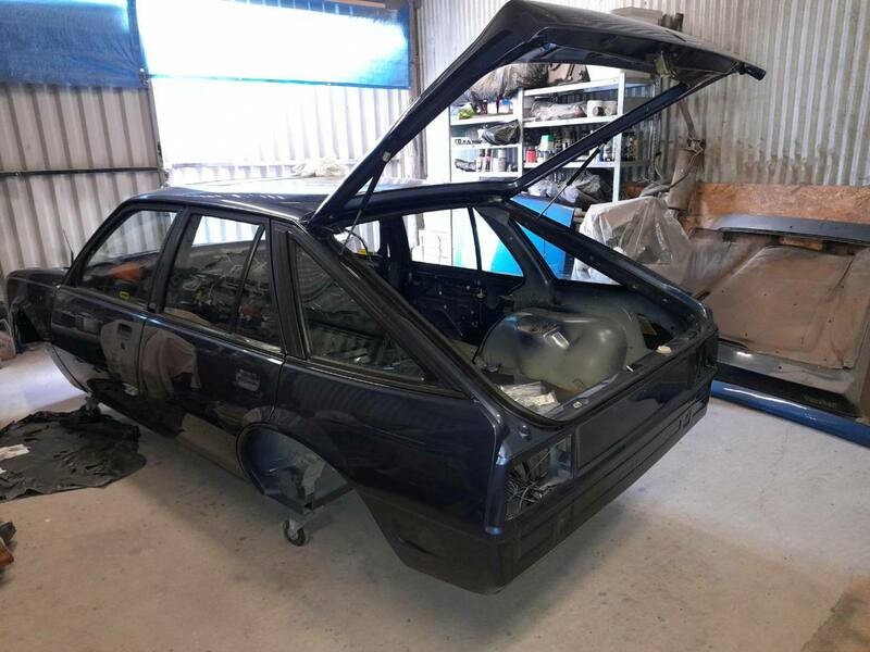

sleag40
Didn't get a shot at this until late in the day, nevertheless I got a few jobs done.
There was only one body about on the farm, and he was roped in to help me get the tailgate in position.
20210821_144216.thumb.jpg.5b21a1c38cb6c8128753eb6ab3c08465.jpg.b3ade4211a4ee3db8bec9d0eaec3d356.jpg
Once the wiring and washer hose were threaded through (massive faff) then the wiper mech, washer jet, lock catch and central locking solenoid went in, I stopped for a look.

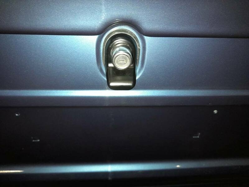

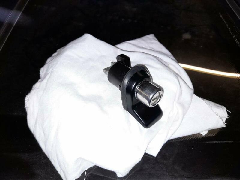

Other stuff has been taking up most of the time in the shed recently, but the tailgate lock and handle were reunited after a bit of paint was applied yesterday.
20210823_172234.thumb.jpg.efc2d22ff1d7ea04958b3da239224fc5.jpg.21cc521c95d109675d03365ffded76ca.jpg
It was then clipped into place, meaning I can open the lid without poking a finger in the mechanism.
20210823_173419.thumb.jpg.99e623fa05e1942405af16f08c9ee02f.jpg.c14a0499ddaecfd953abbc7d5b6ae5d3.jpg

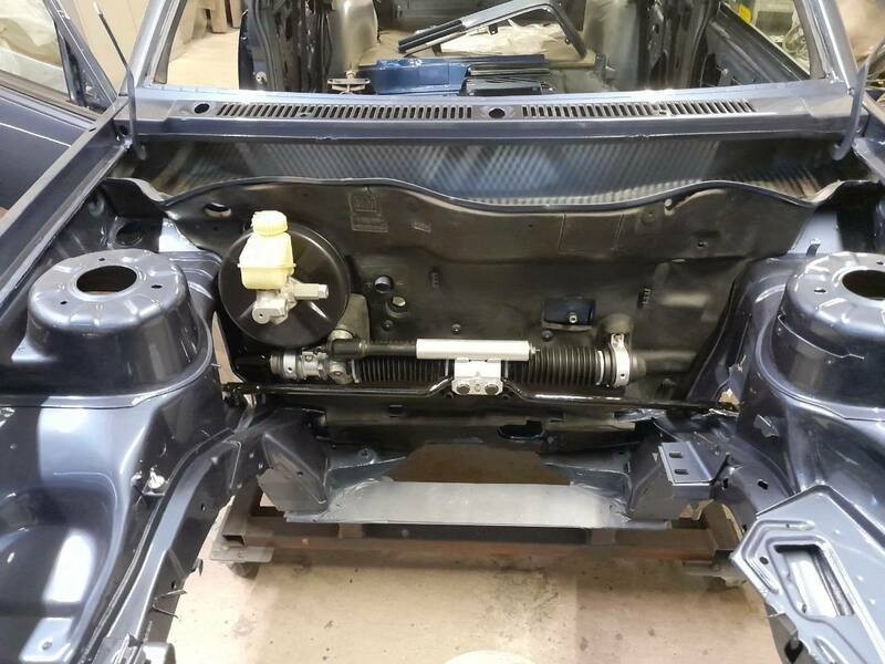

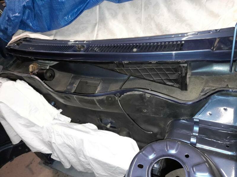

I didn't think I was gonna get another go at this until next weekend,  but opportunity presented itself, so I grabbed it.

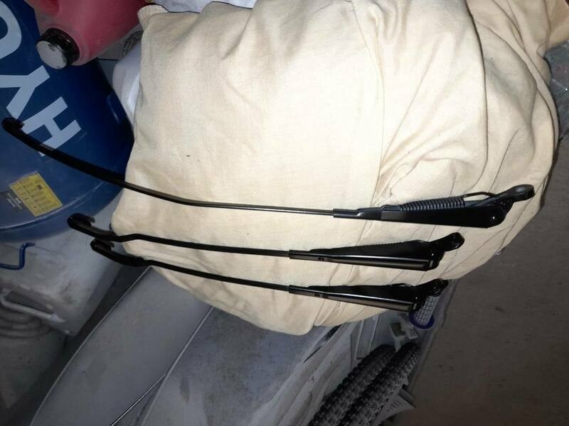

I finished up the wiper arms first.
20210827_170121.thumb.jpg.0caff0c6911806edae0087c1c02f0040.jpg.0a7736a7f2ac87d16ae40059e9df8485.jpg

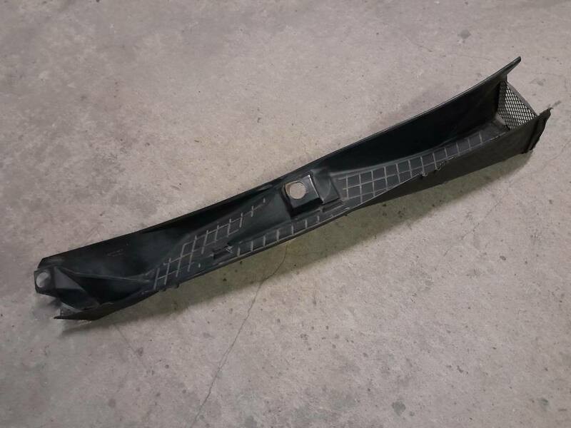

Then gave the bulkhead cover a decent clean.
20210827_154740.thumb.jpg.d671343b33f6cd1d96f20f9538a4f691.jpg.59b226be081edabd0155e051c54cb8cc.jpg
After I'd located the bag of relevant clips and fittings, it was reinstated.
20210827_164139.thumb.jpg.8cb00983f585231ee41651d6bcb51259.jpg.7877a5507385f995b364c85d5ca0564c.jpg
This means that I can put the servo and rack back in at some point, hopefully next week. :)

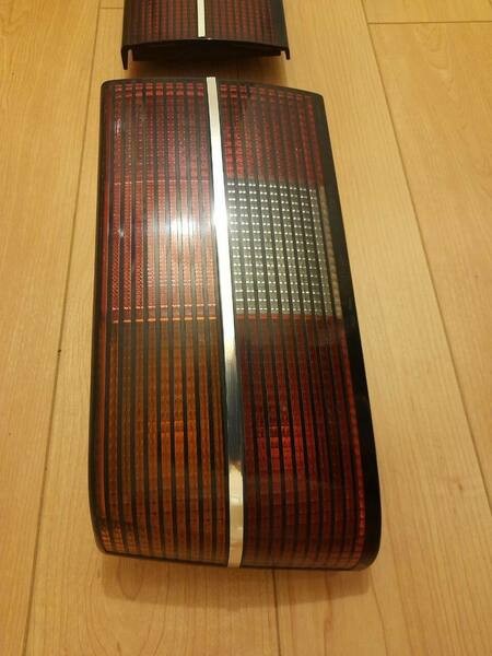

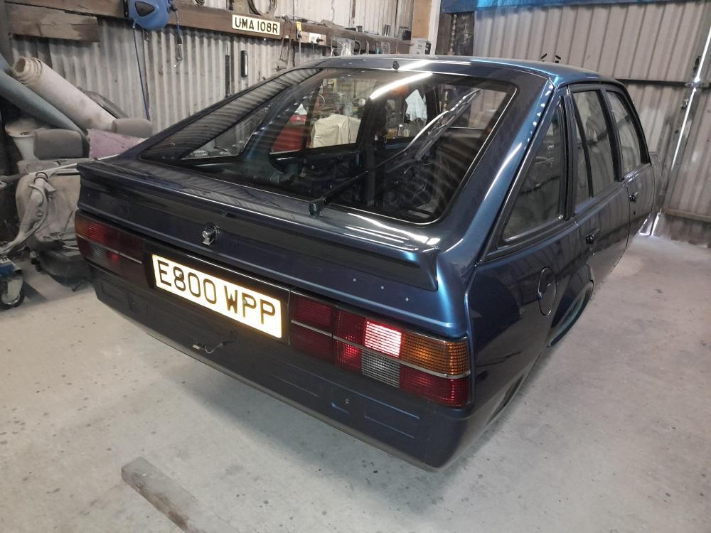

More time theft occurred - I gave the tail lights a bit of a spruce up.
20210828_155717.thumb.jpg.2fcf99ad568a4c1835d022e74b2abbd5.jpg.31674013937b0e2de36f3bfb0166d7c8.jpg
Thought I may as well throw them on.
20210829_112810.thumb.jpg.c204d83f28c1dd931ea00e2a236046da.jpg.7161d5319203c6c8533af4955f072f84.jpg
Then thought I may as well chuck the reg plate on too.
20210829_113517.thumb.jpg.957117bb8a62256602e59a209b3268f7.jpg.33feee6c5d821c90f99953bc4508e56e.jpg
Should get a decent amount of time on this on the next session.   :)

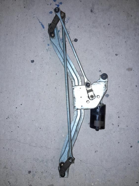

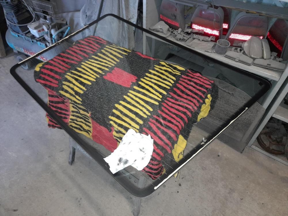

A few more bits and pieces done recently, the wiper mechanism got a good clean up and went back in.
20210831_183410.thumb.jpg.4df6fb6e5d480bca7bebb48bd229ecc7.jpg.20a86ca84b4afb208f84860e7d33ce23.jpg
All traces of the old sealant were removed from the hatch window.
20210904_090043.thumb.jpg.c5c85c91be9dfd12db7cccfab13b213f.jpg.43fc1ef2ab93c819eafda92df1b133fc.jpg
Which allowed the glass to go back where it belongs.
20210904_120032.thumb.jpg.88d99e7aa317326ecded0b728535fc5a.jpg.79551b2879ef666a34074d43f6190ed8.jpg

After finding the fan warning sticker last week, I cleaned it up and reinstated it on the slam panel. I thought I'd lost this, so was most pleased to happen upon it in a box of parts.
20210909_172048.thumb.jpg.bcdbd420b85508d876d535e000587647.jpg.d5ee3c5b7e8c18df8b435243a437888c.jpg
When I put the wiper mechanism back on the other week, I'd completely forgotten about the plastic scuttle drain thing.
20210909_172906.thumb.jpg.ecabbb42592691c10df9b6654698c1fb.jpg.ae9cef7009f54104e61beb9ca5bb7865.jpg
Miraculously after all this time, the flimsy plastic drain thing is still in good condition, and after a quick rub up was put back where its supposed to be.

Just before I had to leave, the Griffin badge and water deflector were clipped back into the grill.
20210909_181728.thumb.jpg.e4c84bf6785907db4c753d5125c27122.jpg.8e02aca2af4d7f00cc9188ec285685ce.jpg

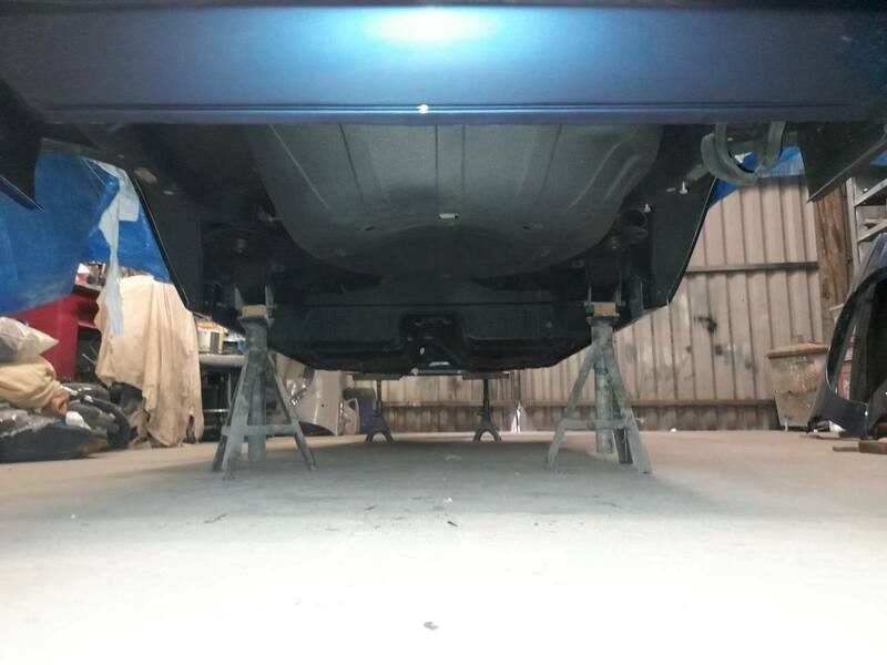

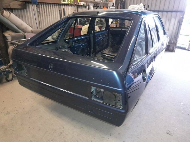

The time came for the body to part company with the dolly this afternoon.
20210910_154025.thumb.jpg.25c15cc48665b29a10ee40cd2f4dfcae.jpg.de0c2ebfa95e4de3a5011c72fc724dee.jpg

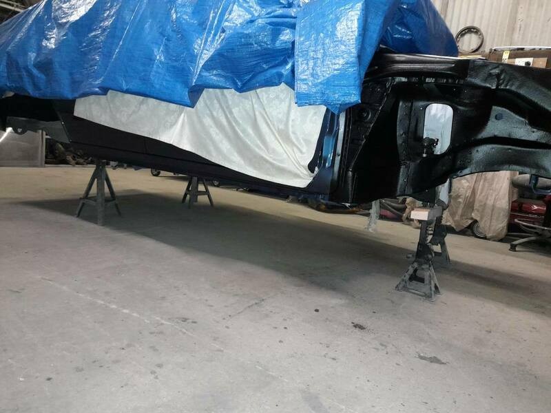

This left it on axle stands, but in the wrong places to be able to wax the underside.
20210910_154128.thumb.jpg.49ec8b83c980b4d5951d8091a63909bd.jpg.26e3c15737fcac3fdfb66e355956c96d.jpg

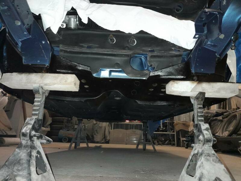

The front two were on the front cross member,  the rear two were on the spring seats with a piece of oak spanning the two. After a fair bit of a faff, the axle stands are now in the correct places (back where they were before it was sat on the dolly) to facilitate an underbody wax fest.
20210910_171150.thumb.jpg.406a859fad469ecb4ee8bad4f91307d5.jpg.7b8fc31df0c33ad4c69f9382b65e8f28.jpg
The tape comes off easily in big sheets, as expected.   :)
20210910_172451.thumb.jpg.bc504010161e9e679e1db3ae611e0072.jpg.97830ff15297062e94191dfff7cdc07f.jpg

20210912_161000.thumb.jpg.fe2a919c55b0d1a624f87c14d4a1dadc.jpg.4d454b937936ad9426ab635d258d1913.jpg
The rear inner arches were done next, preparing me for the misery of lying on my back getting showered in wax mist.
20210913_194052.thumb.jpg.f4c8d6974ddc526e771b66363ec47db6.jpg.1be8e92973a9fb9060d70aa041d6b98a.jpg

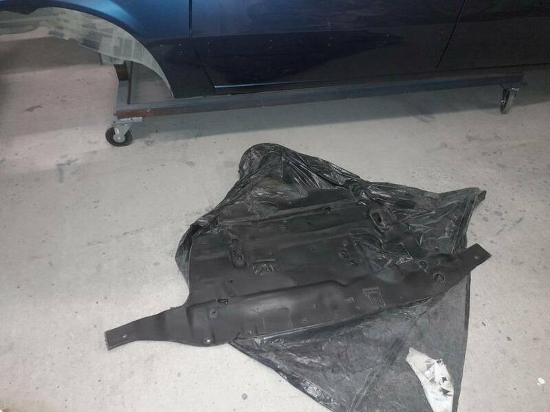

I called it a day before doing the underside proper - I'm planning on using some old throwaway clothes when the time comes as I'll be wearing a fair amount of the wax by the time it's all covered.  :(
20210913_194238.thumb.jpg.cdb146597407492656ce2174f2abeea7.jpg.eac3eaaa36df9c15524ebcb56cc8f02e.jpg

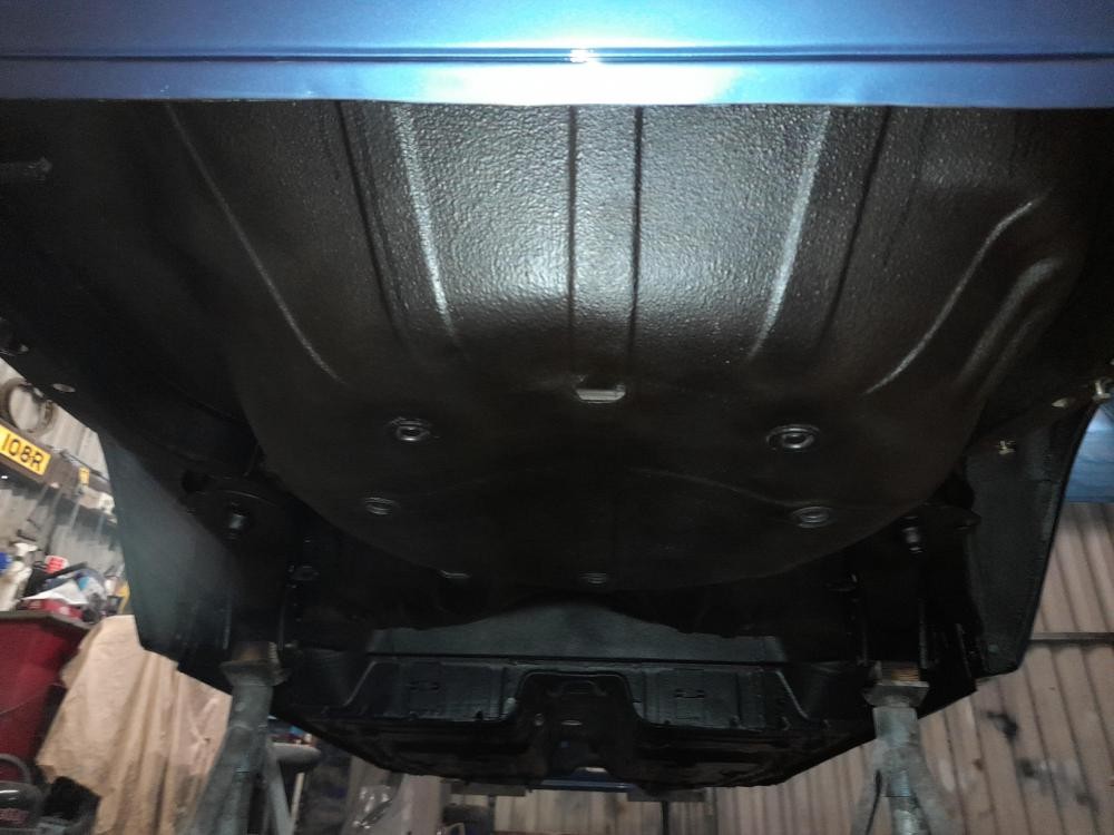

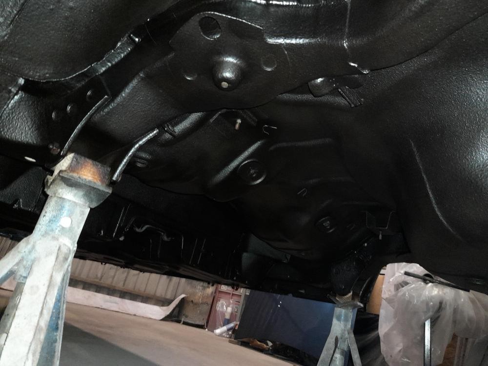

Another one of those less than pleasant jobs done this afternoon - the underside is now sporting a decent layer of wax.
I masked up the lower bodywork first to avoid having to clean any overspray off it.
20210917_142624.thumb.jpg.ab6d301b79422dd19b5456fb51326bae.jpg.a1ef76c265df2787a4eeb8609424016f.jpg
A couple of hours was then spent unloading the cans of Dynax UB onto to the entire underside.
20210917_165418.thumb.jpg.04af4c8f0484eb332984884135e0c786.jpg.16aeedbbae3b5c2160ac5fd41269d95e.jpg
20210917_165115.thumb.jpg.b2fc819e9886b2692e679035e2e36f24.jpg.e417fd2c893ce62a297279196a417ebb.jpg
20210917_170905.thumb.jpg.e7a53d31d3e883c410d20a07306180a9.jpg.a2375e0e8640fc20c6c724561326e81f.jpg
20210917_165527.thumb.jpg.90bd62c5a84158a9363ae43c4da7b968.jpg.1ee7f67510c16fb23f6d8d542db8ceda.jpg
I'll leave it to harden up a bit, then I can start putting the brake and fuel lines, tank  etc. back in.   :)
