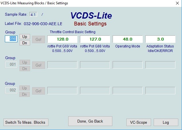

no vcds wouldn't allow it. for some reason i could not clear all dtc's. Then when i went to throttle control basic settings the top right dipslay doesn't say ADP run or ADP OK it says "3" i think. i'l go run the vag com in a minute to get a screenshot of the basic settings i get for you

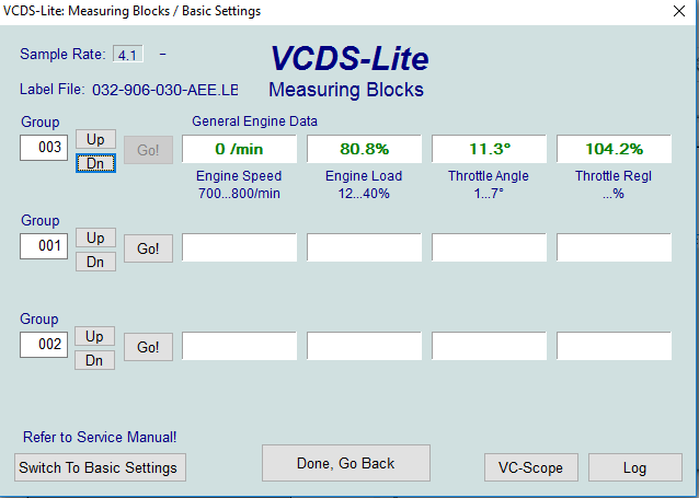

kingtaco94
here, hooked the up VCDS, for some reason the butterfly had stopped fluctuating and has settled again. but still can not run the Throttle Body aligment. And i met all the test conditions before checking basic setting 098, coolant temoerature, clear all dtc's ect.

nige8021
If you can't get the adaption to run, sometimes you can get the ECU to learn the throttle positions by going for a 30 min drive and with varying loads on the throttle including a few, flat to the floor with the pedal
