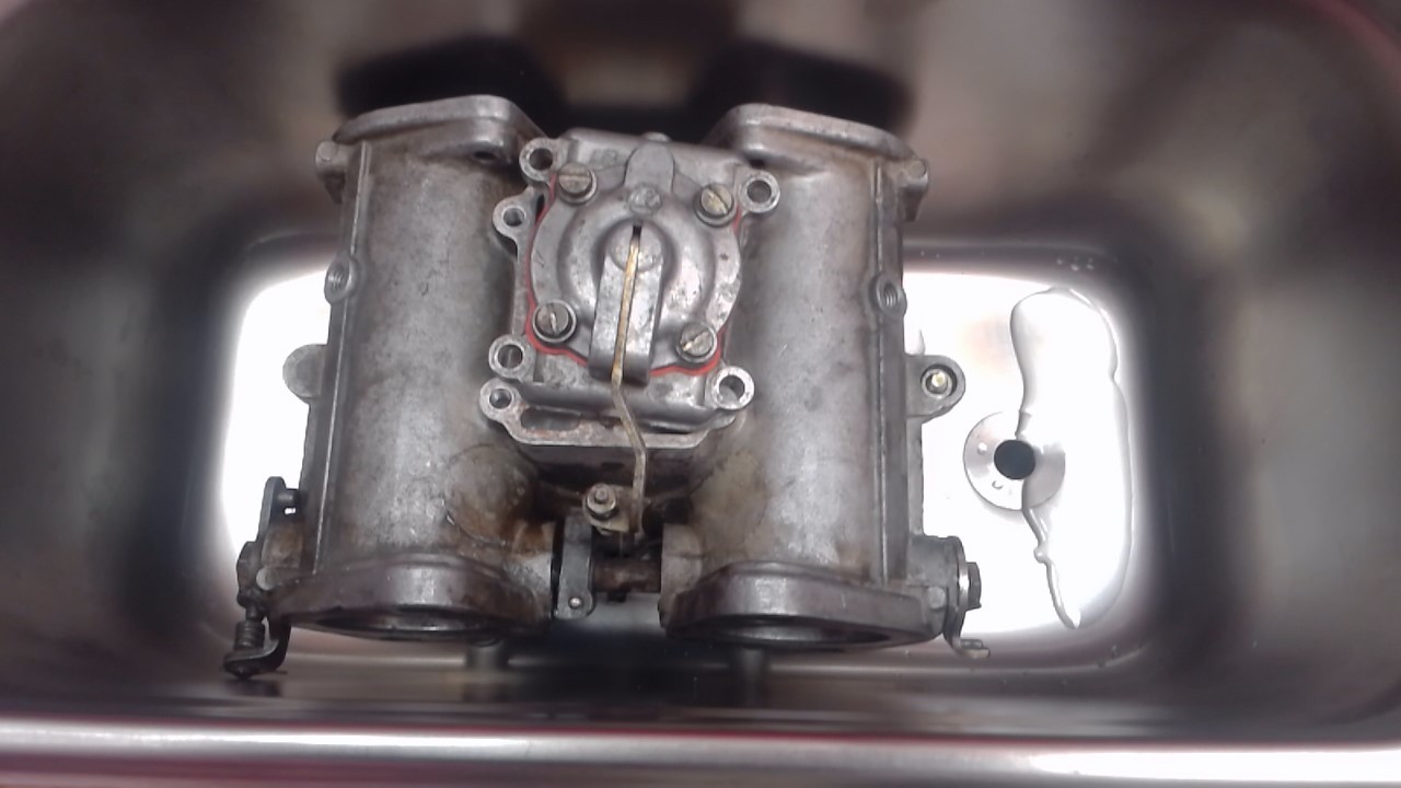

Took carbs off and apart. This is the pump chamber.
scraped it out
and this is the carb in the ultrasonic cleaner.
before adding the fluid to heat up and buzz the dirt away.
  • Like 1
