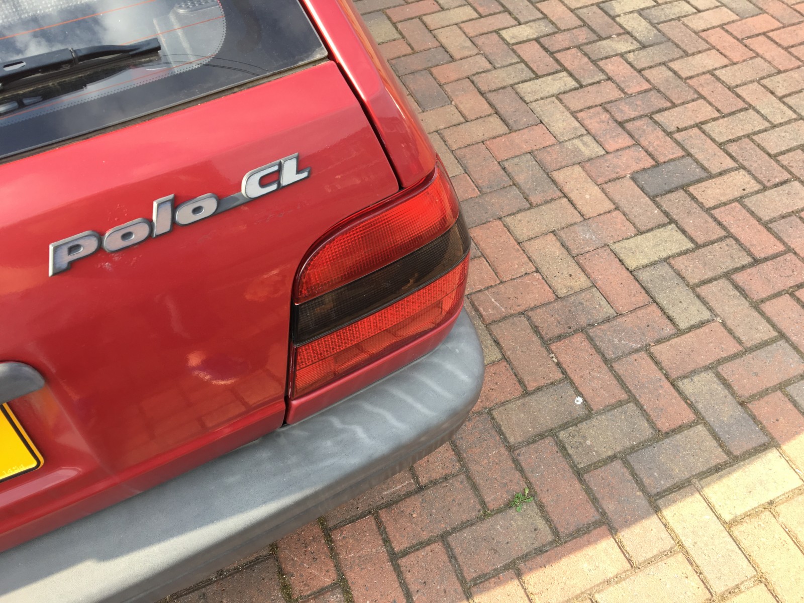

taylor
Gt rear lights
Share this post
Link to post
Share on other sites

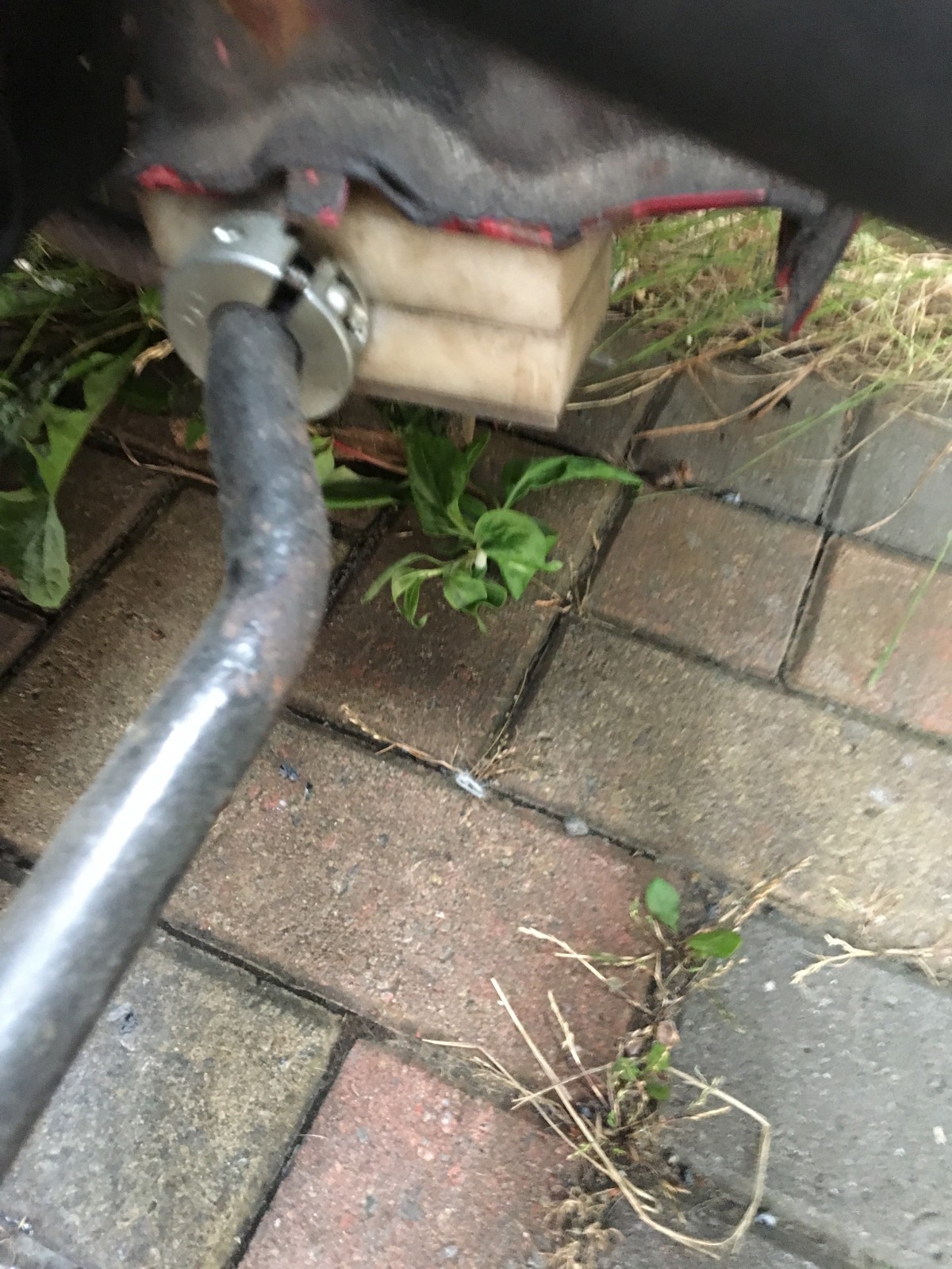

taylor
What’s Going on here what’s the blocks for?
Share this post
Link to post
kiran_182
They are the poly arb blocks, used on a lowered car to correct suspension geometry and keep the arb from rubbing the exhaust

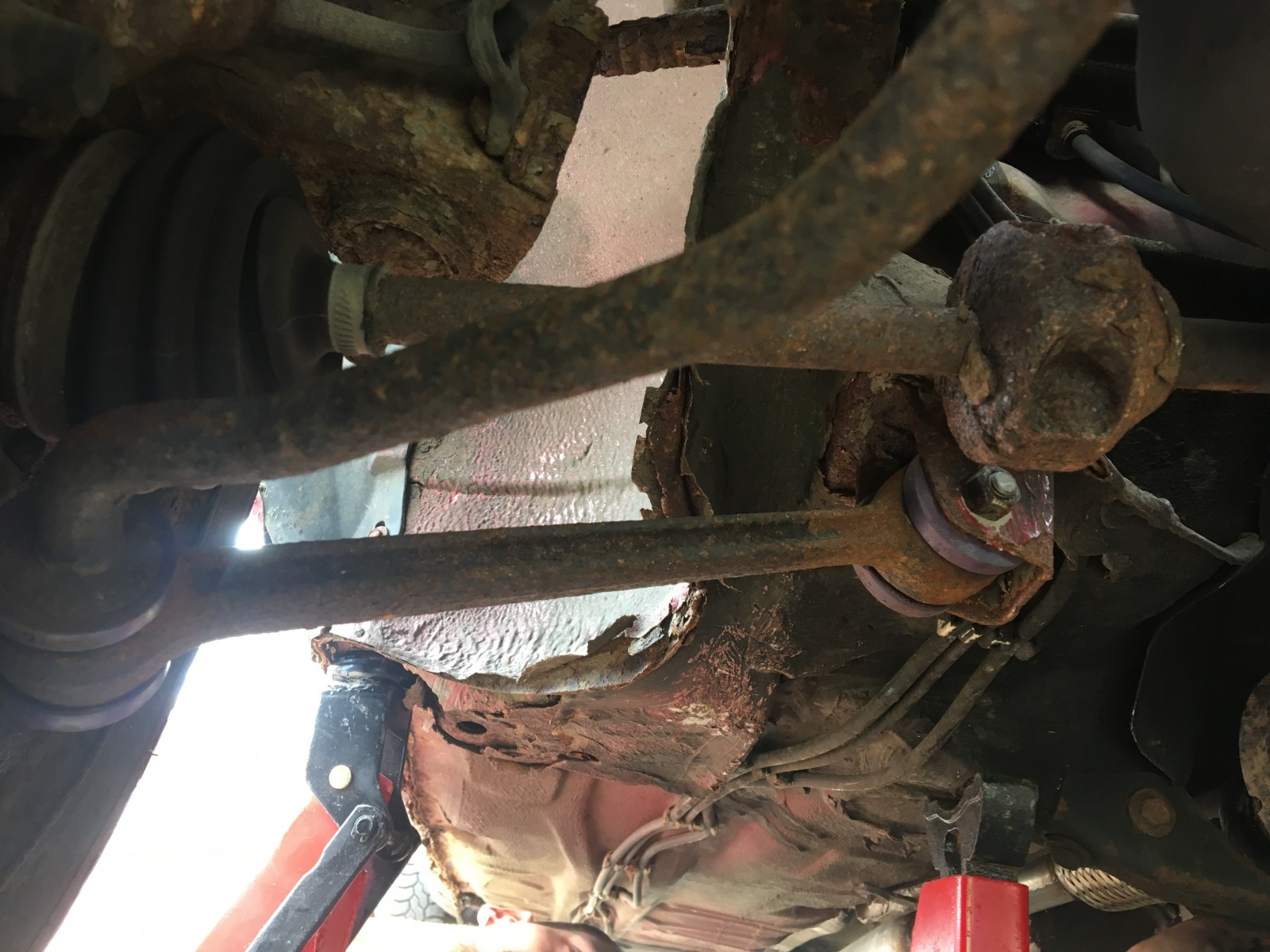

taylor
Found a few extra goodies on the breaker
polly bush lower arms

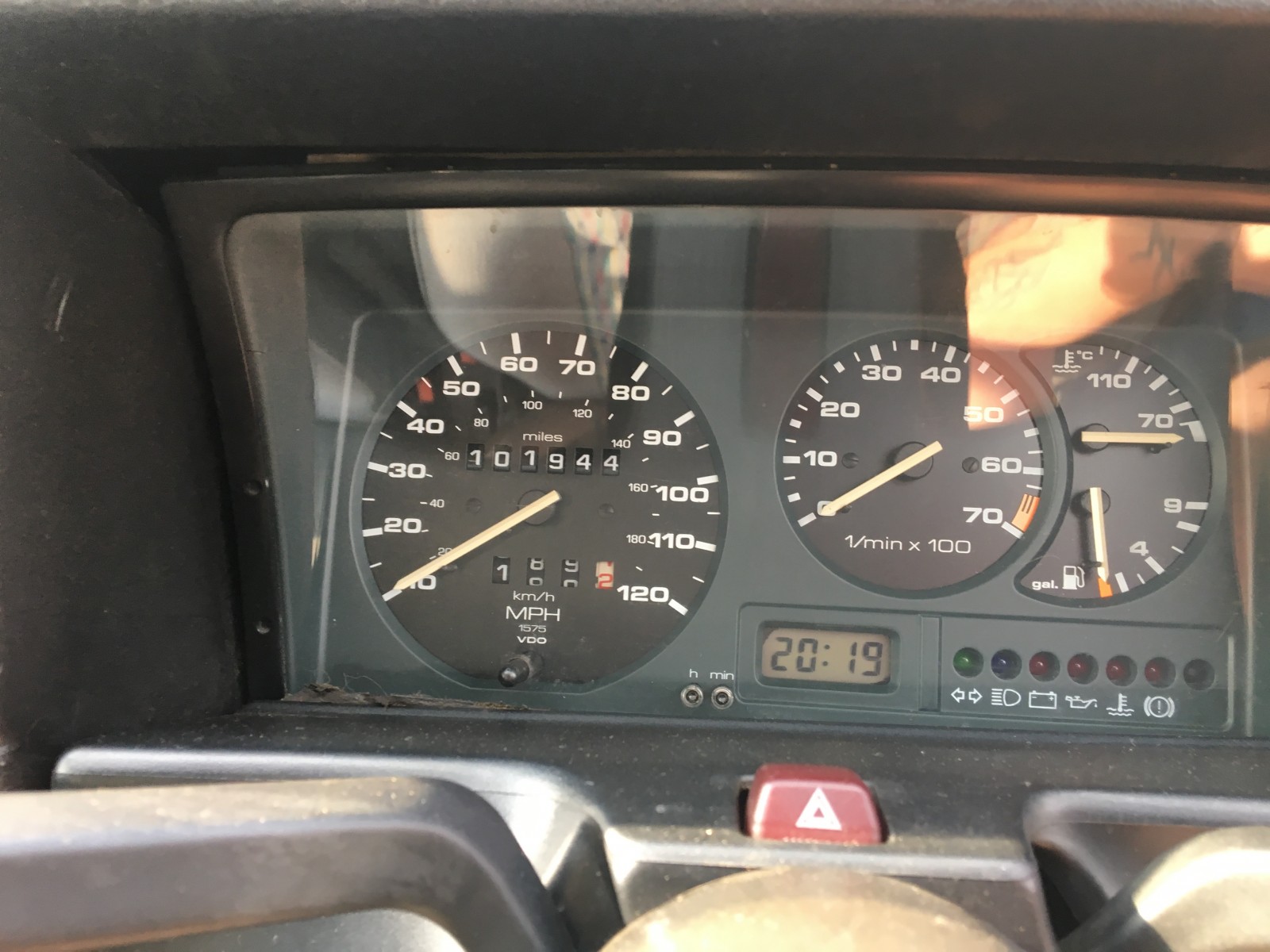

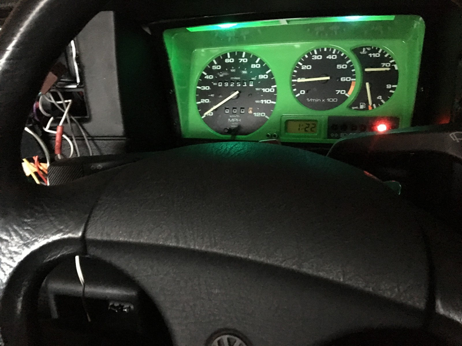

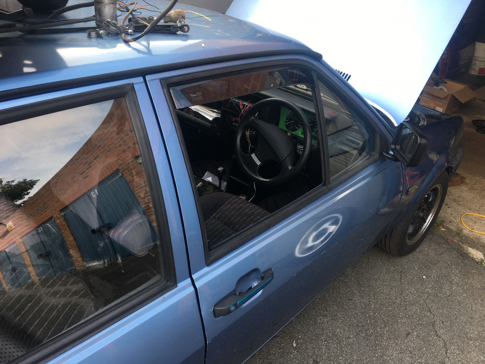

taylor
Finally got round to doing a few bits on my actual project
fitting new window regular to passanger side door
and fitting a set of gt clocks
Share this post
Link to post

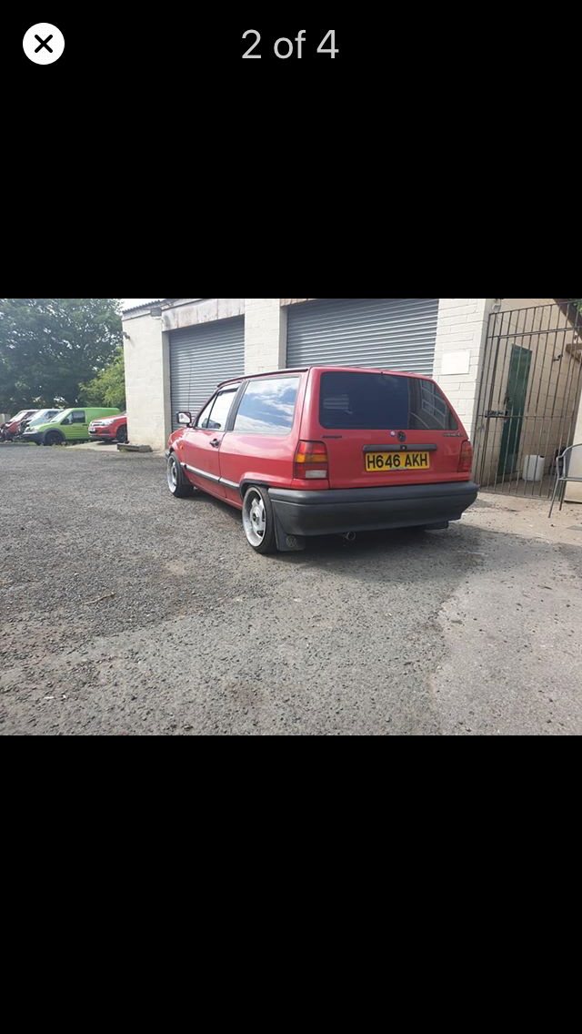

taylor
This one is a breaker aswell only keeping alloys and gearbox everything else is going
Share this post

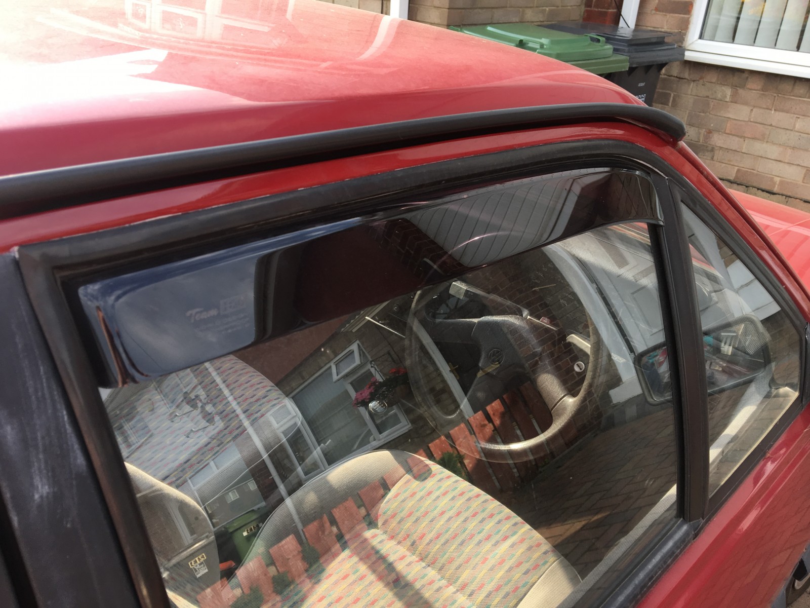

Well managed to get windeflectors in
Share this post
Link to post

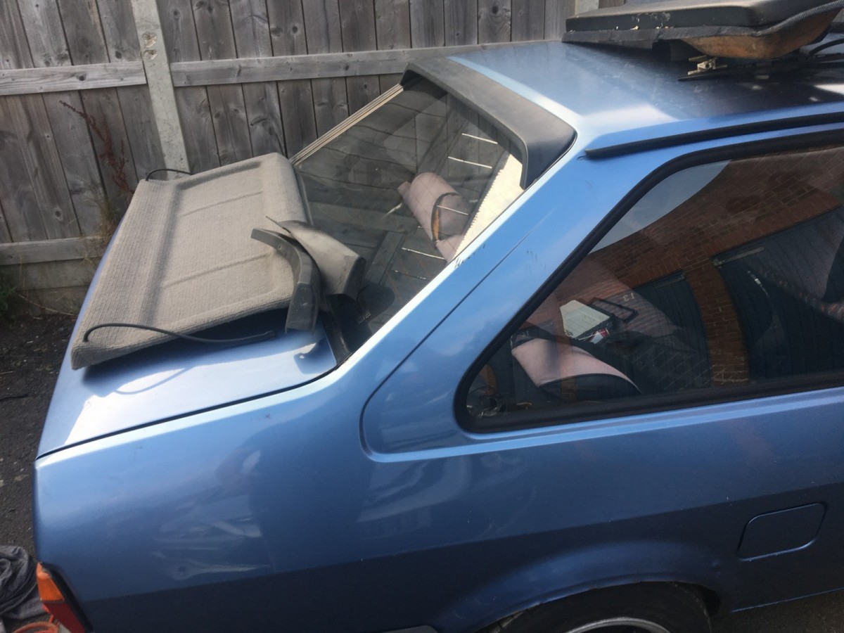

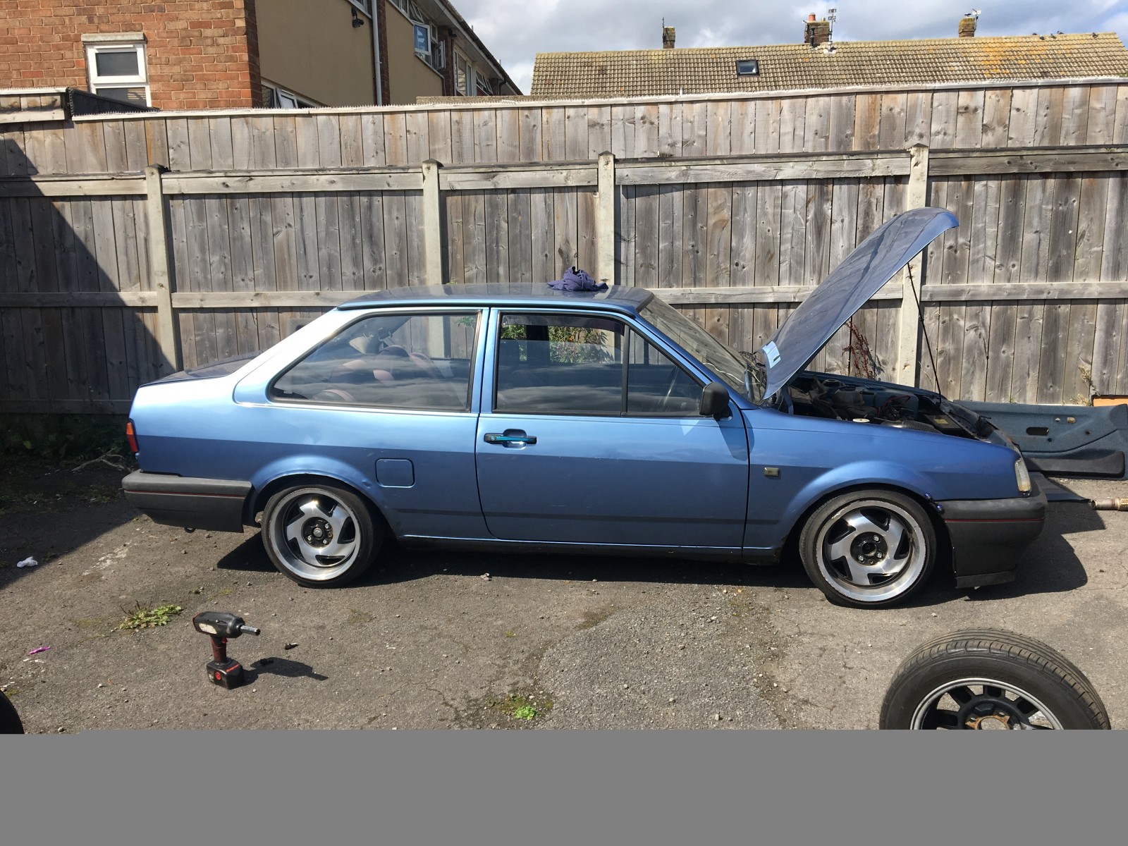

taylor
Also tried the coupe rear spoiler on for looks and looks like it maybe a permanent fixture what do you all think?
Share this post
Link to post

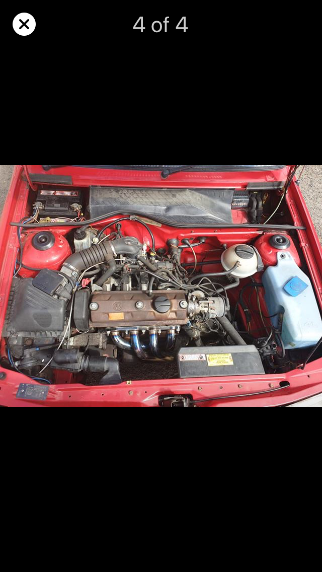

kiran_182
You can swap that mpi setup on to your engine no worries
Share this post
Link to post
taylor
What’s the advantages too it bud?
and what would need swapping full loom?
Share this post
Link to post
taylor
Is the mpi set up the one in the bread van I’m breaking?
Share this post
Link to post
kiran_182
Yeah, loom ecu dizzy inlet all of it air abd fuel related, keep your fuel pumps as theu are the same
More power and tuning options is the benefit, take the 421 too
Share this post
Link to post
kiran_182
Get the wheels from the breadvan advertised on the mk2 scirocco fb page or mk2 golf, they are aluline turbines
Nice wheels
  • Thanks 1
Share this post
Link to post
taylor
Nice wheels
How much roughly do you think I should be asking?
Share this post
Link to post
