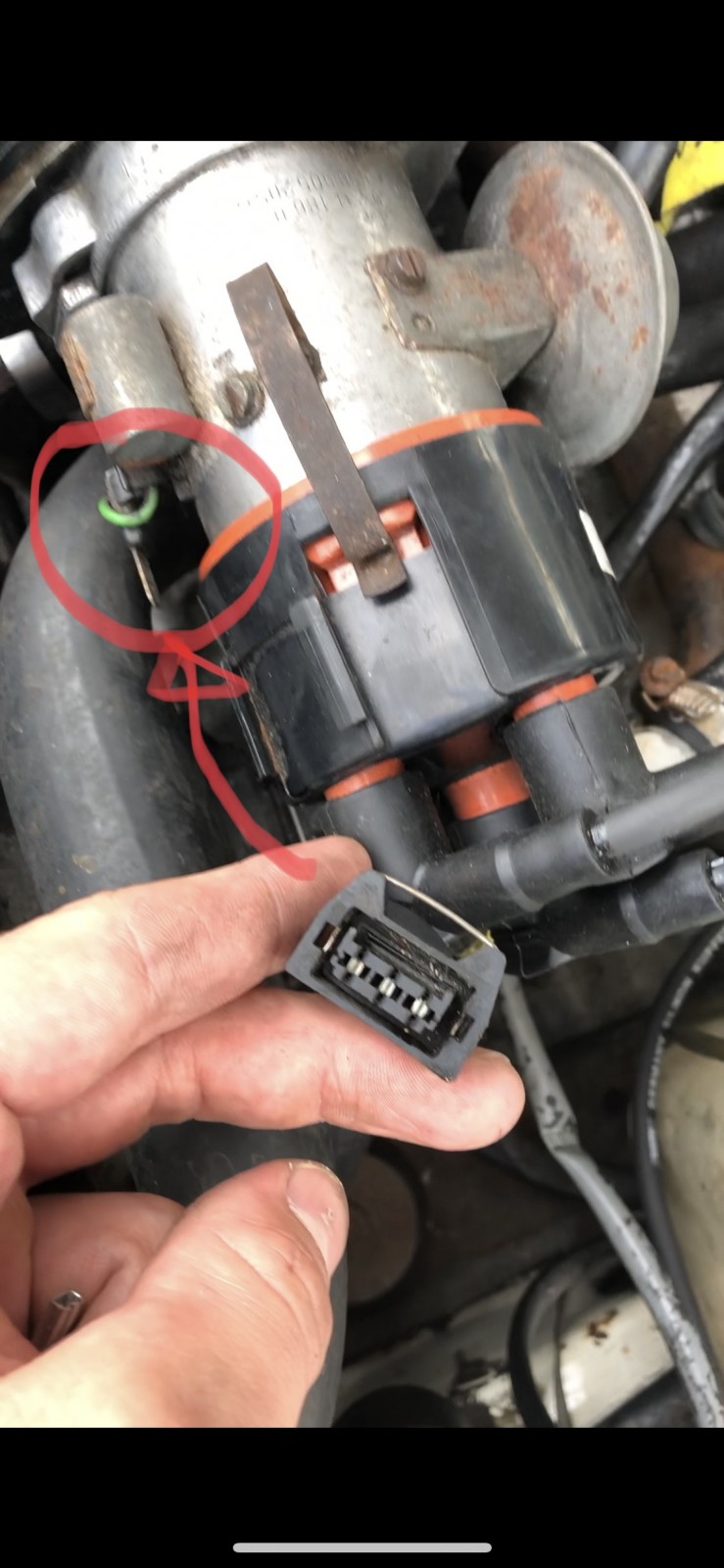

Hello just wondering if anyone can help,
i have got a 1989 mk2 polo coupe S, I recently did an engine swap for a mk1 golf 1.3 on suzuki bike carbs. The only issue i am having is getting the original polo ignition loom to work with the mk1 golf distributor as my polo was originally electronic ignition and had a 3 prong plug where as the golf distributor is points and condenser with just a single plug (shown in picture) i have tried swapping the distributor but it does not fit and i am not able to swap the plug over on the distributor housing. Just wondering if anyone had a solution to my problem👍🏼 Thanks in advance!

16 minutes ago, steveo3002 said:
get the later dizzy ?  would be correct for the age of the car then
I have the polo dizzy but the inside part that connects to the cam is completely different

caretakerplus
Welcome to the Forum.
If you wish to keep the 'points and condenser'  distributor, it would pay to fit a 12volt coil, connecting the positive (+) terminal to the ignition switch wire and the negative (-) terminal to the terminal on the distributor.
