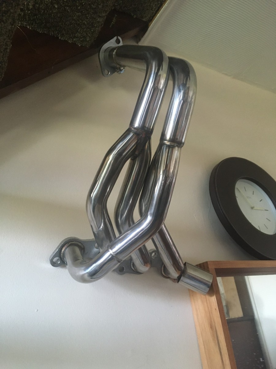

Thanks for the help! No the exhaust on it was fitted in the last 5 years so it’s still good, I just wanted to get better flow/ accommodate future mods/get a better sound.
I already have a 2” stainless manifold, so I was wondering if there was an easier way to get an exhaust thats 2” all the way, than having to fabricate it myself / find a tame welder.
...yes it is currently hanging on the wall
