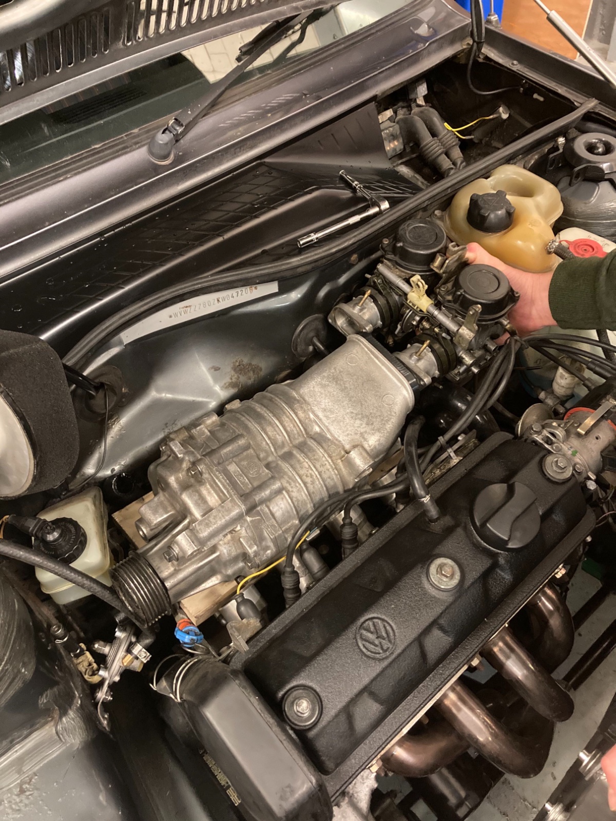

Time for some boost,

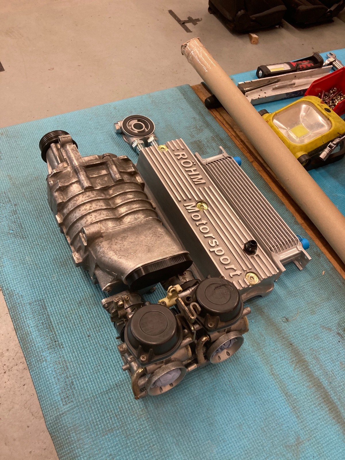

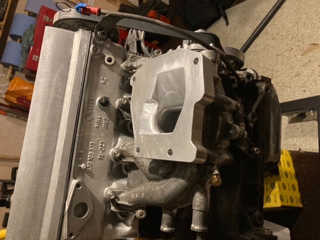

eaton m45 charger from an r53 mini.  Carbs from a Yamaha tdm850 3vd two stroke motorbike.     Plan is to use a GK inlet manifold with an adapter plate to fit the charger on top.    This will be a draw through setup much they they have commonly developed for the classic minis. I’ll be making my own manifold to fit the tdm carbs to the charger intake.
engine will come out after I’ve made all the parts so I can prep it for boost.  Aiming for around 150hp at the wheels

 my plan was to use my old support bracket as a rough template and make an adjustable rose jointed and aluminium hex support, that picks up from the same points.     Reason for the adjustment is the bracket might pull the gk manifold as it’s not original to the mh engine.

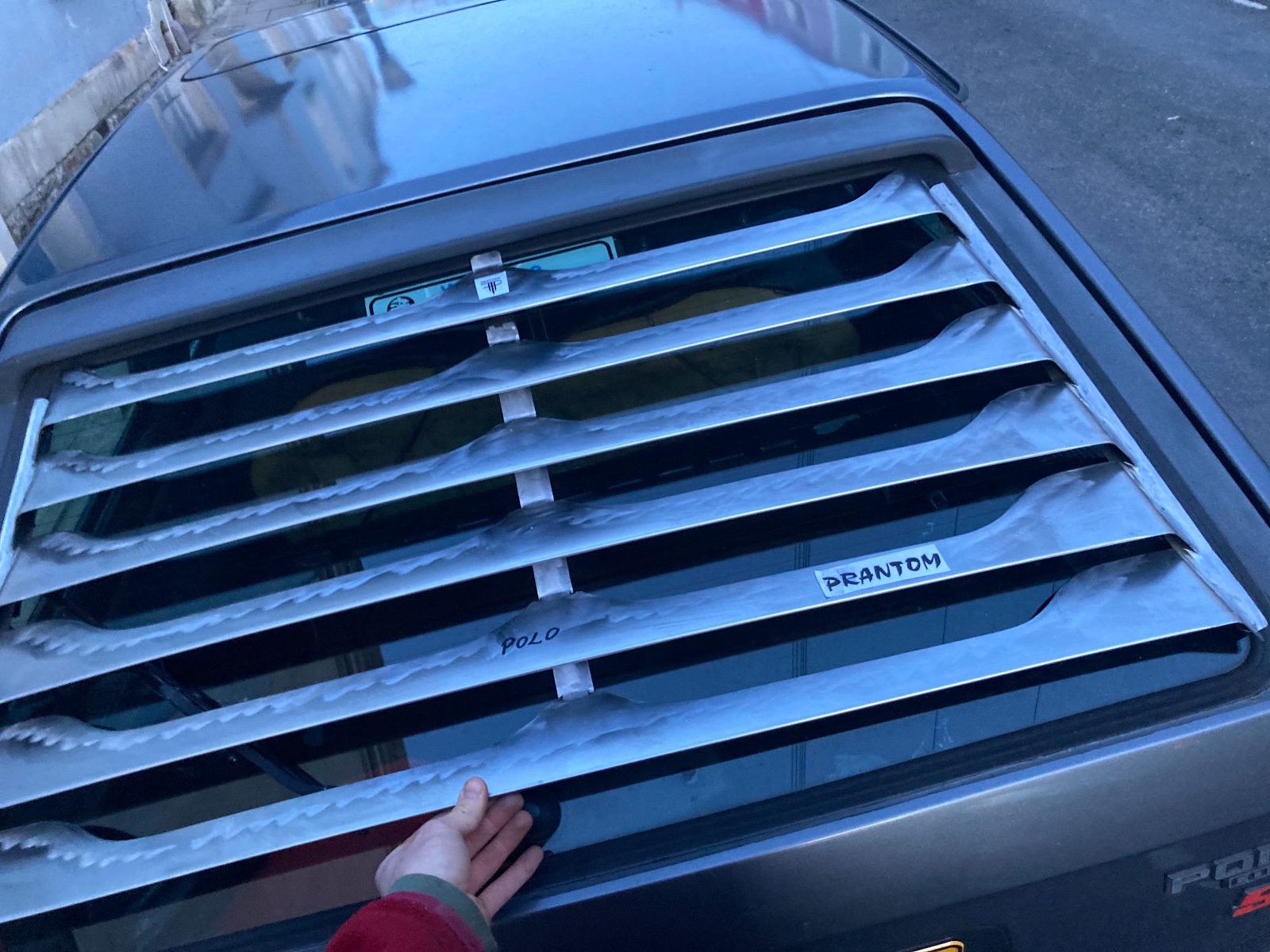

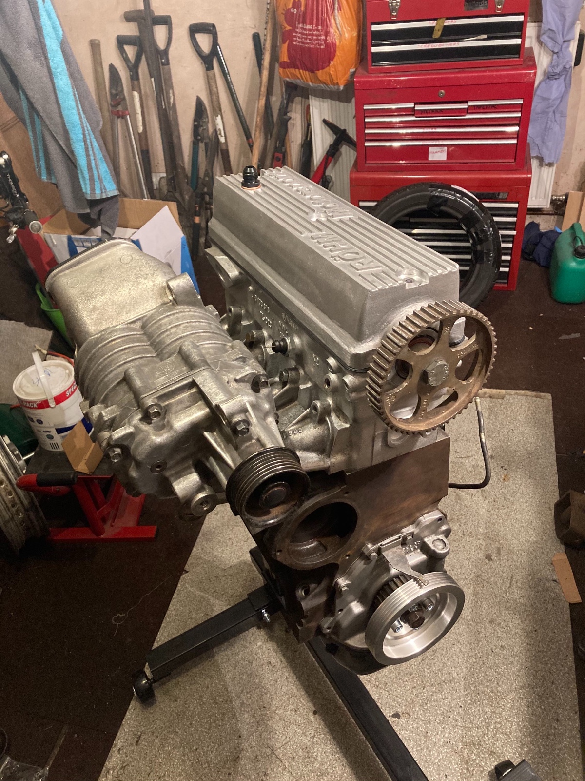

Little update,  scored a g40 (PY) engine for £200. The cylinder head shown is just an aav for now.   Also some rear louvres from Poland, I’ll get them crinkle black powder coated.   G40 will be fully rebuilt before I fit it to the car; however I’ve still got a lot of machining to do.

wow amazing louvre! is it custom made?
block is looking great, i admire the dedication to the project !

Cheers man,  the Louvre is made by a company called prantom from Facebook

that's awesome man! did you just buy it out of stock? might wanna cop one for my polo too!! :D
can't wait to see a pic of it once it's spray painted !
