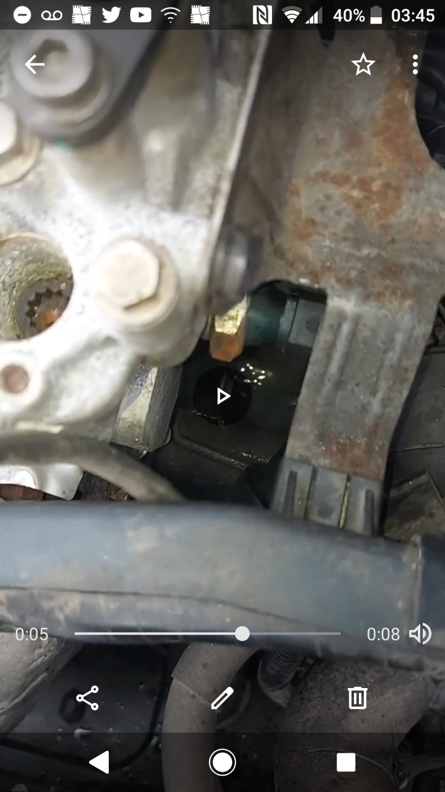

So all gone to pot, had car recovered yesterday, heard clicking noise from engine and think gasget gone, this looks like might have been from head recon rebuild, could it be was not bolted on properly? Was told could be crack in engine or head? Mechanic looking at it today, I'm fed up with this and waking up thru night thinking about it... Video attached... Can't attach that but from this area... Pic attached...

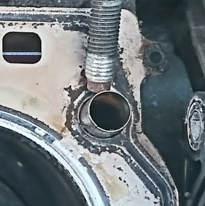

We discovered one of bolts securing head was not torqued onto engine head (was seized when head was broken down so thread was damaged when unbolted)....the pressure test confirmed as leaked thru bolt...we could have put in thread insert but mechanic said we could not? Pic attached...leaks from other areas too...

Is that photo from a new disassembly of the head? If so, that head bolt looks like it has been re-used, and not even cleaned up prior to refitting.

Thats the old bolt that was seized, new bolt was used when recon was done.. Im just wondering and assume that bit sticking out is the locator for head and if a thread insert could have been used, I was told it couldn't due to its location... The new bolt did torque but  ow failed, rebuild was done back in May..

So here's the end to the story, the bolt on head was not torqued or it was, thread insert could have been put in when was told it could not due to dowel... Will add pic below... So leaks from bolt and think gasget... Think said had coolant leak before recon was done... Enough was enough, sold for 400 to We Buy Any Car... 2006 Polo was great runner but when bought was told should not have... 1.2 litre and changed timing chain too... Money pit.... Done 105k miles... Make sure change your oil more frequently I was told for timing chains...
