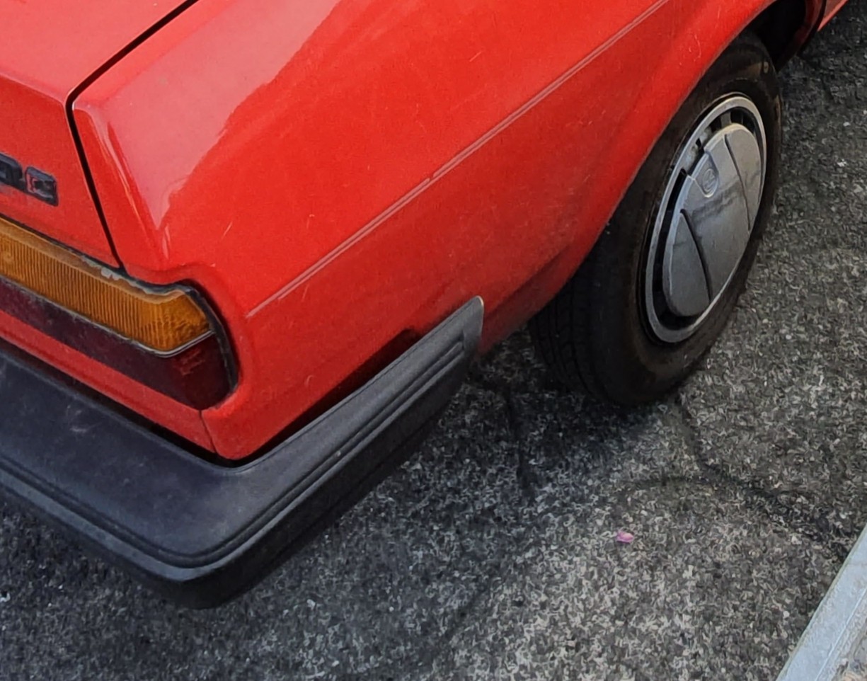

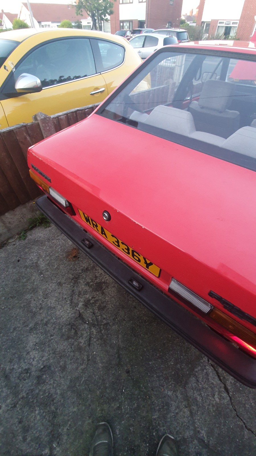

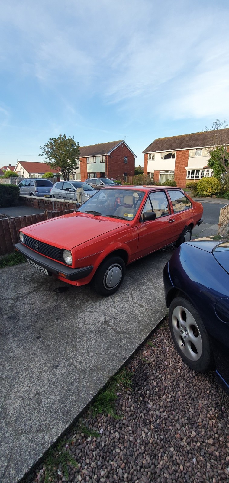

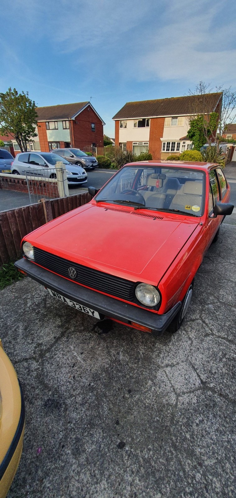

Introducing my build thread! I bought Phoebe back in April 2020 without even viewing the car. A friend of mine has been ro view the car a few months earlier but the price was too high so he walked away. After some late night (potentially influenced by Carlsberg Export) Internet searching, I agreed on a price and got it trailered to me.
Generally speaking it is in decent condition. Its currently sat at 69k and has a 1.0L engine and 4 speed box. I drove it for a few months and it was great to be back in an old vw again.

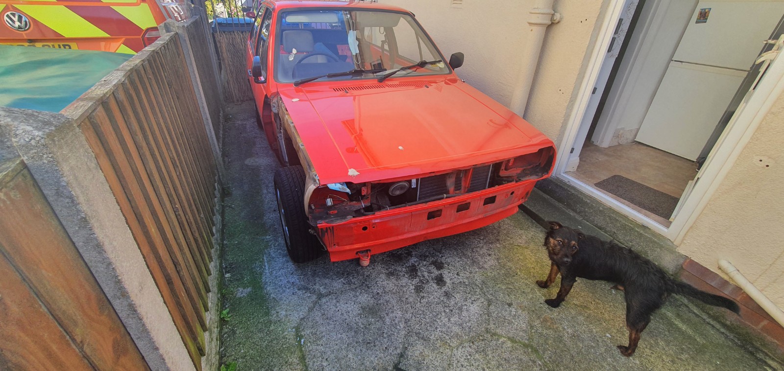

So Phoebe is now off the road and the teardown begins. Im basically searching for rust and so far its remarkable how little I have found.
Heres the plan for its first build:

Looks like a great straight solid  car to start with 🙂
Happy days, easy sorted! The metal was definately better in the earlier MK2s
Its pretty solid yeah. Just the battery tray has rotten, bottom of both wings , a little bit near the fuel tank filler and all the arch lips. Not bad for 38 years old!
