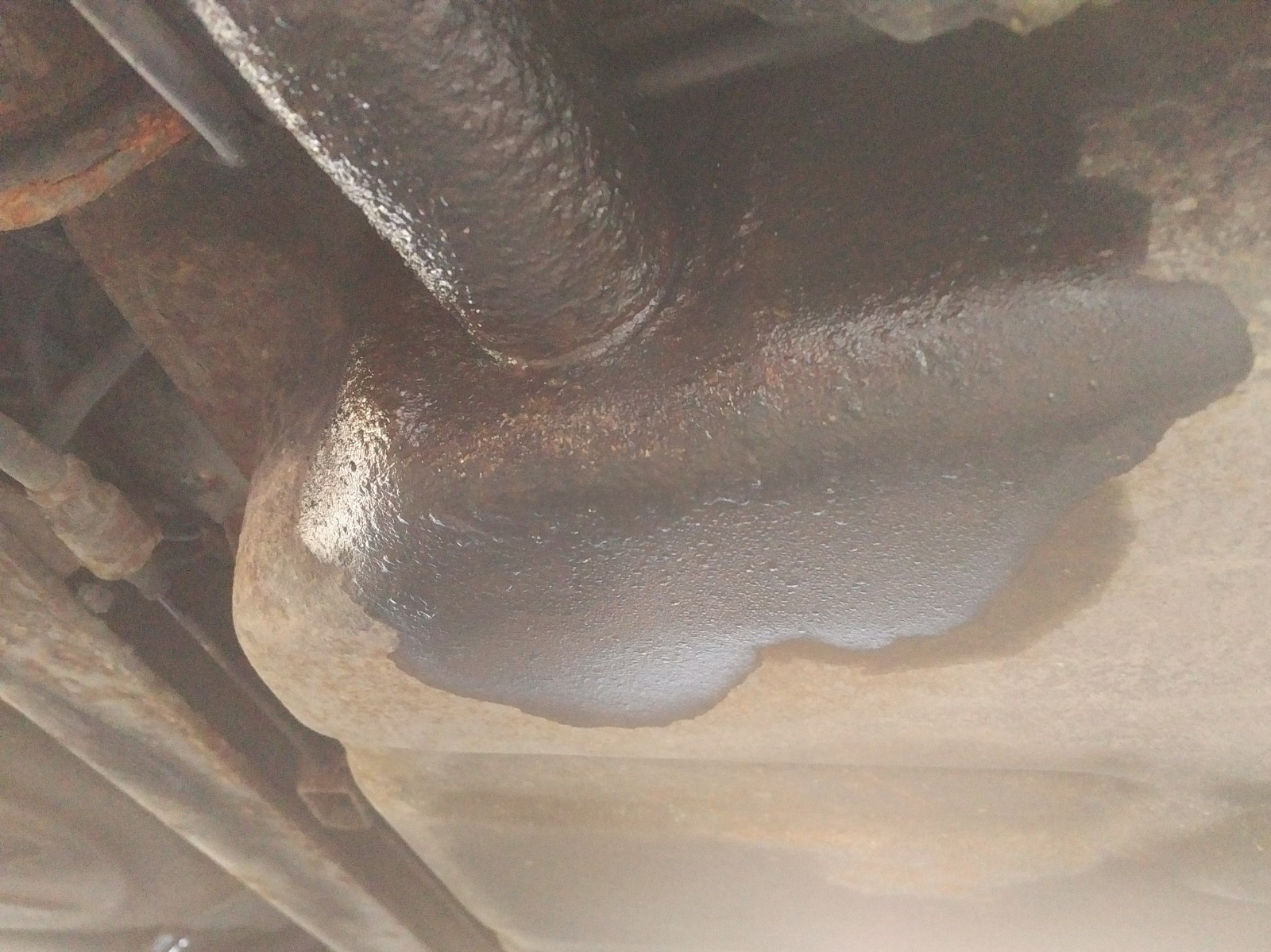

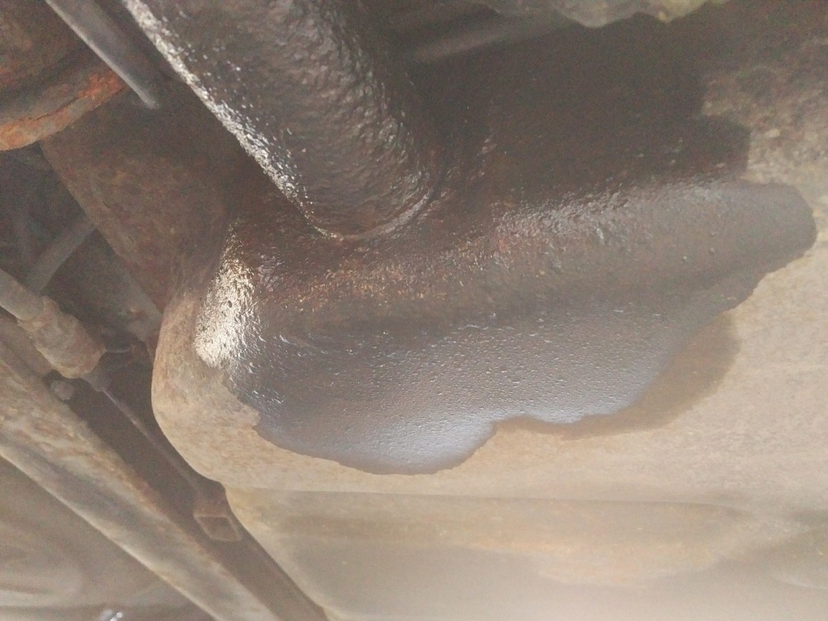

Its finally happened - the original old tank has started to leak. Must be a pinhole somewhere on the filler neck or at the weld join with the tank
Unfortunately I don't have anywhere flat I can properly work on the car for the time being so replacing the tank will have to wait a little while. What would be best to use? I'm thinking a clean of the area and then talc/flour to locate the hole first. Then some sort of fuel-friendly filler patch to bodge it in the meantime?

Granville Petro Patch will work for a month or so until the next pinhole starts if you can locate the leak (wipe with kitchen towel shake flour on, lift near side of car), then drain and let it dry.

Was just reading your old thread on that! I'll grab a tube. Thankfully the parking situation outside my house has the fuel sitting on the other side of the tank which should help eh.

Right, got a tube of Granville petroputty, a new tank and some 2k epoxy primer. Plan is to attempt a bodge with the putty this weekend in the hope it'll hold until the current restrictions get a bit better and I can do the proper work in a garage.

Just spent some time trying to find the leak with some talk - can't find it anywhere. It must be tiny and only appreciably leaking when fuel is sloshing over it constantly, couldn't get it to leak with a pot of fuel down the filler neck or lifting/dropping that side of the car. Just going to have to expedite getting the new tank in.

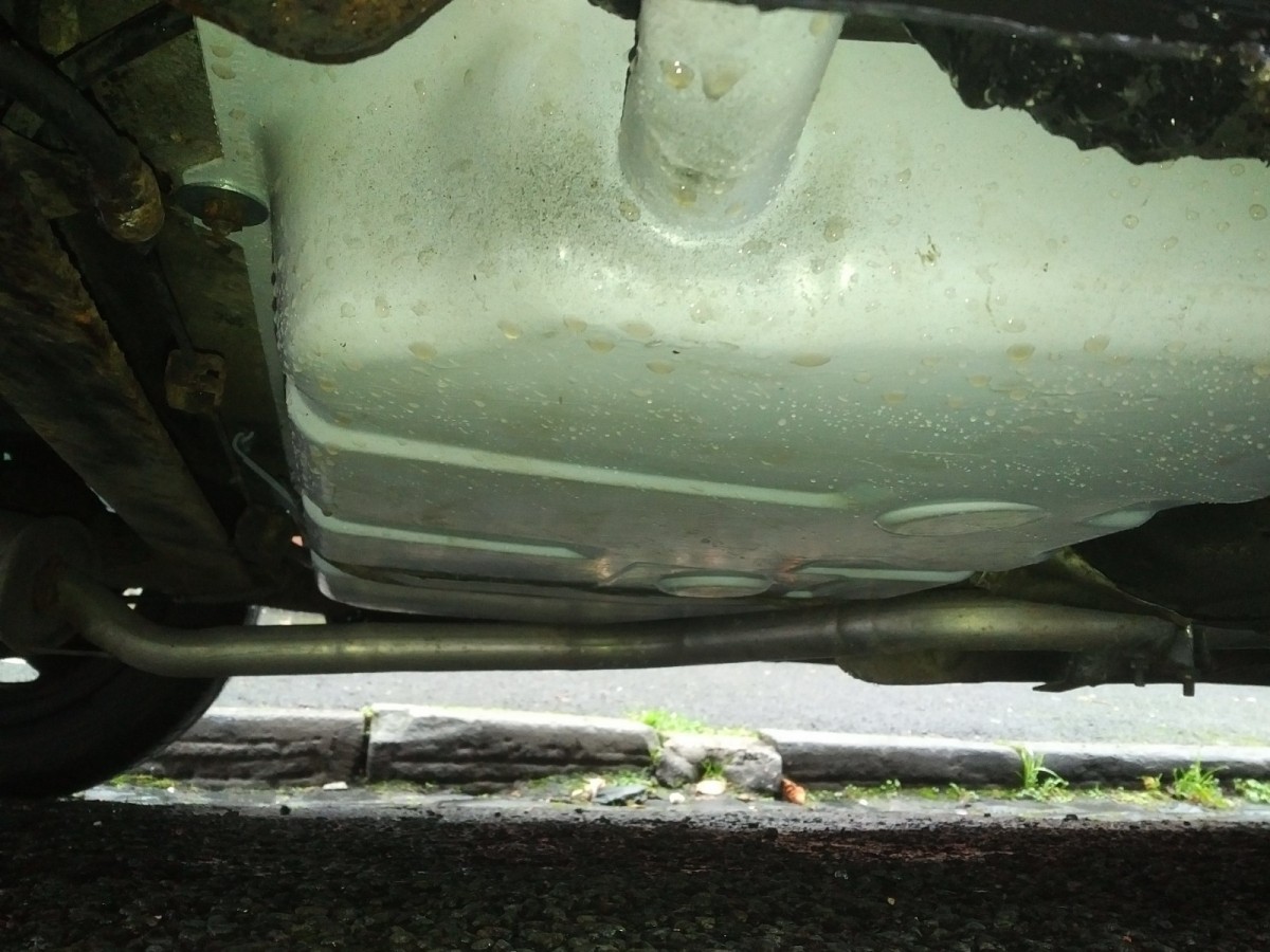

Got the new tank prepped and painted, looks fine but we'll see how it fits when it goes in eh! Bit concerned about that OS rear sill but nothing can be done unless the tank its out of the way anyway.

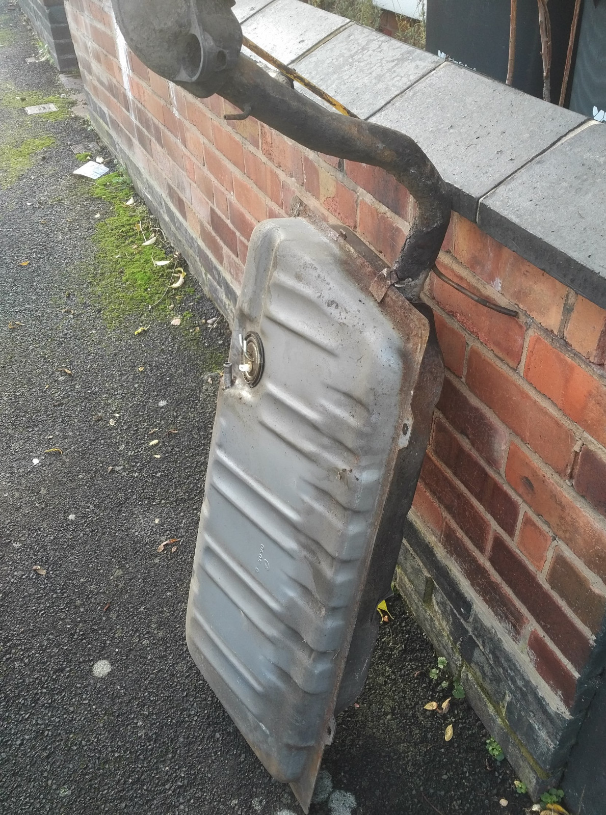

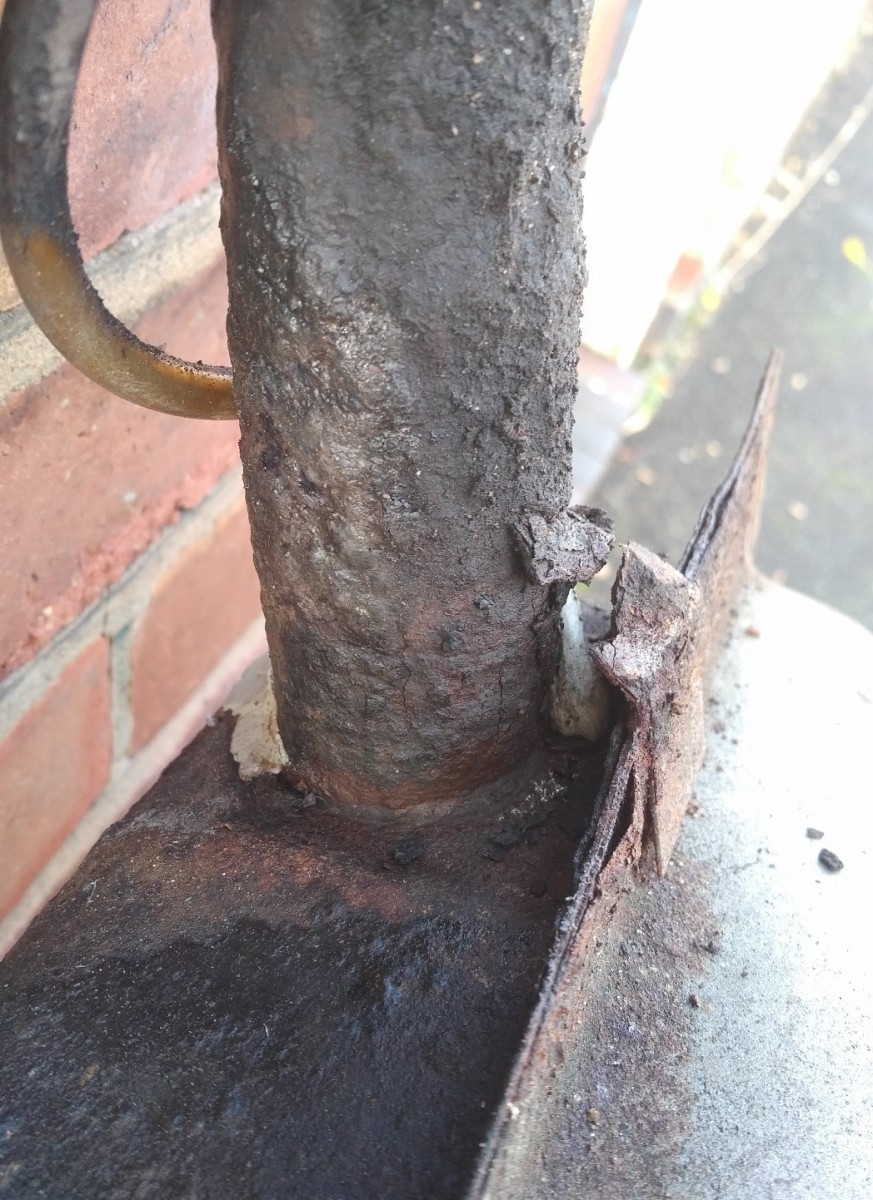

Well I managed to get the old tank out - considering I did it with only one wheel off the ground isn't half bad I think!
However I couldn't take all the fuel out and once the filler neck started to flex it began to leak like no ones business. The join between the neck and the tank is all but rotted through at the top. I reckon some crud was the only think keeping it to a dribble..

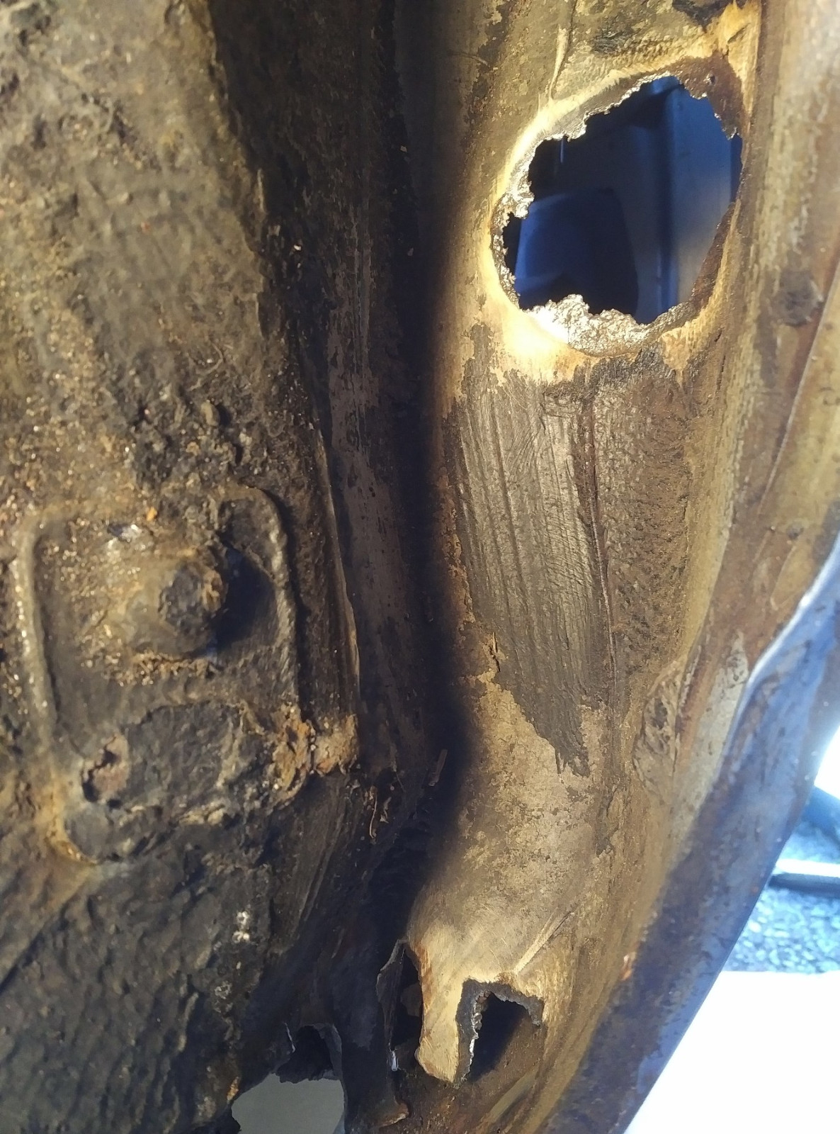

Unfortunately life must be in balance so after celebrating not self-immolating myself and getting the old tank out I cleared out my old bodge around the hole in the arch from the dreaded fuel return line and found the area at the bottom of the arch that was covered by the filler neck is a right mess
Not something I can do myself so Its getting trailered to some VW specialists next week. Likely cost a small fortune but seeing as its the only real rot on the car after 27 years is more than worth getting done properly.
For the fuel return pipe through the arch I'm planning on installing a runner grommet seeing as the original pipe design is impossible to re-do without having the outer panels off.

All done! Holes welded up and new tank in. The tank breather hose now comes through the arch through a rubber grommet and the OS rear sill has been re-fabricated.IMG_20201128_1335286.thumb.jpg.5f66c914326782cff996f2ea8128e40a.jpg
Should last a while longer now!
