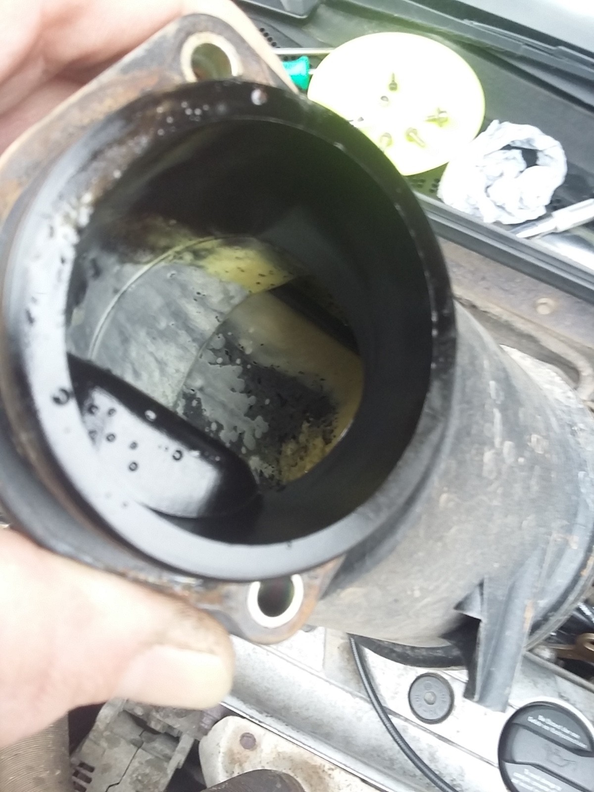

While i was there I took off the engine vent chamber below the the throttle body to find it had some yellow and white gunk in it (see photo). Looked like water and oil mix?. I cleaned it all out, dried it off and put it back on. I thought this chamber ought to have a gauze or mesh packed in it??
Any way, I am now wondering if this was just a bit of engine condensation or possibly a breech in the head gasket between a coolant gallery and one or more of the cylinders?
Coolant is all clean though and oil on the dipstick is spotless to.
Any Ideas anyone?
