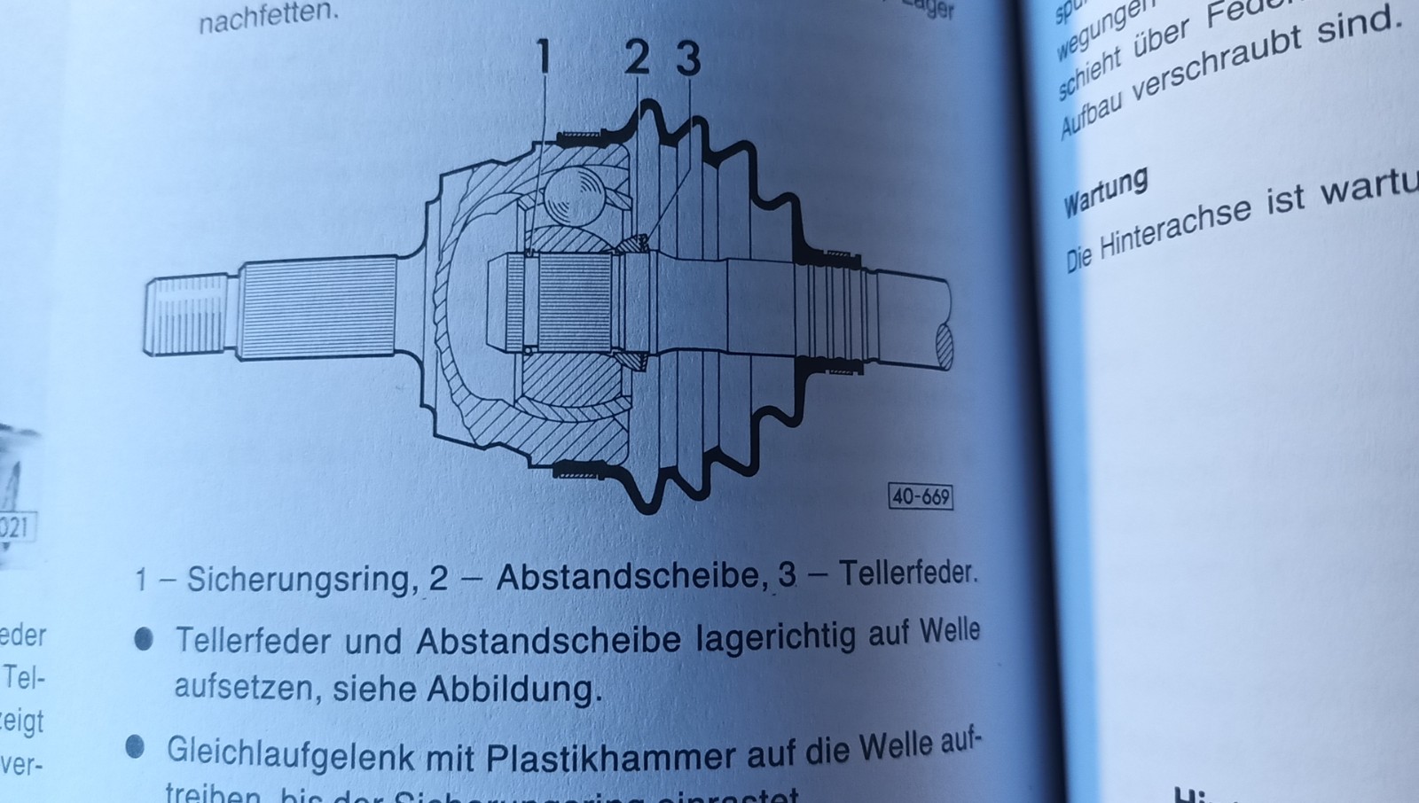

Okay apparently one of the cv joints was replaced but missed these two rings on the axle, that i did find on the other side. What is the function of these rings? Are they really necessary?

See Tellerfeder (plate shaped spring?)  and Sicherungsring (safety ring) on diagram below.
Stops the driveshaft passing further into universal joint.

Thanks for your search work! Number 1 was also missing ..... 🤨

2/3 act as thrust rings, to do as dvderlm says.
3 is the dished steel washer and 2 is usually made of a plastic material. You have to put the dished washer on the right way to match up with the shape of 2. You can make out the way they should be fitted in that picture.
If no1 was missing the joint could potentially have come apart with catastrophic consequences.  it’s a locking ring to keep the CV joint on the Shaft, especially when on full lock.
Normally you have to knock the joint off the shaft over this ring. CV boot kits should come with all these parts included, so they can be renewed when doing a joint overhaul or renewing the boot.
