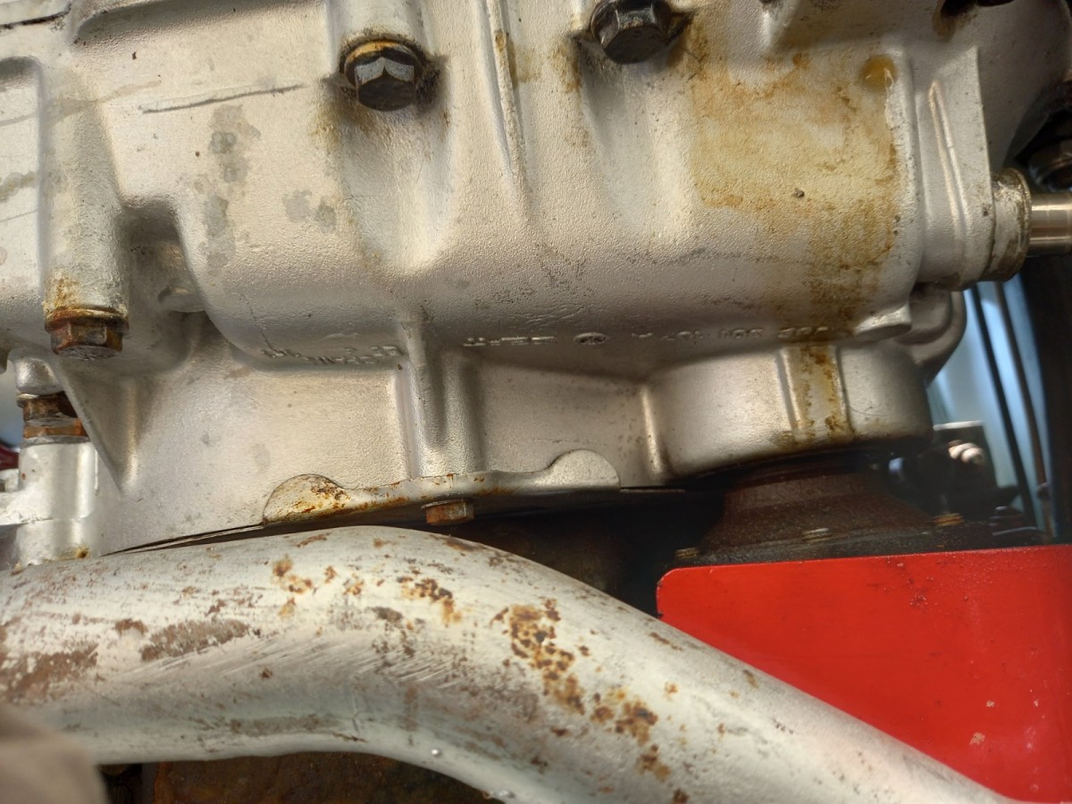

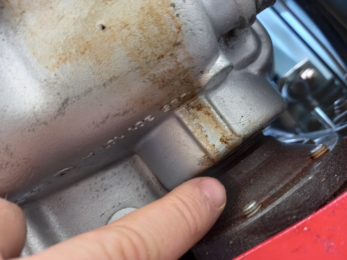

Hi all I have a leak on my gt gearbox from drive shaft I think ? Its definitely not from gear selector rod .Please look at photo. So anyone know the replacement seal I need please.
I'm hoping I can do it while box is in as I only have just put engine back in so it would twist my Mellons if I had to take it out again.

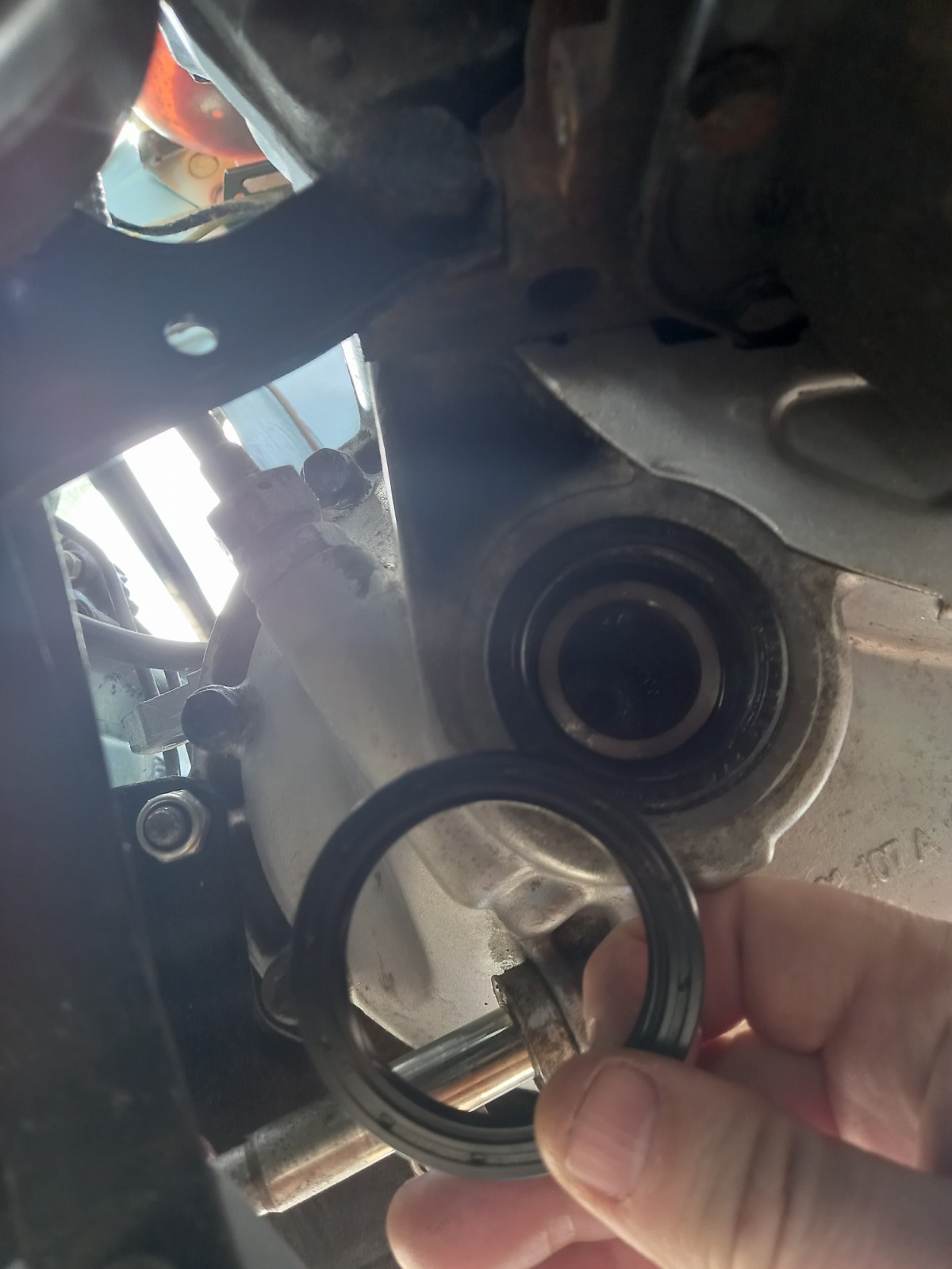

This is from the 085 instructions
Removing
  • Disconnect drive shaft from flanged shaft.
  • Tie-up drive shaft as high as possible. Do not damage paint on drive shaft.
  • Remove flanged shaft securing bolts, to do this screw two bolts into the flange and counter-hold flanged shaft using a lever.
  • Place drip tray underneath.
  • Remove flanged shaft.
  • → Pull seal out. Do not damage plate sleeve on right-hand side when doing this, otherwise leaks will occur.
Installing
  • → Drive new seal in onto stop, when doing this do not cant seal.
  • Fill space between sealing lip and dust lip with multi-purpose grease.
  • Install flange shaft, tighten bolt to 25 Nm.
Note:
Left and right-hand flange shafts differ. Do not interchange.
  • Install drive shaft, tighten bolts to 45 Nm.
  • Check gearbox oil level and if necessary top up to lower edge of filler hole.

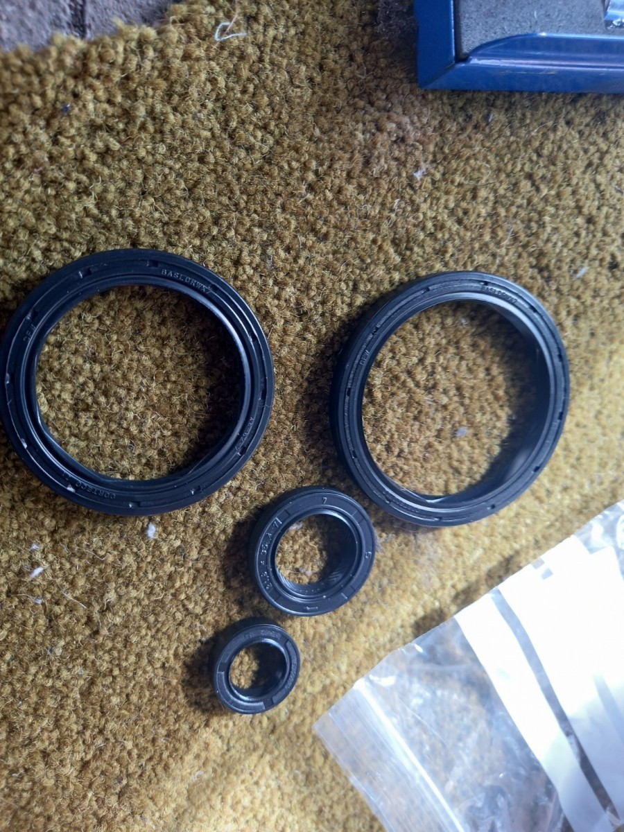

Seal kit from above link does not fit. I ordered it on the understanding from seller it will fit but not so . The seal i need is much smaller than the one I'm holding .
I will have to continue the search for correct one.
Help most welcome.

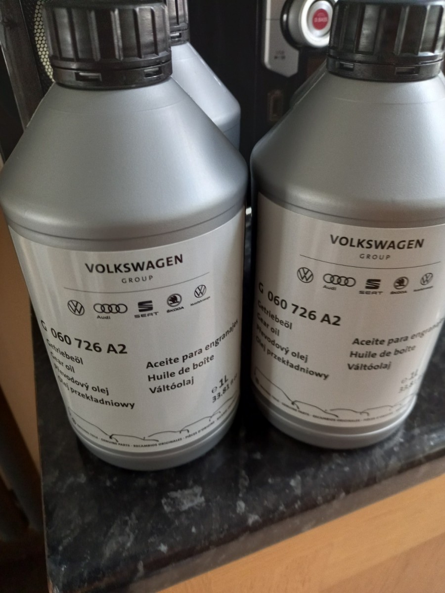

i used G  060 726 a2 from the dealers , wasnt much money
that link should be right for an 085 , or search another seller for 085 seals
Just got a price from audi parts direct for 4ltrs £45 . Gearbox only requires 3.1 ltr

Update gearbox oil (g060726a2) from Cardiff audi delived total £39.79.
