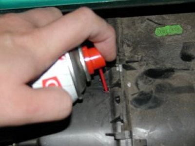

dry bearings...can sometimes fix it if you spray something like gt85 into the bearing area with the fan turned on
I squirted in some GT85 into our banshee of a heater motor going on 3 years ago and it hasn't made a peep since. Expected it to be a very temporary bodge as well

bastibum
Thanks! I haven't got gt85 at home. Maybe a silicone-spray will also do the job 🤨
Link to post
Share on other sites
steveo3002
yeah maybe...as long as it doesnt dry out it will help
Link to post

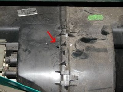

bastibum
Hmmm the silicone didn't help. I just sprayed it on both sides while it was on.  Where precisely is the bearing area?
