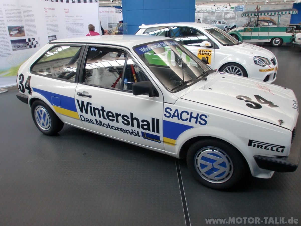

Have some info about the early 80's Polo Cup. The Cars had Solex carbs and 88 HP, more info I've to research from my info-collection. Roll cage and strut-braces by Matter, rims by Volkswagen Motorsport / Centra with the bis VW-insignia in colour red.
I've spoken to Chris Goffey (Top Gear presenter from way back) who participated in a race, he said they were properly nippy and cocked the inside rear wheel on most corners, bet they're a blast to drive on a track.
