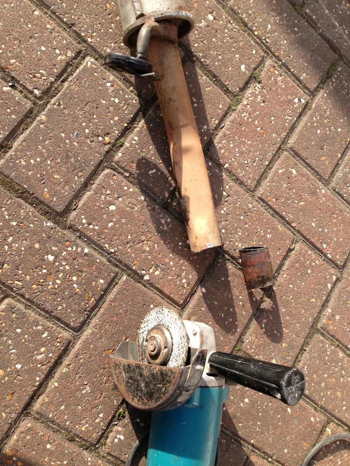

The orange is in really bad condition and one wheel somebody has tired to strip already. Could always redo then orange but haven't had many good comments about the wheel colour lol. Had to cut the exhuast today as it didn't for properly with the new manifold all good now :) need clear garage out so it can be put in there and I can start work on the engine bay.

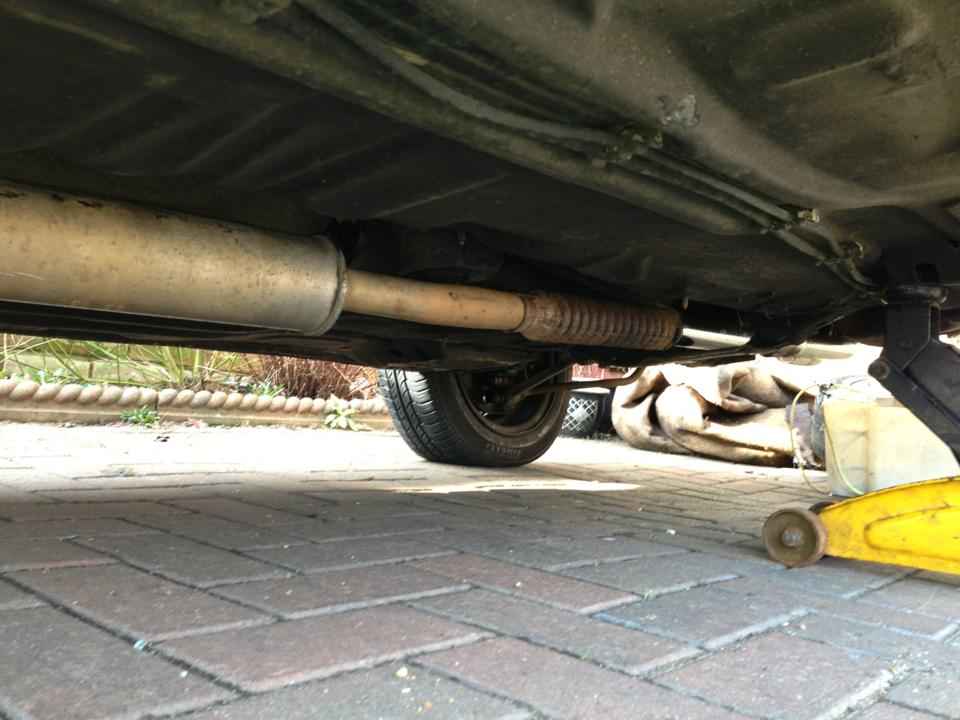

exhaust cut to size and mounted correctly with all new rubbers

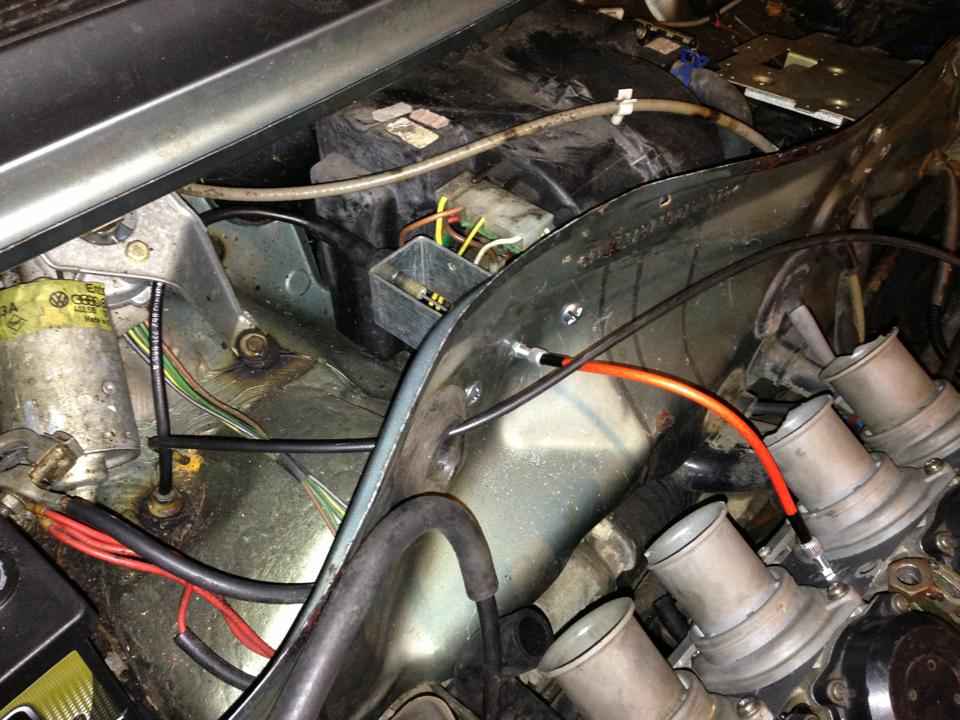

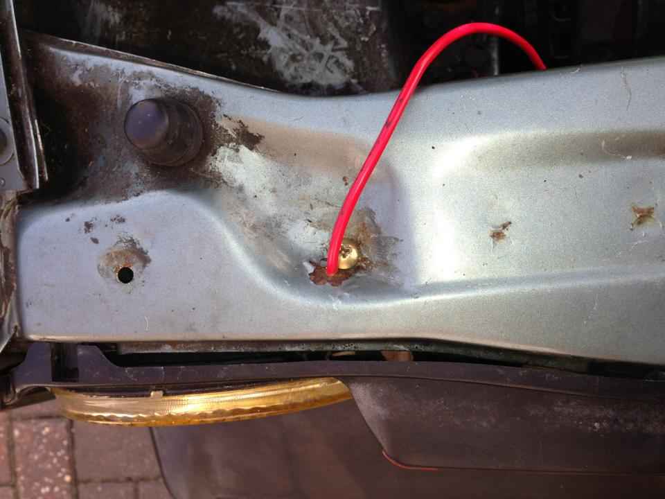

some of the bodged work under the bonnet

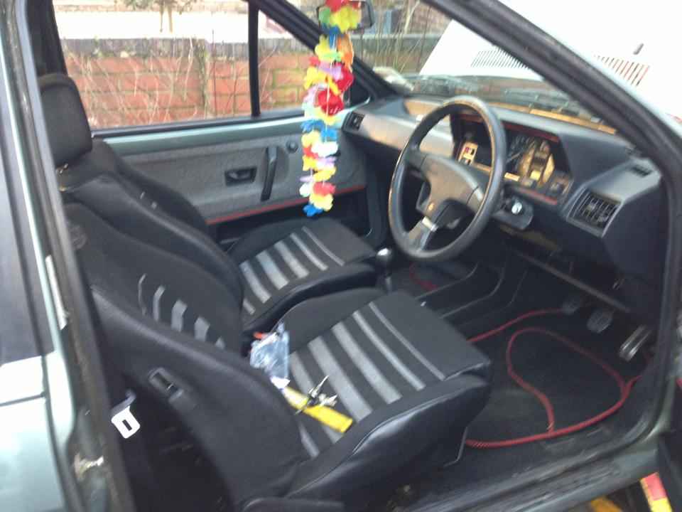

and just a little shot of the inside :)

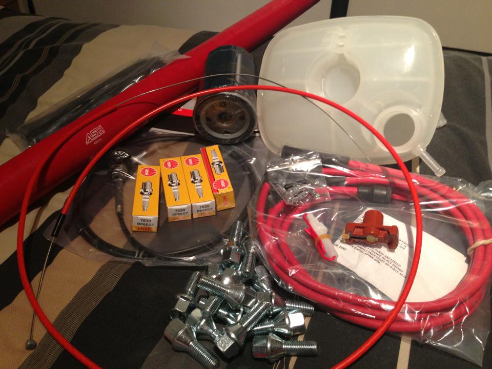

Little update on the progress of the car, it's now stored in a garage jacked up and on ramps bonnet of so I can set to work on the engine bay, the fuel pump has been rerouted to a safer place for now untill I find the best place to mount it when the bay is done. Ordered all new hoses pipes so on. Need a new throttle cable as the old was held on with a... cable tie.. No prizes for guessing that one. Tryed to pull out as much of the dent in the front as I could. Got a nasty surprise when I took the rocker cover of and it was full of yellow crap! But diped my finger in the oil and it was a nice black? I was told the at recently had a new head so I'm hoping the crap is from the old head and the person was just lazy and didn't clean out the rocker cover. Wheels are still at the sandblasters and will be primed and ready for paint on Friday. That's about all I can think of for now sorry there's no pics phone died on me
okay another update.. sorry its been a while, engine bay has been completely changed everything routed properly old parts replaced I made up a bracket for the throttle and got a choke cable. wheels are at the spray yard being sprayed purple and having the lip polished. been mad busy. one thing I need help with.. the vaccum on the distributor where should it go ino its needed to advance the spark but there is nowhere on the manifold for it???

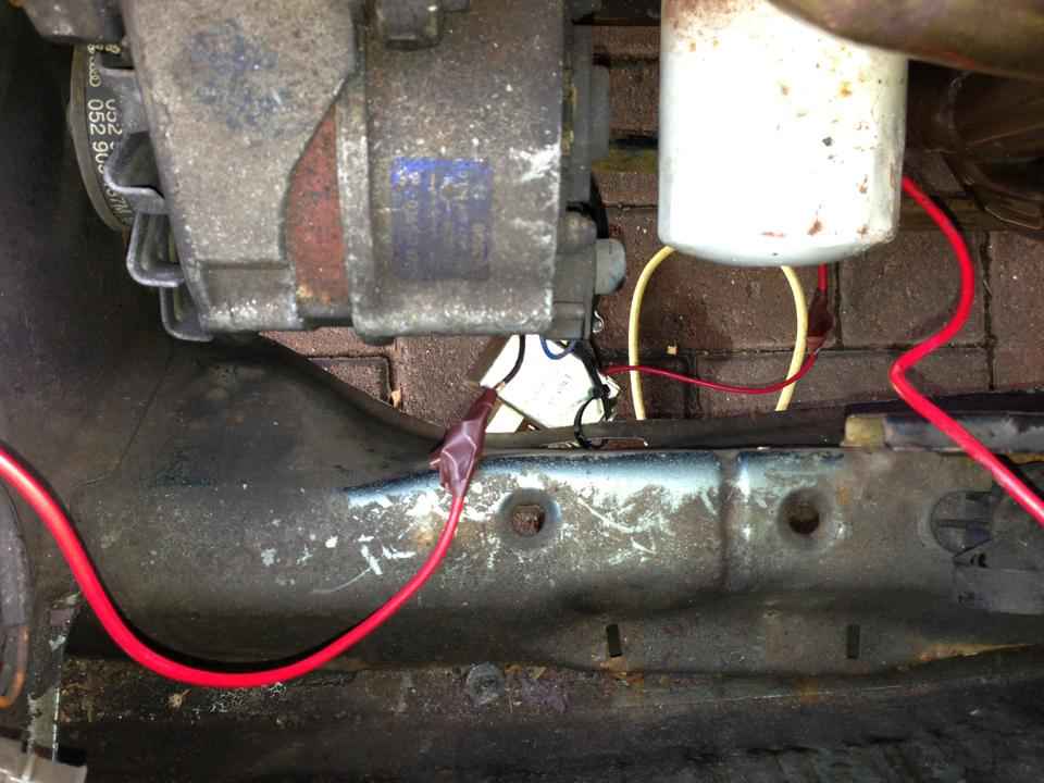

little update on the car, finally got it running http://www.youtube.com/watch?v=kPl3fiQdb8w been working away under the bonnet fixing or replacing all the wrongs of wich there was to many to list. water hasn't been circulating properly so had no chance to drive it still :( took the thermostat out today as it was shot. also this isn't helping...

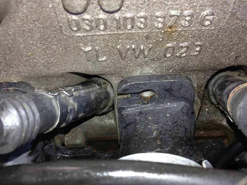

think I read this went to the old carb what should I do with it?
I also made a nipple for the advance

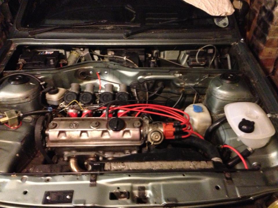

this is what I have
so what you are saying is loose the bottle and block of the large pipe and run the smaller pipe straight to the catch can? somebody else told me this but I was worried it may cause to much pressure? also the reason for the t-piece is because the catch can only has 2 inlets so one will be the rocker and crank breather t pieced into it the other will be a pipe run (under the car) to let any extra fumes escape

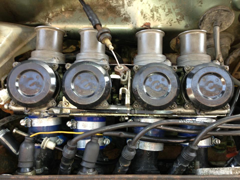

Ideally you want a nipple on each of those runners boss otherwise you'll get pulses of vacuum resulting in erratic timing. I'm not sure how much this will effect the drivability, but it means you'll have advance at intervals, rather at all times when needed. Isn't the most efficient method
yeah I had a feeling I would, eventually once the car is running decent enough and it comes to setting up the carbs I want to get a new manifold mad up with nipples on them
you need a nipple on each runner of the manifold t pieced together to use the advance properly.
if not just dont use it and set your timing a bit higher, say 10 degrees ish.
dont worry about that coolant hose, wont do shit to your cooling system.
the small pipe on that oil breather should normally go to the rocker cover. on mine i instead just have a straight pipe then the filter, then a straight pipe at the top of it to another filter.
carbs sound like there either way out of balance or one isnt operating correctly. check for air leaks - spray WD40 around all the manifold/carb joins and if the revs pick up you have a vaccum leak you need to sort.

Just block them hoses of then so they look abit neater? Hopefully it was just the thermostat messing it of then. Yeah the carbs are well out but atleast it's running now. Dumptank is already paid for now anyway plus will look pretty cool so ill just put it on anyway cheers mate
you can block them off or just leave as it is, makes no difference really just looks.
fair enough just run a pipe to that filter then a pipe from that to your catch tank then.
if you dont have the breather on the cam cover it does make these engines breathe a little heavy but not a problem with a tank
