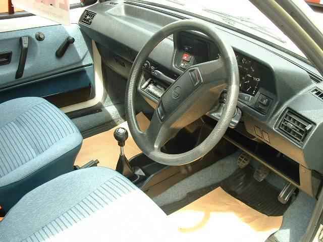

I bet she sounds luch, I've got a mk2 1.3 polo (pic) and am looking for an induction kit, where is the best place to go as i noticed yours.
If you can help??
Cheers matt :-) :-)
