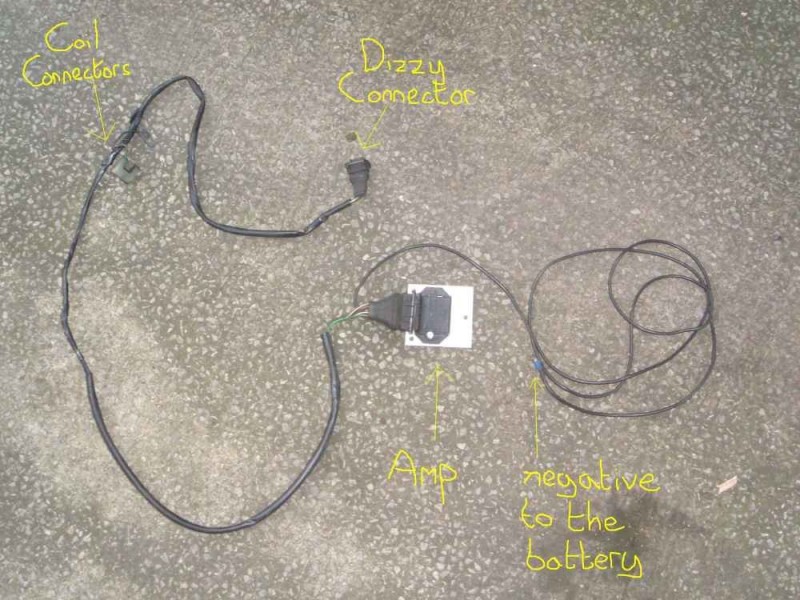

Any one know of a wiring diagram that includes the coil, ignition amp & mk2 dizzy.
Its well covered in the revised MK2 Haynes manual,but basically consists of the coil,TCi-H amp unit and the distributor. These are joined by a semi-independent loom,and to ignition and battery.
This includes keyed multiplugs for the amp and dizzy,so you really need to get this loom from an '86-90 Polo.
If your loom doesnt fit/reach,its probably from a Golf,and you'll have to adapt it.
thanks mikey.
got no issues with adapting the loom or even making one from bits, plus got a photograph now as well of the amp loom and i think it makes sense, but may try and source a mk2 loom just to be sure.
Edited by Cymro
Thats spot on,Polo one. The amp goes just behind the firewall panel,just under the plastic rain-drip tray,the rubber grommet's for that. There's actually a bracket on the later MK2 to mount it on,but it's fine screwed to the panelwork as mine is. Black wire to battery earth. Then the black plug is for the dizzy and white are for the coil.
They just hang across the bay,as you can see in pics of MK2 bays,though I've used flexi conduit.

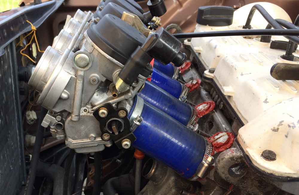

Here are the best shots i have of my flanges/plate/tube method. Thirdly,I've included the shot of my old smaller flanges i made for the ABD.
I've since discovered that Ikea sell cheap bathroom handrails,and B&Q sell rubber/jubilee bathroom/kitchen sink wastepipe joiners and washers for the handrail ends. They also sell hacksaws,and that's your ingredients for a cheap and easy,off the shelf,manifold solution (depending on engine and carbs).

How are those flanges attached on that ABD? I dont see any nuts :?
And also, whats that ally plate running along the inlet on the other too, between the head and the carbs? Is that your method of mounting them?
Those allen bolt just hold them in place, I'm assuming here that he put a lip on the inside do they would slot in then the bolts to stop them falling out again.
TBH the ABD ones are a good idea. Simple but effective.
The ones currently on there are no different to the brass ones,they're just bigger and aluminium.
I've inset rubber seals into them as a gasket,like an 'O' ring. Otherwise they're flush with the head,the shoulders were enough to hold the brass ones secure,but the AFH bolt pattern didn't allow me to do this so i had to make a plate.
