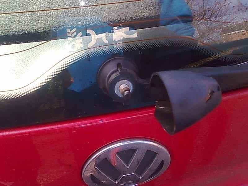

Okai so first off just pull off the wiper cap:
Now unthread the first nut, using a spanner.
The wiper now needs to come off, and does not come off easily, so gett behind it and prise it off with a flat head screwdriver.
after that it should lokk a little like this:
