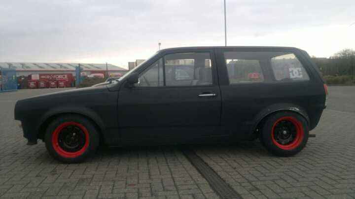

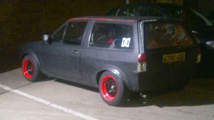

Hey well been sorting this polo out for ages cost me a grand total of £111 off ebay when i bought it but have then spent well over a grand restoring and buying new parts and chopping out rust and welding in replacement parts put I'm now quite happy with it but its a long way from finished so just thought i would get some pics up finally and see what you guys think. Got alot of plans coming for this just time and money well more money atm as my gf is at uni i have shed loads of time lol. Just had to flair the rear arches to get my new wheels to fit as the mk1/2 golf arches are welded slightly off central as can be seen in pic but il be cleaning it up soon and it fits nice now.
so far i have:
Replaced petrol tank and sender unit.
Moved inner sill wall away from filler neck to stop dirt trap
New full copper brakelines
New large bore copper fuel lines
80/60 phil j kit
New pads and disks front
new pads and drums rear
new rear brakecylinders
Mk1/2 golf arches fully welded on in all four corners
stripped out rear seats

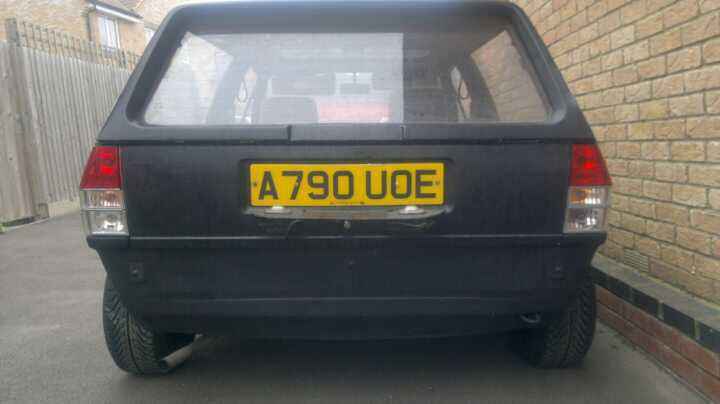

New bootlid with spoiler (as old owner reversed into a skip)
new rear crystal clear lights
De bumpered
new front dome indicators
new rear bottom panel welded in.
removed tow bar (for sale if anyone wants)
resprayed matt black
undersealed all four arches
modified handbrake to fit around new mk3 petrol tank tank

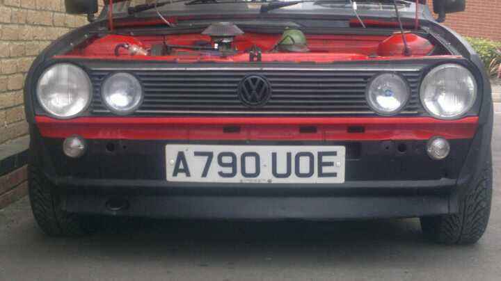

twin headlight grill put on
Painted front calipers red
1.5 degree negative camber shims on rear
Flaired rear arches pikey style
Newly resprayed weller mattigs put on 7j front et 020 175 60 tyres 7.5j rear et 005 185 60 tyres
cant remember anything else atm and il do a proper build thread when i have time.
Thanks for looking guys hope you enjoy its been alot of hard work for me but well worth it in my eyes.

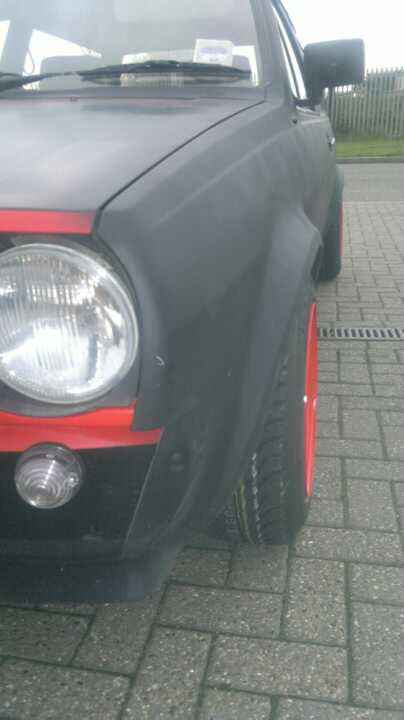

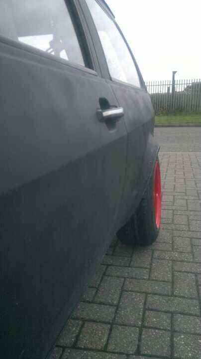

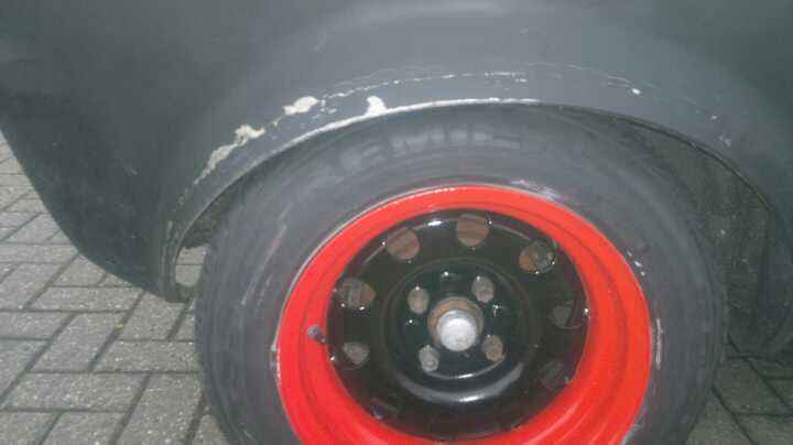

Mole grips to pull it up then a small wood plank in the gap then me and my dad sitting in the boot and bending the wood up and have also rolled the lips too before i welded the arches on.

not massively to my taste, but having a mk2 bready myself, i know how much of a bastard them arches are, the rear ones look mint!

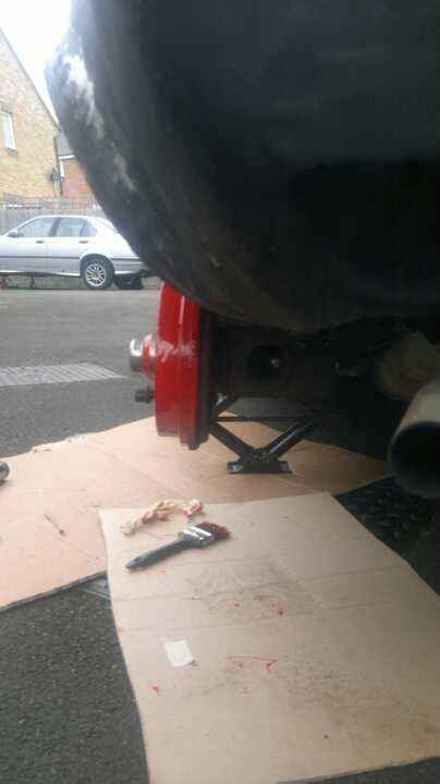

painted rear drums red today and also sorted out most of the rear arches just needs bodyfiller and respray on them but going to wait for now and also wired in stereo properly fitted to two new speakers in each front door card sounds amazing no pics of speakers yet tho.

oh forgot to add a while ago i have removed number plate from boot lid and have put a motorbike sized square one below the boot in the centre with motorbike number plate light bolts looks pretty good and will look alot better once the boot is smoothed.
