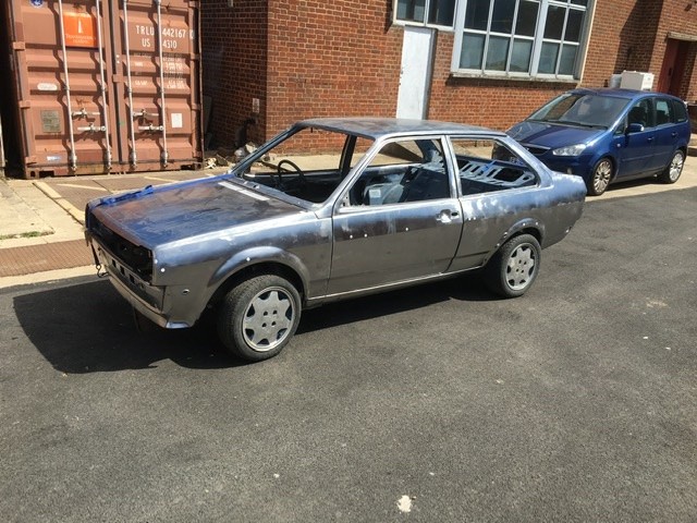

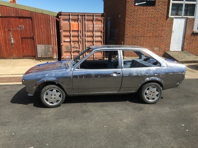

Laura's (Dirrt???) old 'Loon. Engine was seized in it, and i happedned to have an engine looking for a car, so I snapped this up! Condition is so good for a 27yr old car. V.little rust, but the usual dings and dents. Go this in january, and spent the summer doing this...
This only got sprayed last week, but i stripped the engine out in april!! Smoothing the bay was such a chore. In fact, i smoothed it once, but wasn't happy. So took the angle grinder to it, and re-did all the filling again (do you see a trend?! :retard:). Anyhow, i got some strange looks dragging it into the garage, since it has no front wheels, i had to go all he-man and do it by muscle alone! I think he local villagers thought I'd lost it (most of them have taken a passing interest in the car, must be from seeing me sitting in the engine bay, covered in filler dust all summer).

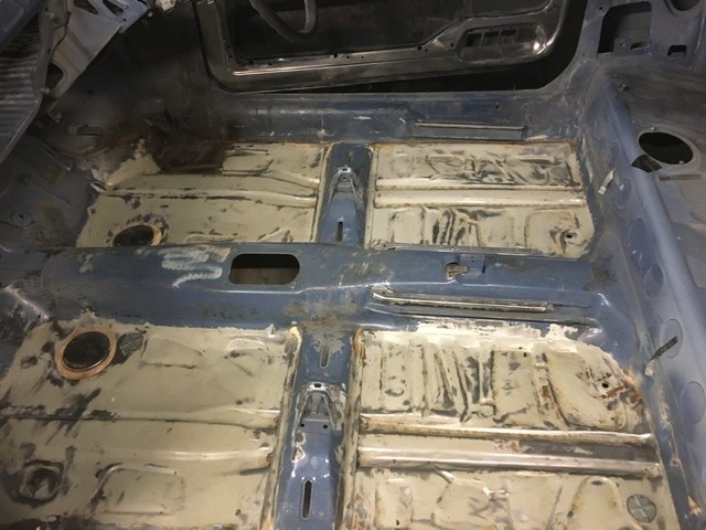

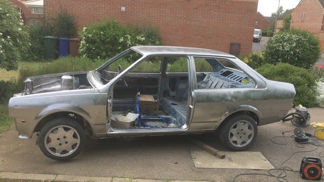

Really need to start putting things back on, but i just seem to be de-rusting and taking things off! At least it made it light enough to lift up!!
