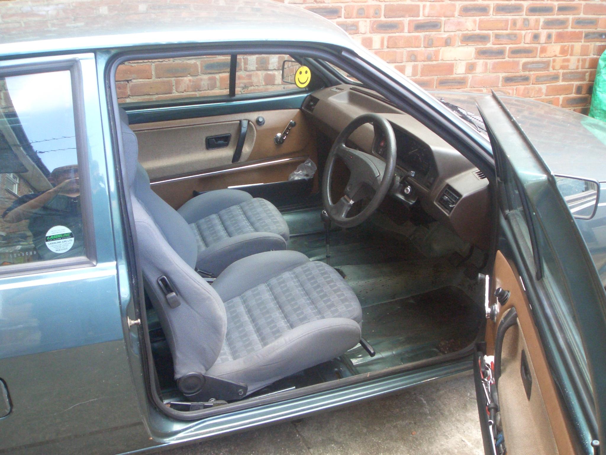

As mikey mentioned the drivers seat was a bit buggered. On closer inspection it had been repaired at some point already as some of the welds holding the subframe together had broken. I've now got some corrado front seats which I've modified to fit, these will be re-trimmed to match the interior along with the rear bench. (at the moment they are light grey)
At the moment, the car is very much in a transitional state. I've removed most of the interior to check for rust, including all of the sound deadening, which I will replace at some point, possibly with dynamat type stuff. The car is also on GT steelies and trims due to the Cups needing a re-furb. All of the side trim has been removed in preparation for some bodywork. Last thing need to do is remove the bonnet extension without breaking it. :paranoid:

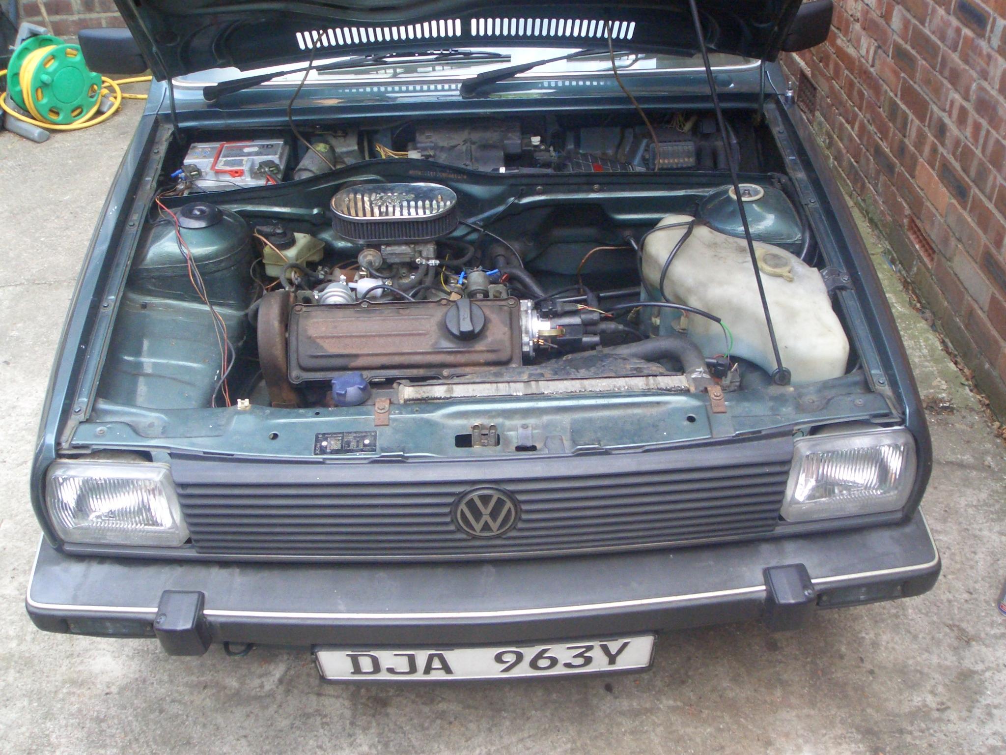

Yesterday I fitted Digignition from a GK engine. I managed to source the loom and ECU off German ebay quite cheaply, but the distributor I had to buy new. (cost an arm and a leg!) I fancied trying something new as the saab dizzy will be included in the sale of the 1.3 engine, as well as the fact that I had no idea how suitable the advance curve was on it. Plus with this distributor I can fit injection at a later date if I decide to as it's the same internally as a GT dizzy.
After a small test I could find little difference between the two setups, so I can still recommend the saab dizzy as a good aftermarket upgrade.
