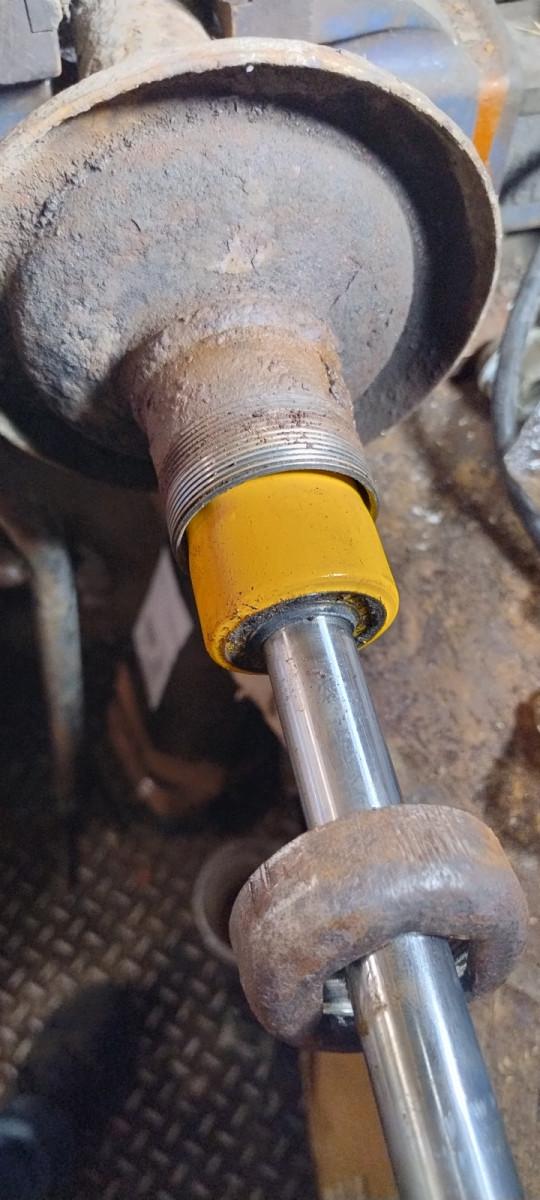

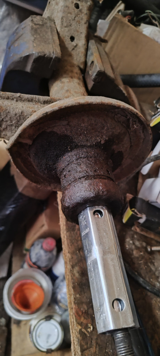

Removing the gland nut.

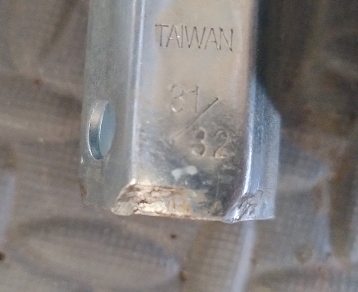

Tried a 31/32 plumbers socket, but it is Taiwan chocolate steel.

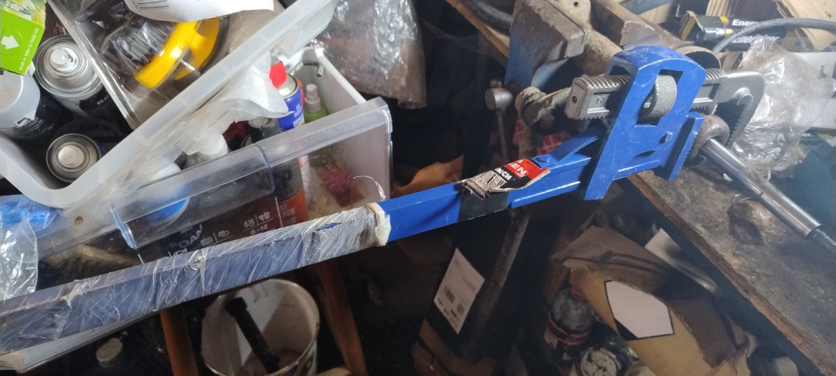

Used a 3 foot Stilson and a bench vice.
(after Plusgas, WD40, wirebrush, heat gun, Jenolite freeze spray, lots of hammer taps).
Then it was nearly easy.

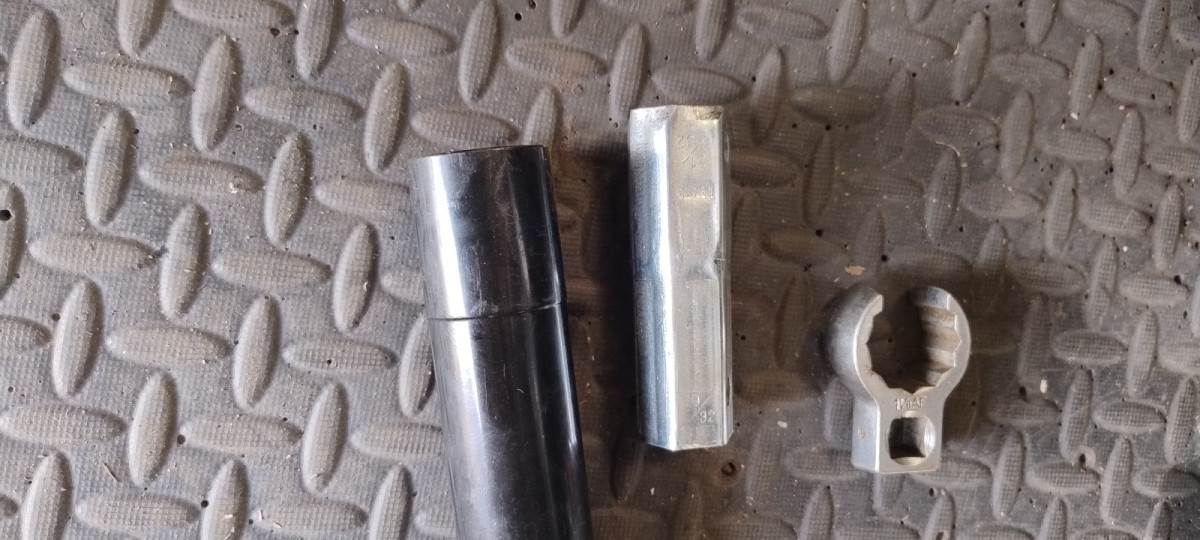

The damaged plumber's socket and the ways I tried to turn it. Crows foot 1/2" drive and long 30mm socket.
I might cut off the damage and try strengthening the inside with a big nut so it can't distort.
