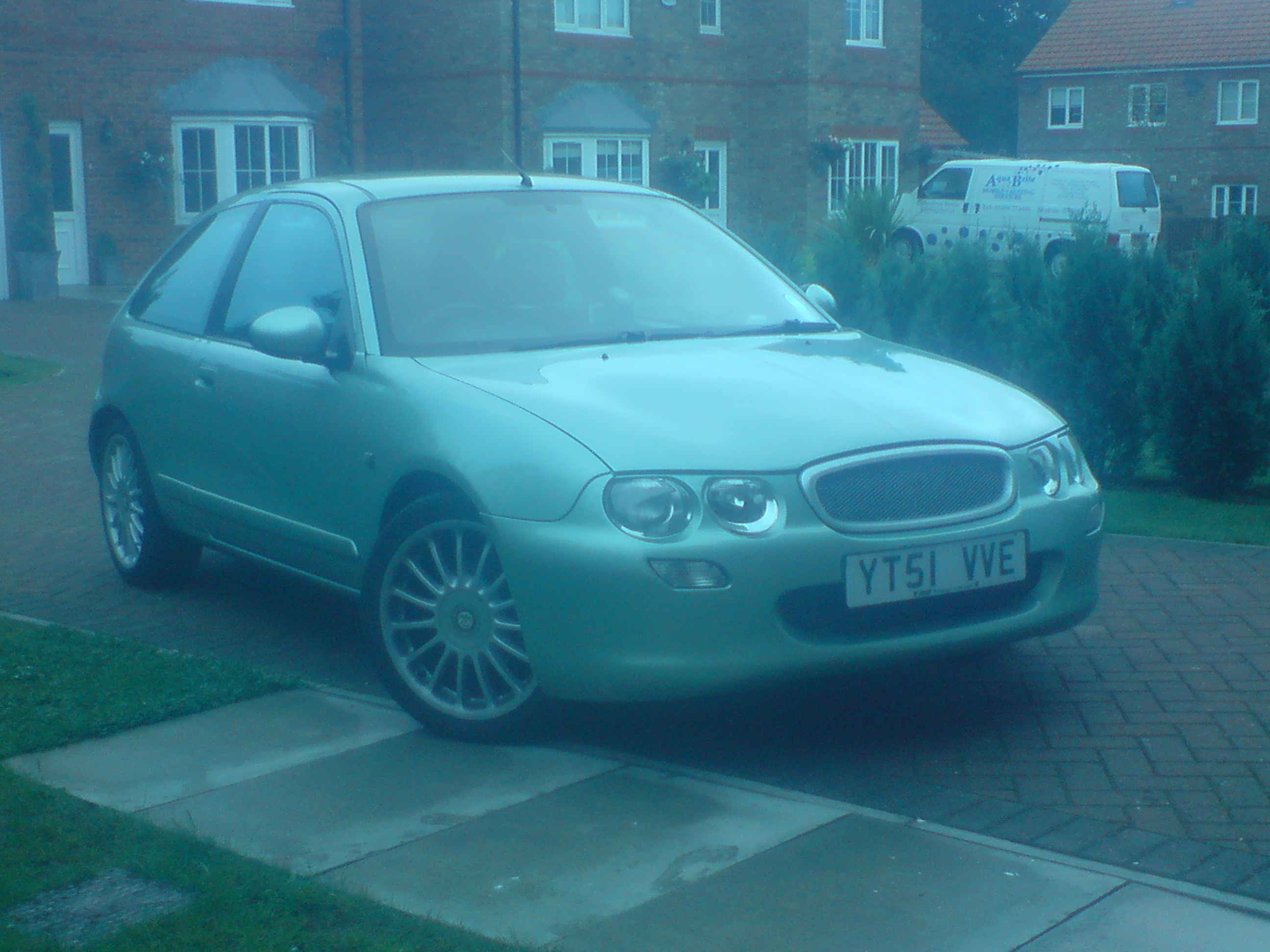

it wont crack i did it on my rover 25 over 2 year ago, its got the stiffest suspension ever and thers loads of speed bumps where a live and its still as good as ever, the only thing i did differently was a used hairy catty aswel.
