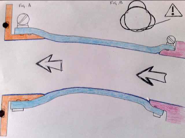

I was thinking of making my own, with some silicone hose an top hat flanges, like some folks do. Would work aye?

Yes it would work but the only downside would be is that there will be bumps and the like in the inlet manifold where the hose joins the top-hats. If you can get the proper joining rubbers for the bike carbs these have recesses in them so once fitted there is a smooth flow through the whole of the inlet.
The problem with them is they're too short for flanges,unless you space the carbs out to the same as the ports,and that brings its own problems.
I've used industrial wire-reinforced PVC tubing,and got it all smooth on the inside by heating it up and stretching it over slightly bigger flanges (they're 42mm internal,the carb outlet is 37mm,and the tubing internal diameter is 40mm).
I also knife-edged the flanges to suit - the carb outlet is already adequately profiled for this,and its ramped down anyway - see dodgy sketch..
You do have to be careful when porting the head to accept round flanges though,as there's not much meat on the flat lower part. I've actually drawn the circle a bit too small in the pic. You can feel how much alloy there is from behind the clamp face,though. I removed more from the top sides than the pic indicates - but i dont know how much its safe to trim there.
