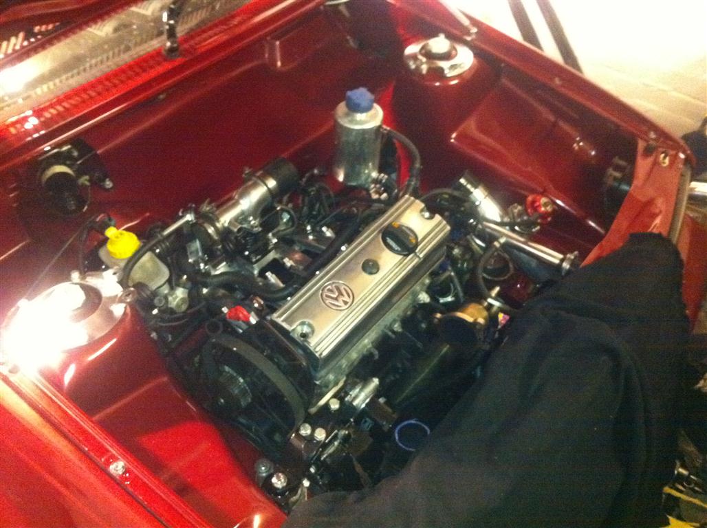

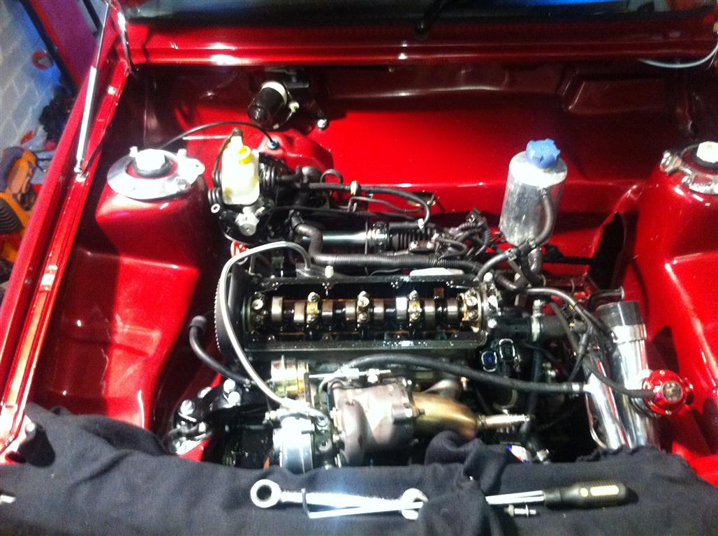

Right - some updates
Got nearly all the parts to assemble this now. I'm only missing the gaskets and studs which hopefully will arrive tomorrow:-)

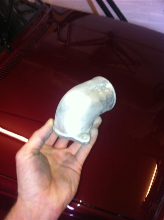

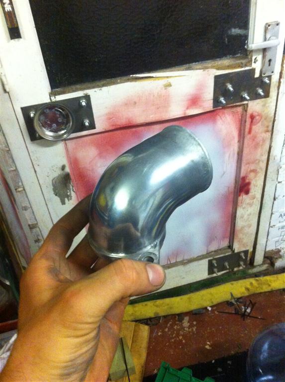

Got a hose made up - its slightly not long enough to reach perfect:-( i may have to be anal and have it remade a little longer possibly incorporating a 180degree bend piece so the line flows round the rocker cover.
water lines i have used a standard passat line out as my line in as it fits betweek the wurbo and the actuator with a nice gap for the heat not to effect it, and the line back to the header is a banjo - line T's into the header tank return. the inlet line uses a new custom made top rad pipe. looks a little neater then a rubber bodge hose i initially made.
The sump i drilled a hole after i had marked it out on the engine (to ensure clearence from antiroll bar and downpipe)
And my oil drain line i made from cutting the end of a passat item and using a rubber hose to 90degree fitting like so
fingers crossed i will have this running by the weekend!!!

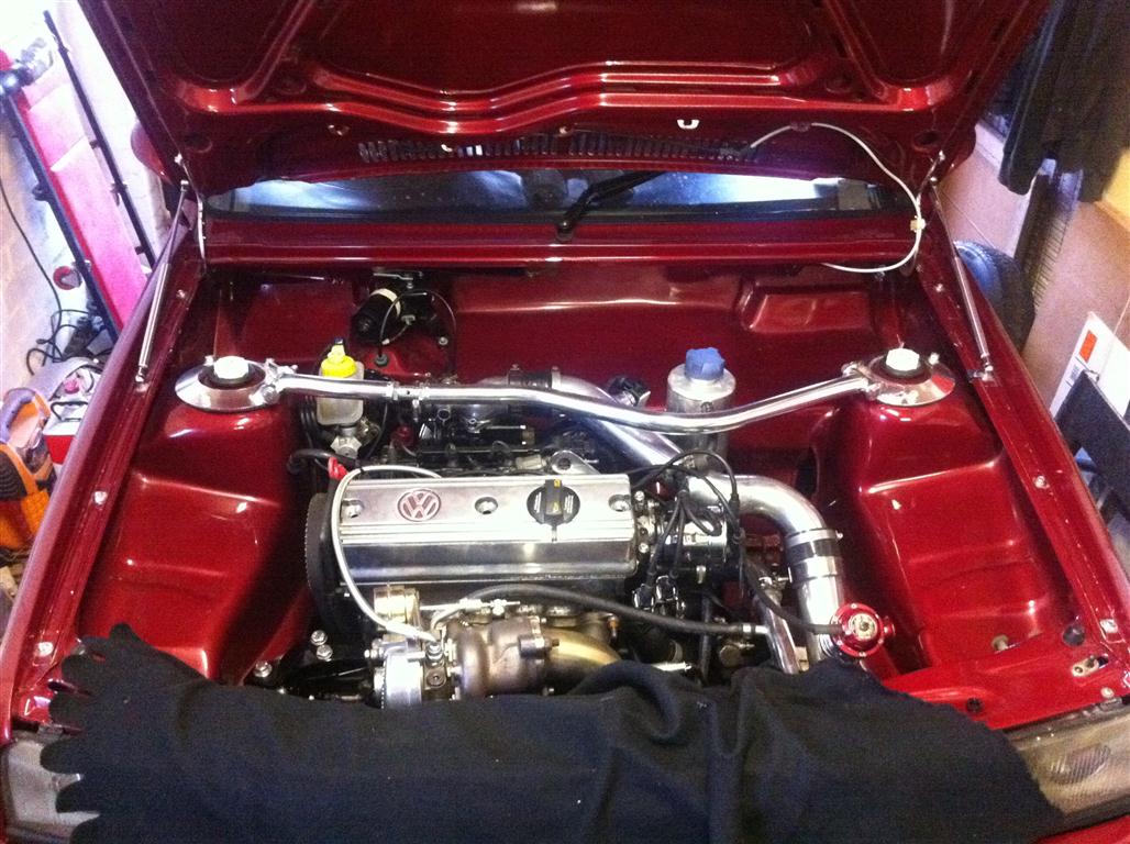

is your strut brace on bacl to front?
Top car and top guy nice to see this in the full at polo show :D
yes, it fouls the brakes and header if its on the proper way. also it now looks like it bends around the header tank.

what turbo are you using and suppose your running an oil cooler?
You doing edition mate? Want to have a good look at this :)
running a K03 from a passat, and yes its running a mocal thermostatic sandwich plate and
a 13row oil cooler. had the oil cooler already from my eaton setup.

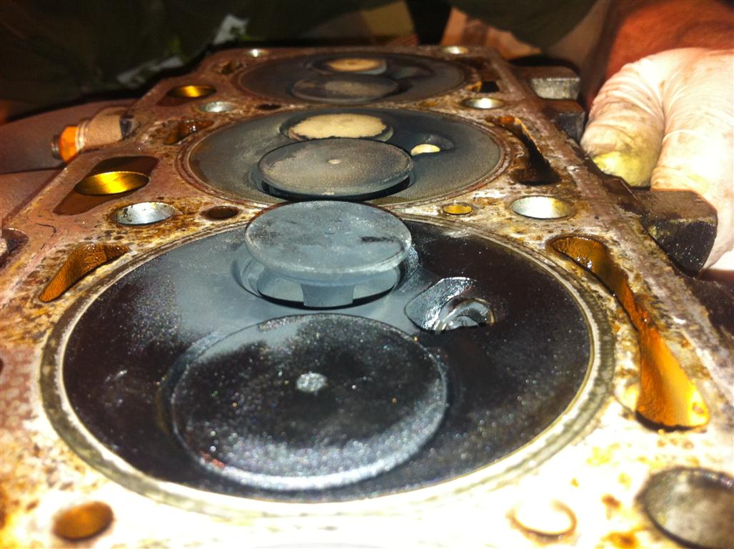

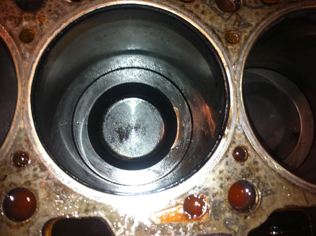

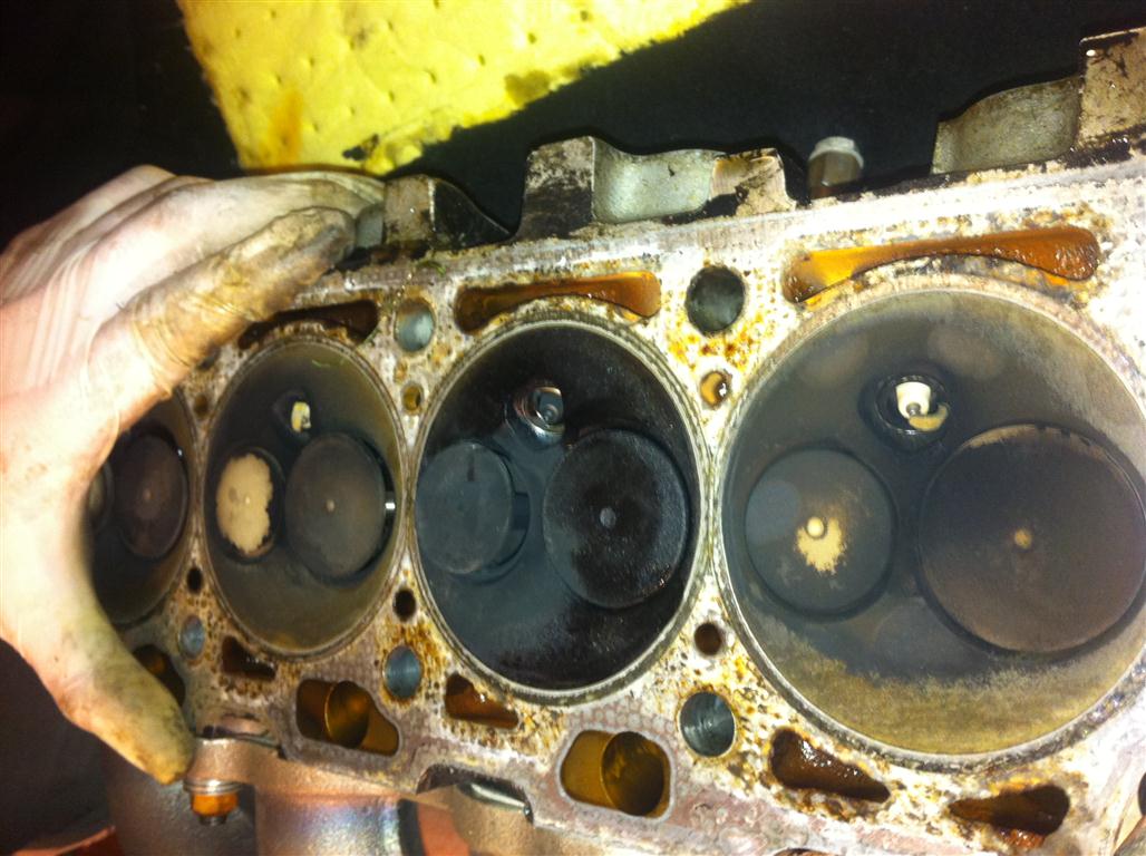

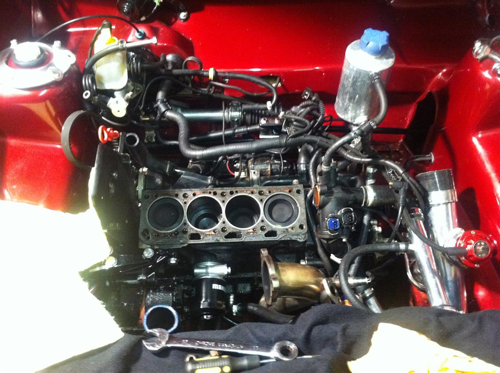

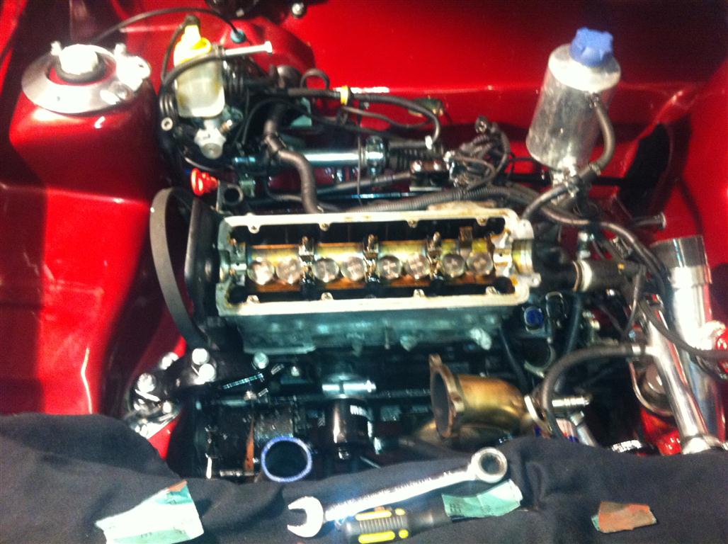

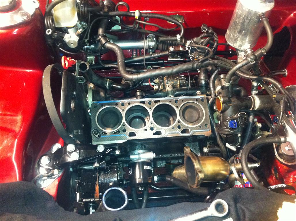

I was having trouble setting the timing after the turbo swap - turns out cylinder 2 was showing zero compression!!! it was head off time and so, with myself 3miles from home at 5:50pm on Wednesday night - set off for the local parts shop, on loudspeaker as i travelled to the shop and bought a headgasket.
got home and with Guy 10minutes behind me we set off on a 6hour investigation job
OH SH1T! however i had bought a spare cylinder head with the turbo kit for rebuilding when i do the 1.5turbo
So Guy worked his magic on cleaning the head up ready for installing onto the engine

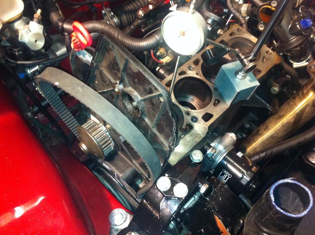

i then measured the TDC with a DTI so i could pinpoint the timing mark

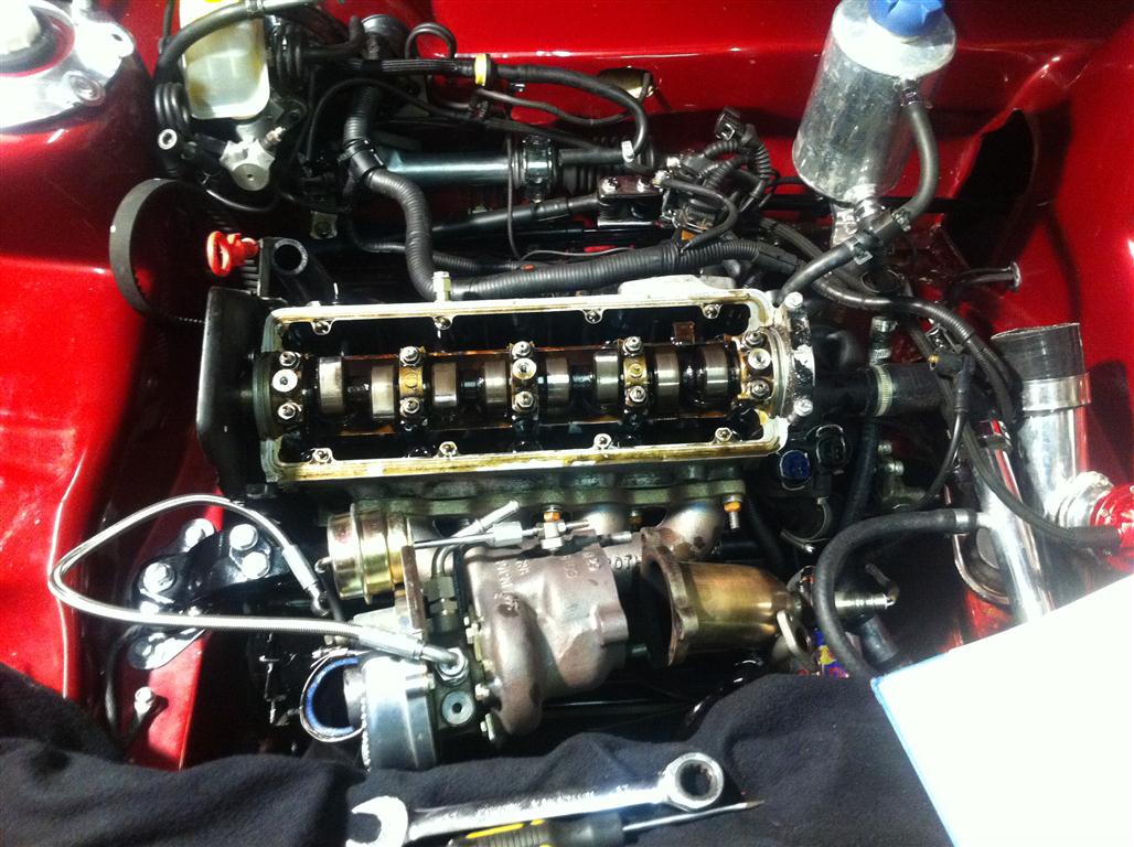

so 6hours later we had removed all of the ancillaries of the cylinder head (turbo,inlet etc)
Cleaned the new head up
Cleaned the block up
Installed the new gasket
Refitted the head with new headbolts (i had new spares)
all i needed to do was fit the turbo again and i was done:-) so all of you that saw the car at edition owe the fact to Mclovin!

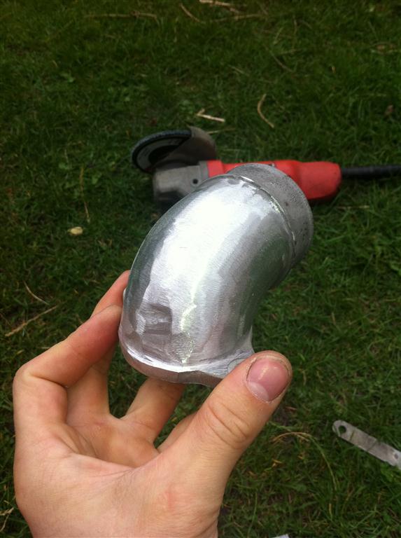

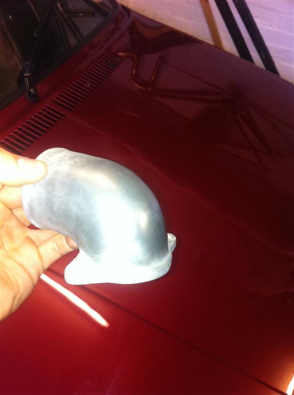

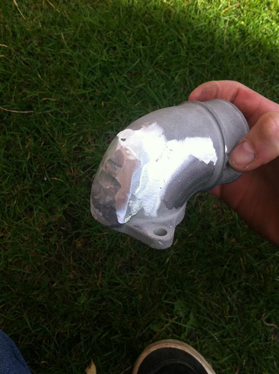

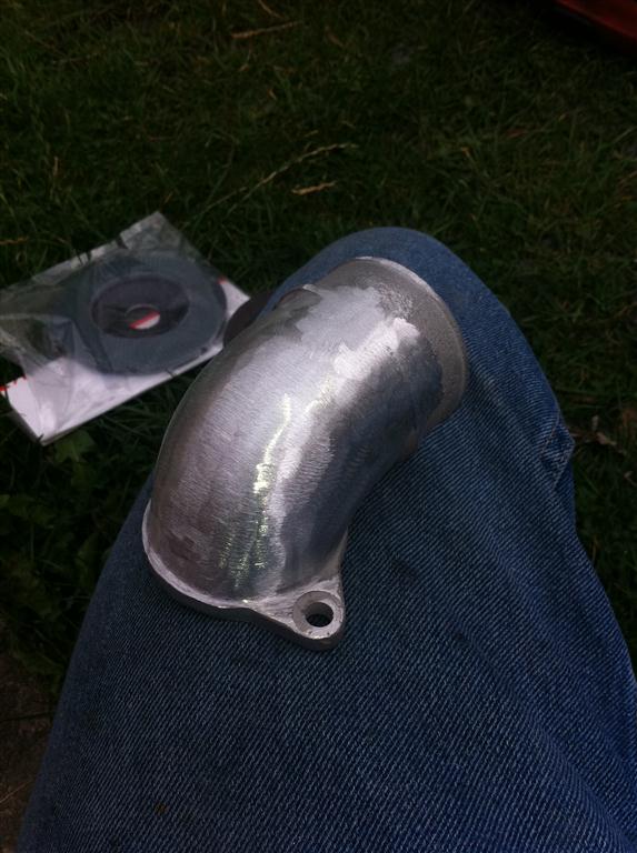

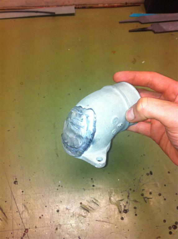

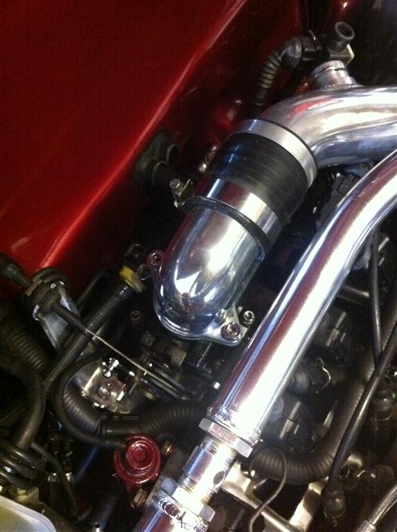

Everyone with a turbo G40 will know that the throttle body looked Sh1te once you have blocked it off with a pipe-bung and 2 jubilee clips.
so i cut the second butterfly off mine (the boost return butterfly) and welded up the hole - being a complete tit with the alloy rods so it built up loads
As you can see there - a hell of a lot of sanding later and its looking pretty kooool

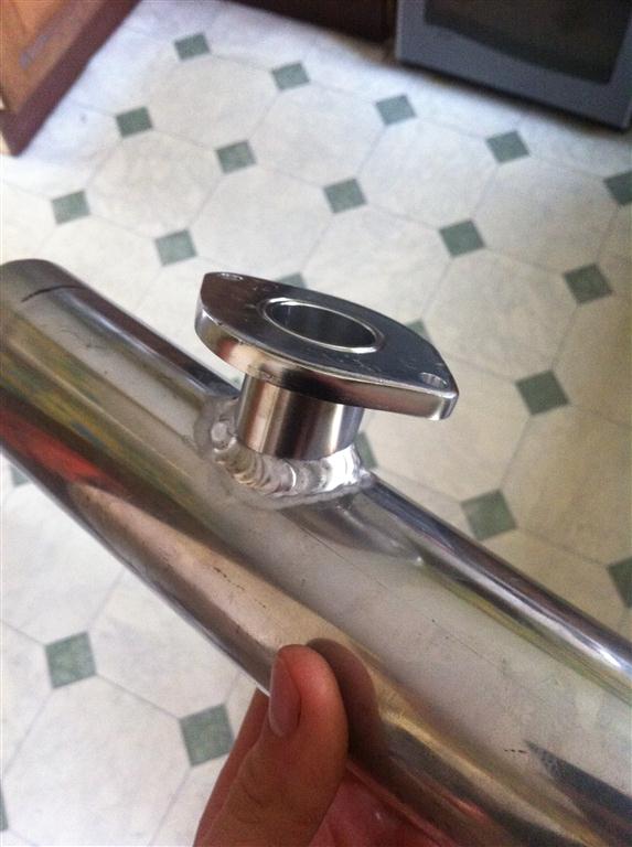

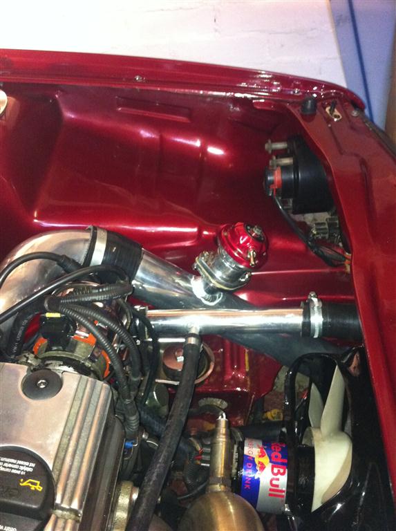

Did a bit welding on my BOV pipe aswell - you know me - couldnt be easy
i think I'm going to move it though as I'm getting chatter and i dont want my turbo to wear out. going to weld an adapter to my intercooler so its near the turbo.
gave the car one hell of a clean aswell - shes come up quite nicely i think
Turbo setup now complete

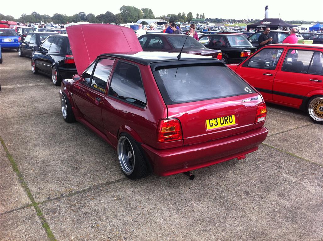

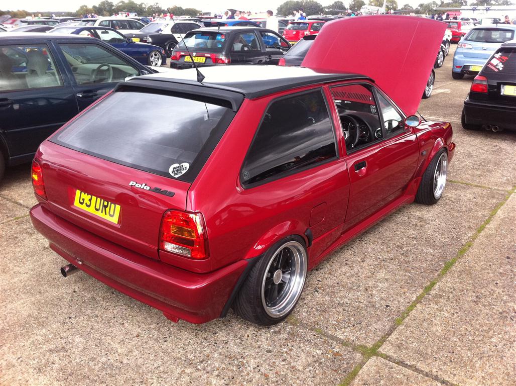

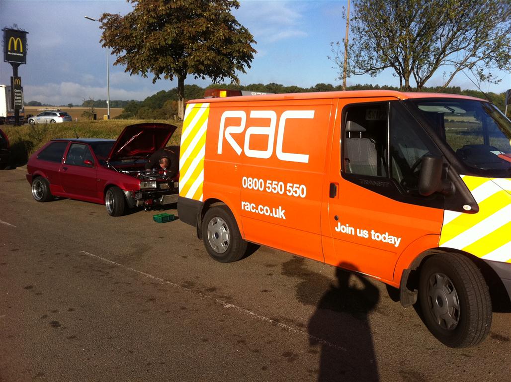

Headed off to players - and 1mile from the bloody show the only part of the engine i didnt change a small water pipe split - Mr RAC fixed it in under 10minutes:-)
thankfully i didnt even have to wait - i broke down next to a mcdonalds he had pulled into for his breakfast!!!!
But made it to the show - i took a couple of photos
