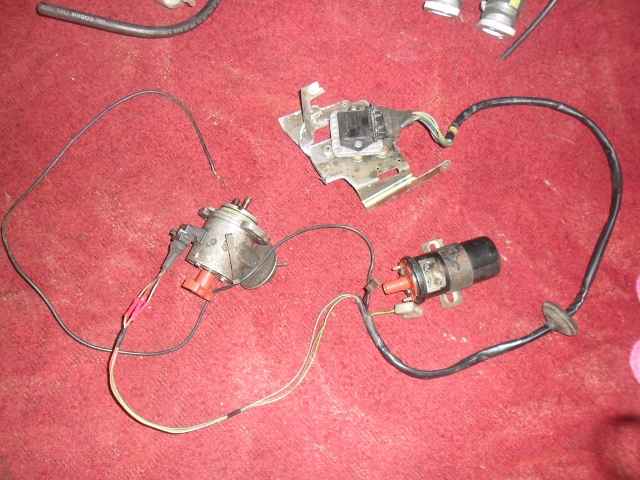

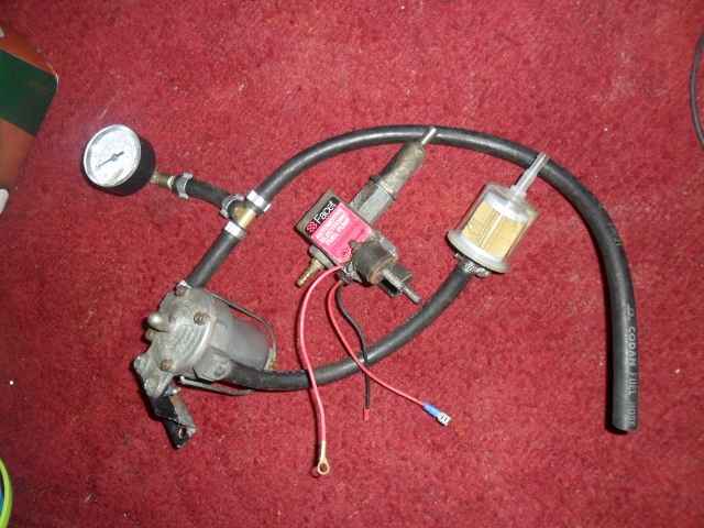

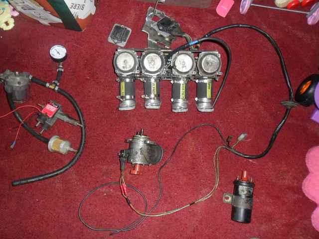

I've read through the FAQ pages but cant find out what else i need and where everythin connects too :-( Hope its not me bein dopy :lol: I've got...
Mk2 polo loom, dizzy, coil and replacement for the ECU (below)
Fuel filters and fuel pump (below)

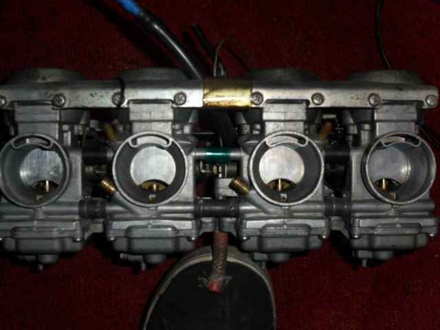

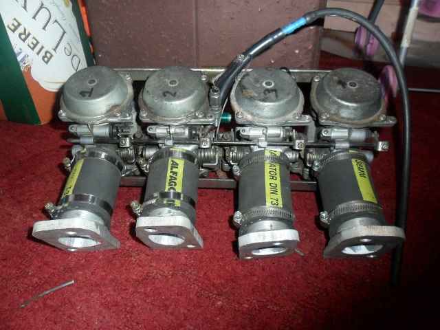

And set off bike carbs (below) which I'm not to sure where to connect the pipes too!
Any help be very appreciated.
Cheers, Chris
Do you know what the Carbs have come off? they look ancient by design
Going purely by guess work.
Red Hose: Fuel in
the brass fittings could be breathers or fuel return (cant see any other breathers)
Red Hose: Fuel in
There GSXR600 carbs he said :-) any help?
Cant find anything at all on them.
Not even basic carb diagrams.
Thats the problem I'm havin, cant find the right info i need for them :-( cheers for havin a look for me :-)
