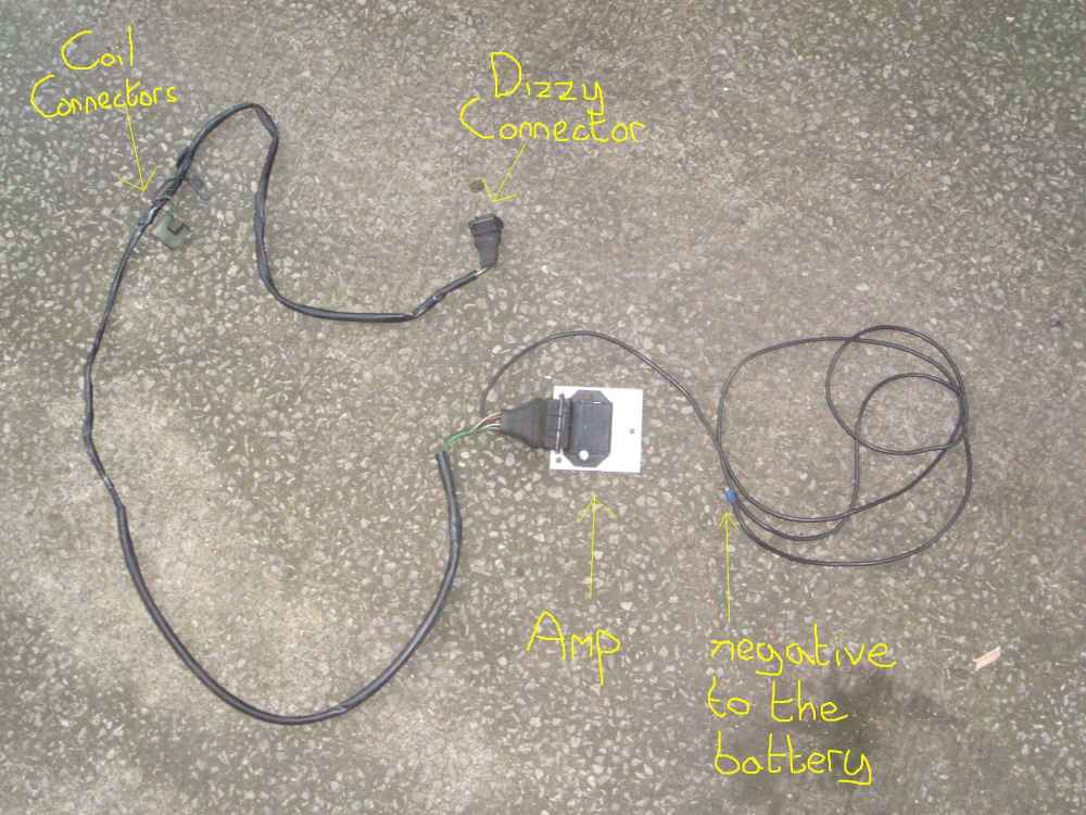

New mk2 ignition wiring pic (found in an old post, thanks to Gaz) and note if the big white coil plug has a black/red cable on the other side thats the rev counter feed.
