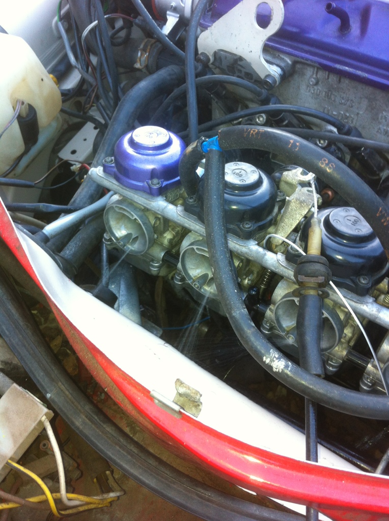

right its geting fuel now but its just pissing out the back of them
this should really be added on the FAQ post, but oh well.
It looks like you are running fuuel into the top of the carbs, which is wrong, the fuel feed is at the bottom on CV carbs.
Connect the fuel line to the right place, then take it from there

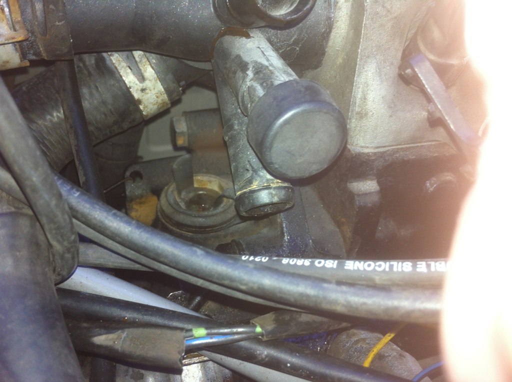

I'm really confuesed i have a mk2 polo 1.0 i have just put a 1.3 gt in on bike carbs but dont know what hoses goes where there is also a bit on the inlet manifold is there a pipe what goes on there
Have a look in the FAQ iirc they are for the inlet mani on your. 1.0L the gt stat housing doesn't have these. You could block them off or get the gt housing.
that port on your inlet manifold is for the Servo on a mk3, just block it off as the mk2 doesnt have servo assisted brakes.
Those 2 ports are for your interior heater matrix pipes.
