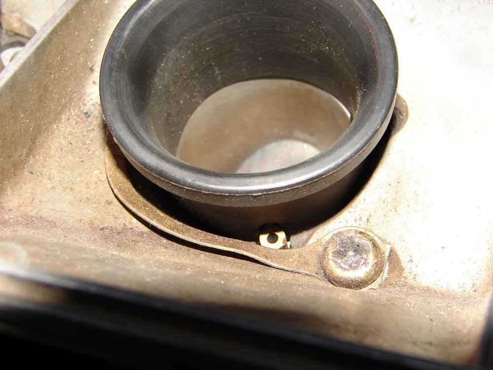

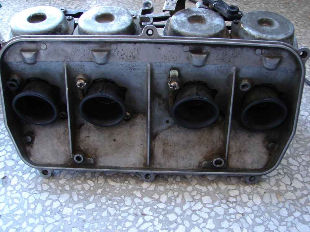

Hi guys, I've read almost every thread here about carbs and have learned a lot. Thank you so much about that. I have tried my carbs, car started, but I didn't tunned them. That was only a try. I would feel better if I ask the question, then to try it by myself. I am bit afraid to make step to unknown by myself. :)
I made intake by myself. Now I have decided to clean them before final mounting.
I have Honda CBR F1 carbs, which have 4x105 standard jets. Someone changed them to 2x108 and 2x105 so I need to sort that out. Pilot jets are 35, choke size is 32mm.
I have 1.1l engine on my car  44 kW @ 6000 rpm /55hp,  83 Nm @ 4400 rpm. -standard engine performance.
What main jets would you recomend as start? I tought to start with 110, then to 120?
And should I solder air corrector on this carbs? Which material to use for soldering if I need to do it?
Is air corrector the one on the last photo?
Here you have photos of my carbs, cleaning is not going too well, it is slow, because I have problems with taking off old bolts. I bought them a bit cheap around 30euros, but someone tid't take care about bolts, so they are in bad condition.
Edited by vladales
adding photos
Maybe some had similar problems.

Solution for finding air jet that needs to be pluged is to spray some of fuel into jets outside, and see if that fuel goes out of main jet. One that takes fuel to the main jet needs to be pluged.
