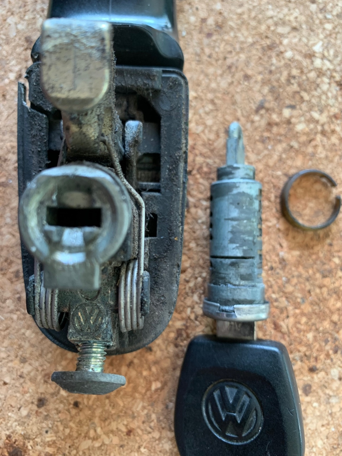

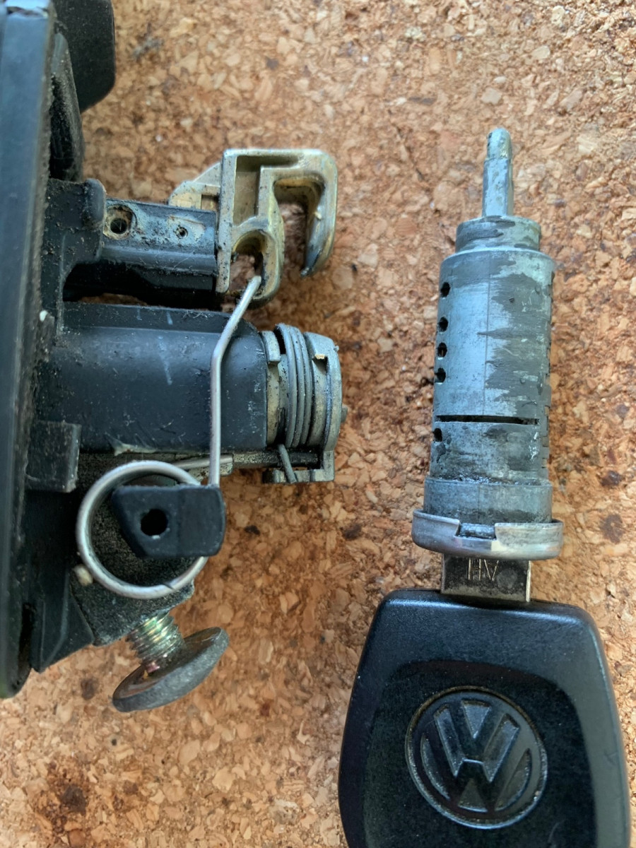

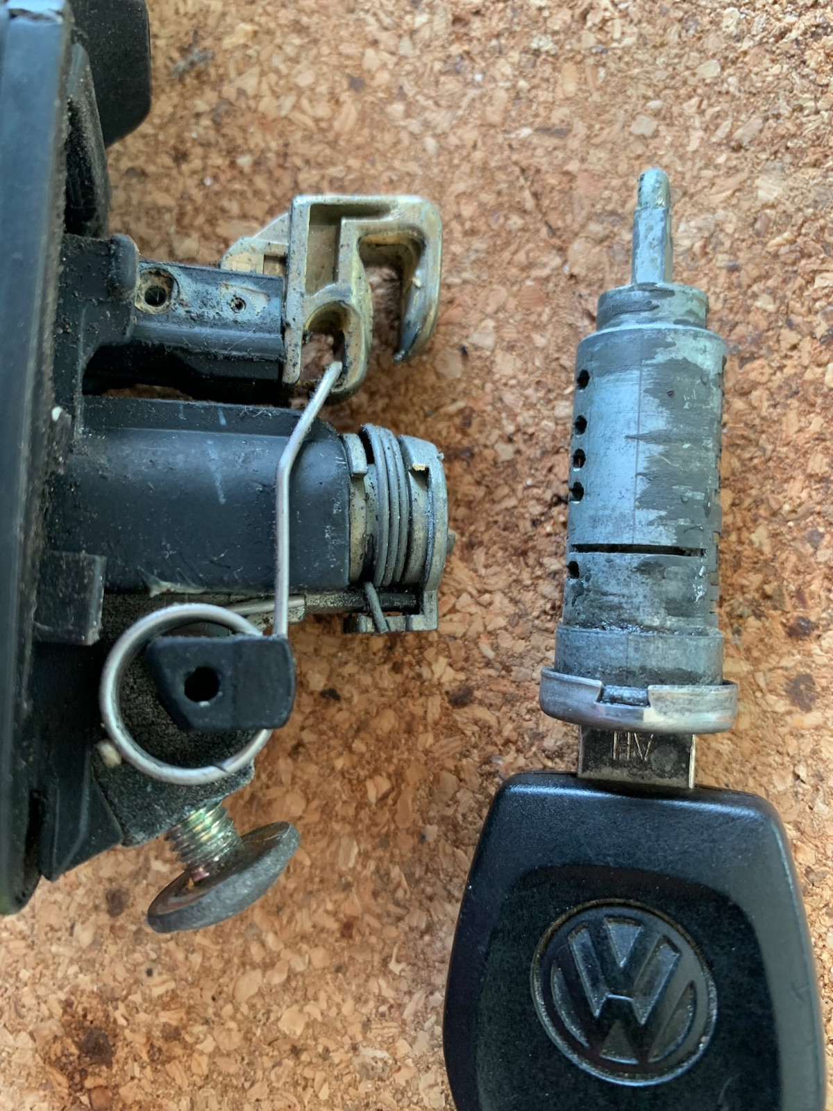

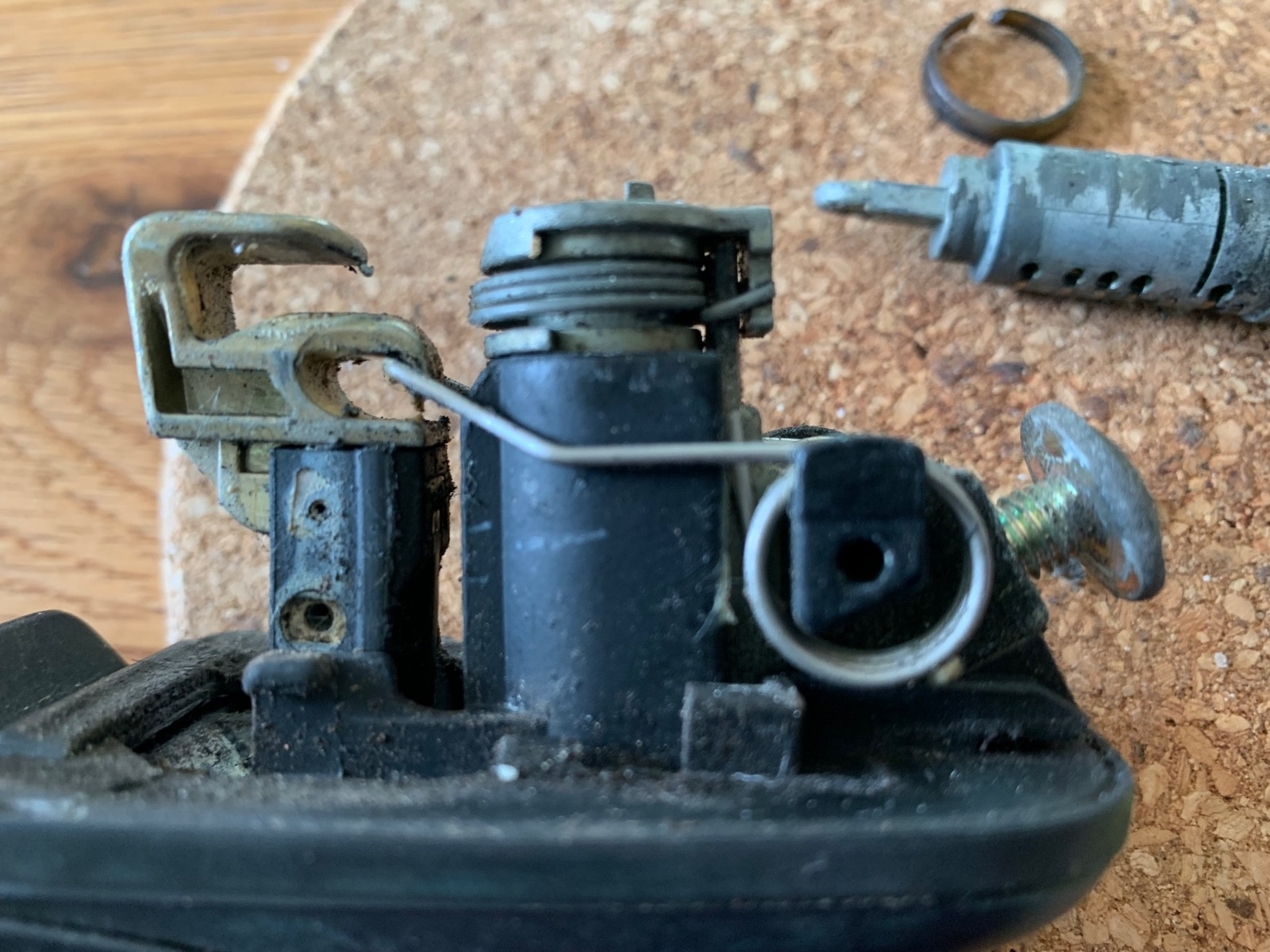

So had this precise problem - driver door lock spinning round, not activating central locking or lock cylinder. Read this. Viewed YouTube guides. Bought repair set off eBay for £3. Went to fix the door today.  Remove door handle but mechanism is different. There was a fragment of broken paddle (I assume) left in a little loop at the end of the cylinder lock, unsprung. No circlip to remove. And a broken plastic sealing ring.

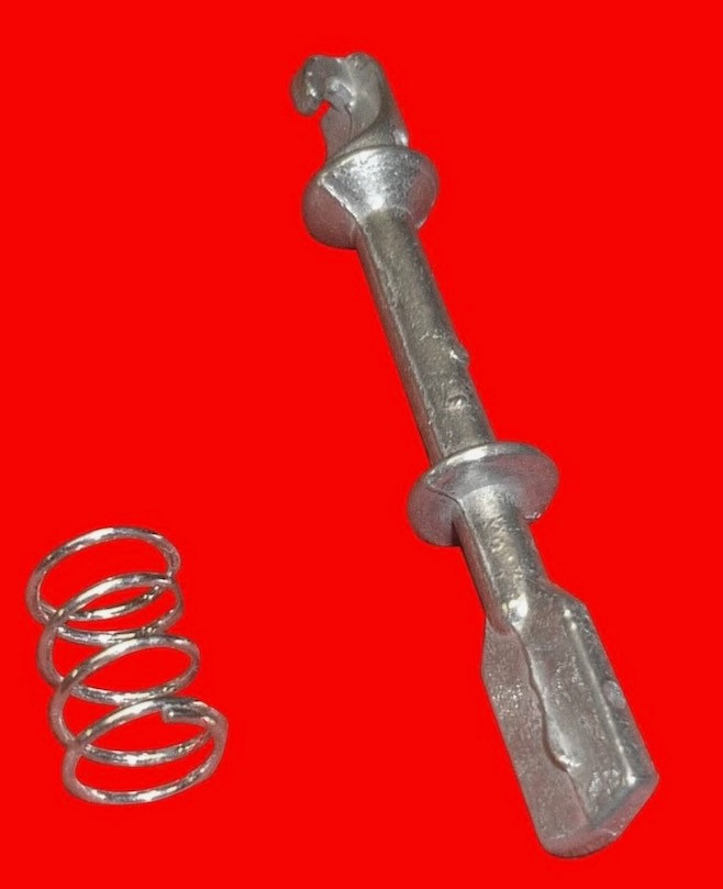

I probably need a little hooked type paddle and method for attaching it.
Can anyone help?
1996 N reg Polo 1.4 CL 3 door hatchback

I may have answered my own query, after a little eBay search, I came across what looks like the paddle part. I've bought one and assume it will only fit one way or the other!
https://www.ebay.co.uk/itm/165475710186
Photo attached in case the listing goes out of reacH
