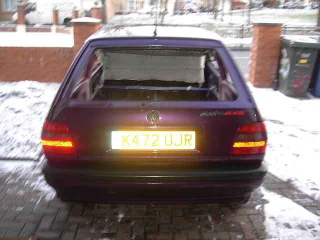

How did you get the sealed rear window out? And how does it go back in?
to remove= poke hole with kithen knife and feed wire throght hole (proper window wire) wrap wire round mole grips and move in out round the screen.
to fit-=i use stikoflex and a sealant gun

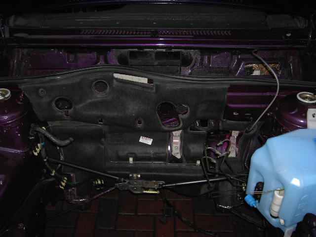

should buy it the rear bulkhead insulation for it its £40 new from vw and only fits LHDs would be a nice we touch.
bought and going in soon!!

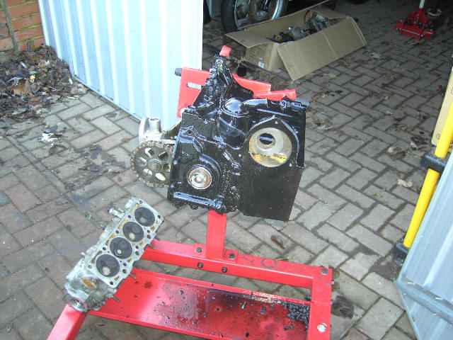

engine stripped down

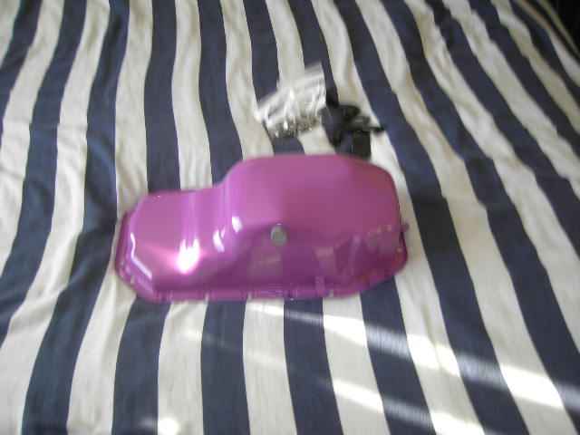

block painted,sump and petrol tank powdercoated purple
cylinder head and gearbox just took to powdercoaters
powder coating is addictive
oh thats a nice touch, keep the purpleness theme going.
Tank will look awsome that colour (need pic of it :nod: )
