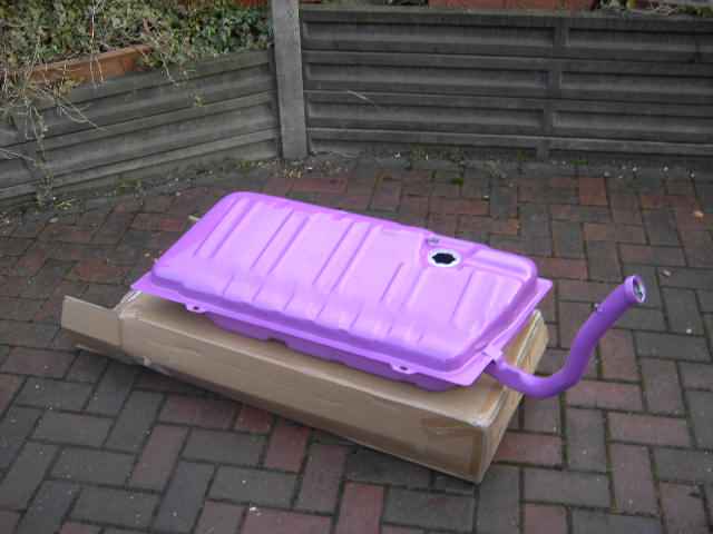

oh thats a nice touch, keep the purpleness theme going.
Tank will look awsome that colour (need pic of it :nod: )

simply awesome!
that tank will look nice once in place, brave move going for a bold colour it could have been hit or miss but think its a 100% win and it wont rust! yay.
I think that purple will contrast perfectly with the darker purple :) it'll look spot on... scary thing is, this is his "toy" not the one he's restoring!
Powder coating won't rust, but the metal underneath it will :lol: Hence no chassis components should be powdercoated as once it gets stone chipped, rust sets in, but the external finish is still solid in apperance.

be warned however that the powdercoat may get wrecked by the exhaust!!!
i got round this issue by using some heat shield from a big audi i got from the breakers yard and carefully sculpting it to the shape of the tank.
its a neat way of protecting your paint around this area. the original tank paint is quite heat resistant- my powder coated bits at the front of my car by the exhaust (chassis brace,gear selector etc) have been wrecked and some of the bits have gone to the chromers now.

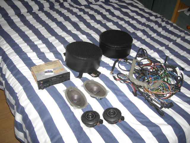

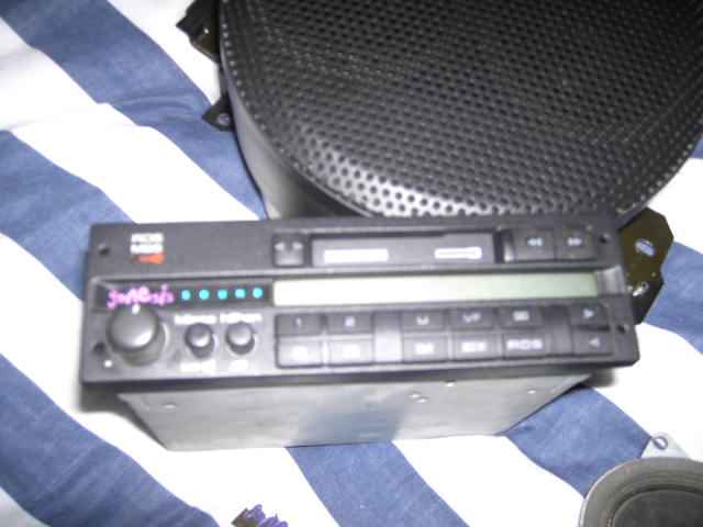

so did i got one complete kit so far
genesis stereo
genesis dash speakers
2 8" genesis subwoofer
complete wiring
2 shelf speakers
pics of sound system
I like!! :)
i want to touch it

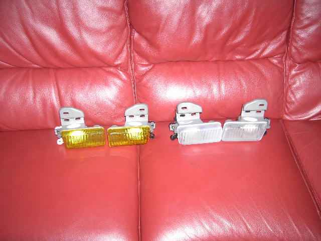

some opions please
rare yellow front fogs
clear front fogs
Yellow for the rareness.
the rarer lights with the rarer car of your collection?

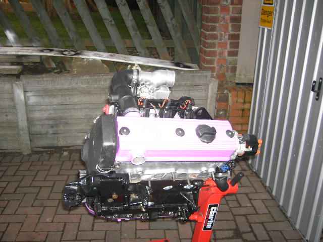

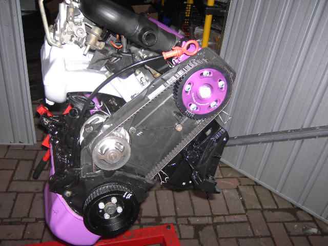

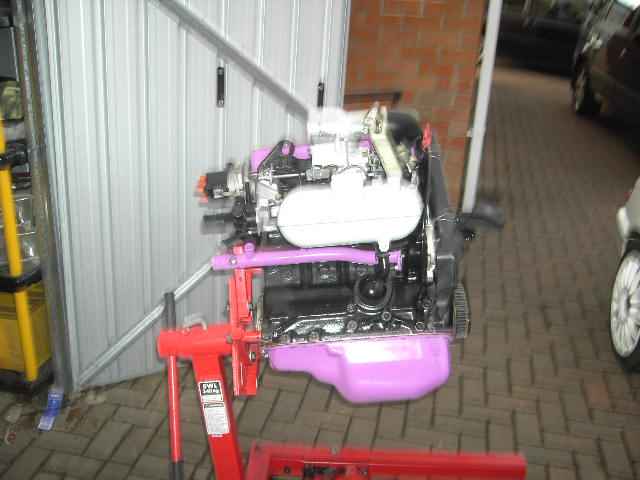

here pics of engine I've been doing in garage
beast, looks mint mate
I've just messed myself at the sight of this thread! awesome work matey !
Nice one, Chris!
oooo shes a beauty :)

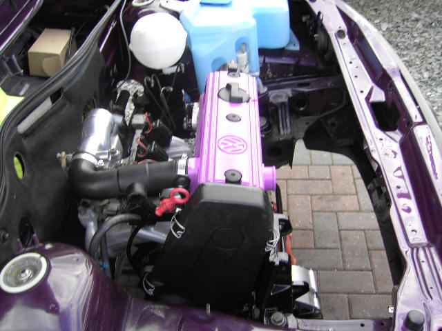

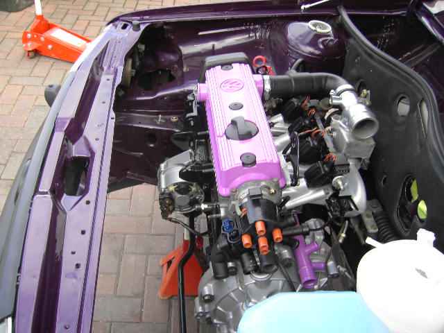

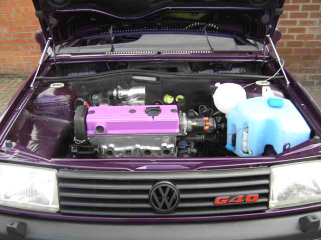

engine in place today
That looks coooool. Hats off to you mate!!
