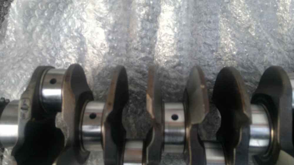

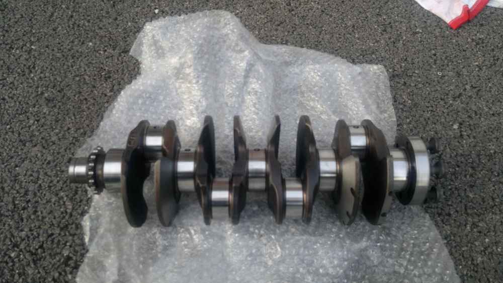

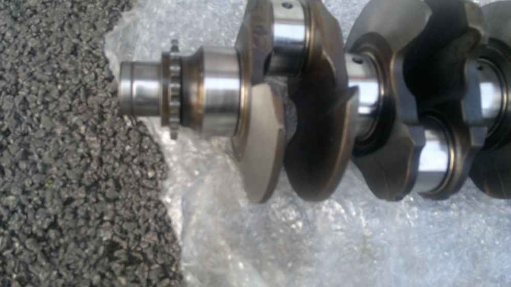

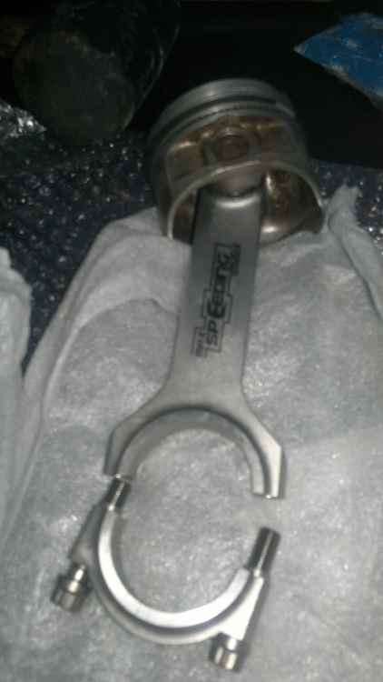

evener morer picatures off the stuff I'm hoarding waiting to do the engine conversion and other bits enjoy.

Lots of new shiny things and lots of other things that i shall paint before installing i'll update with more pictures of actual progress as soon as i can and more regularly now things are starting to happen.
Hope you all like it but if you don't i don't care lol.
